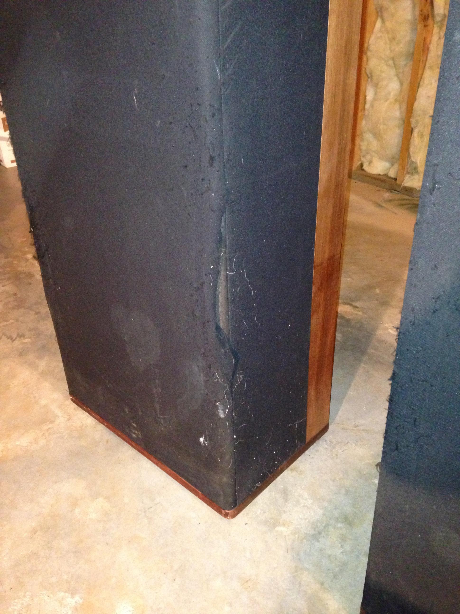

    You remember from page 1 that the previous owner had a pet lynx?
    Today, they are near mint condition like this:

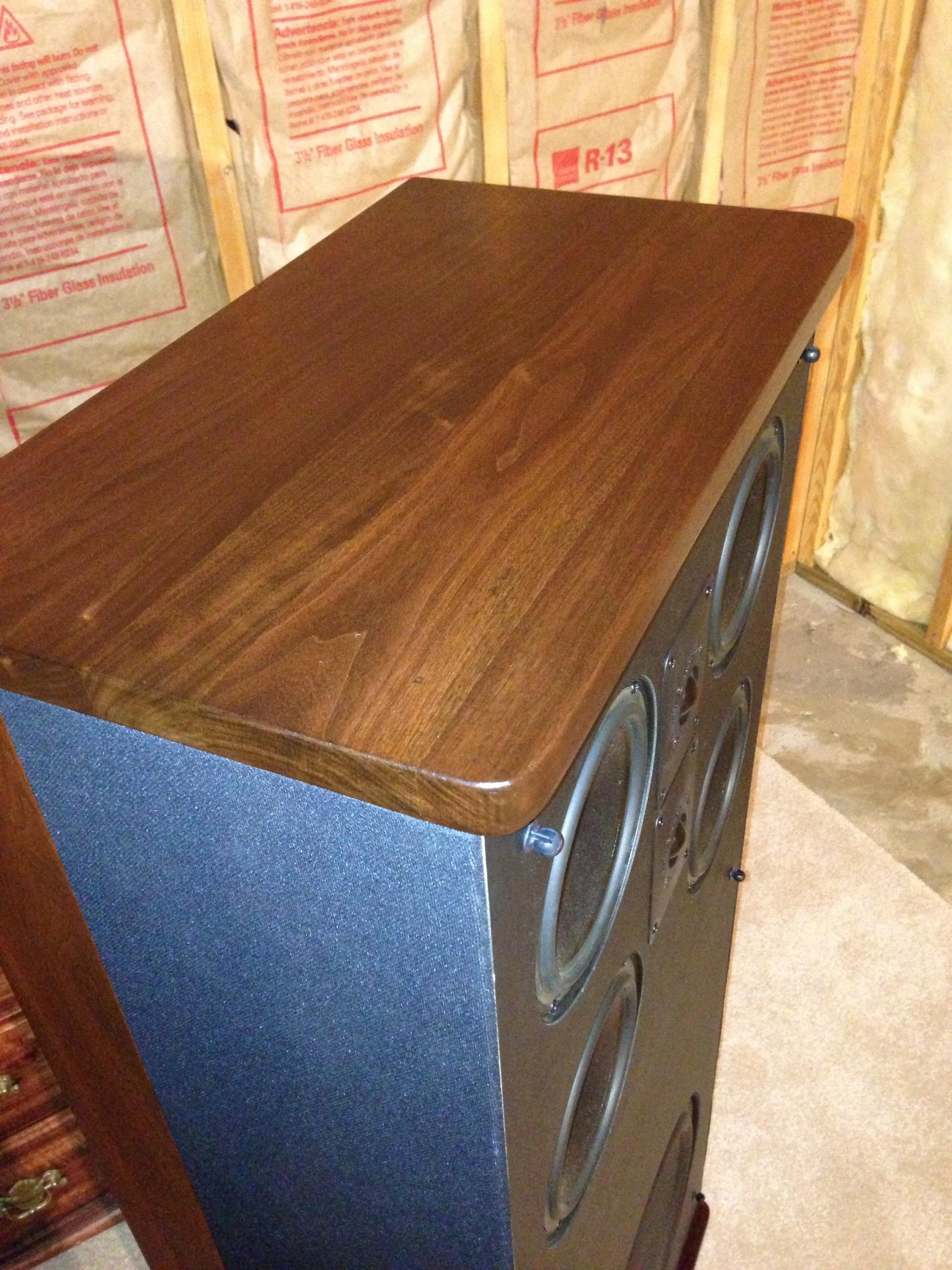

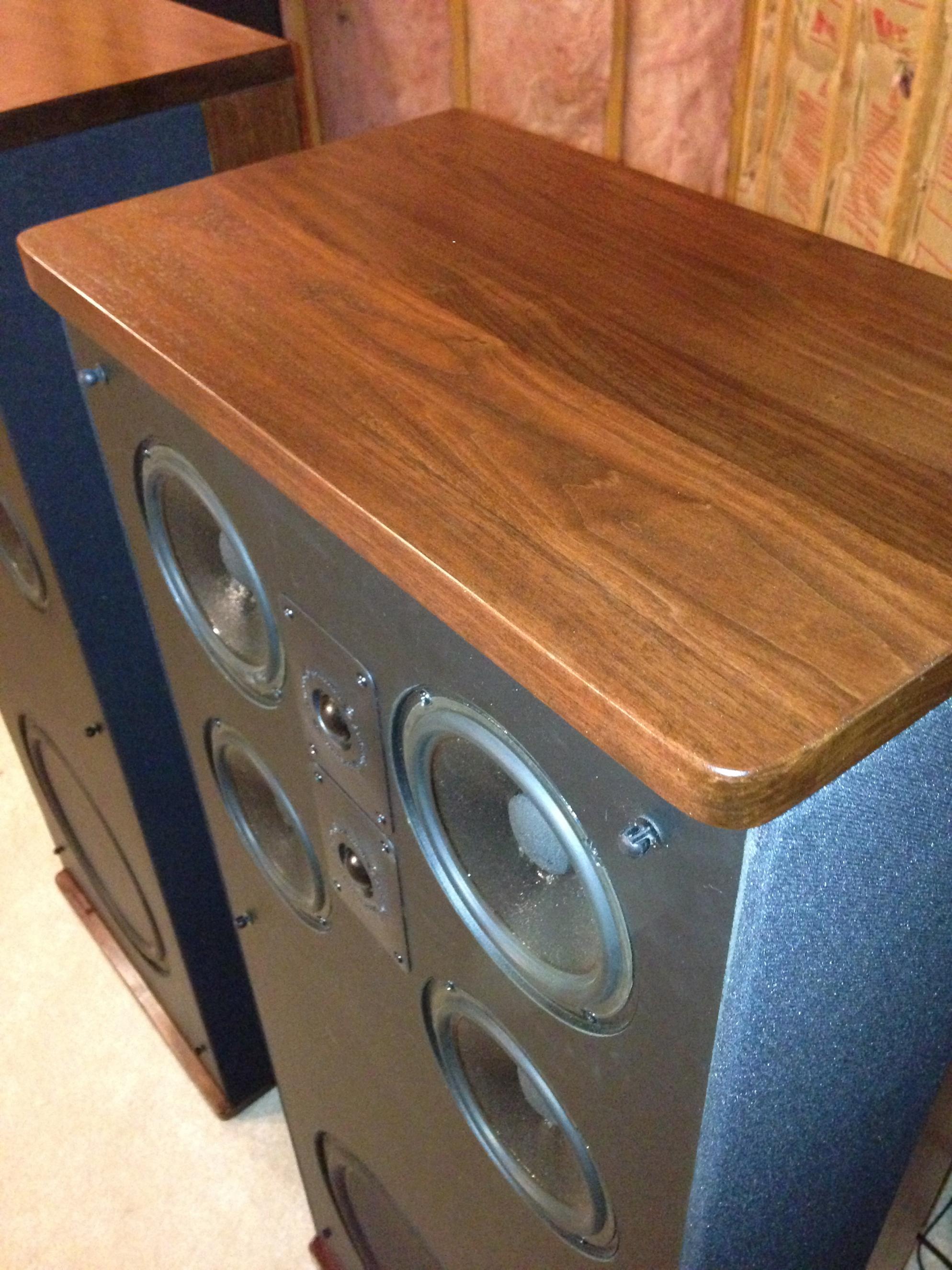

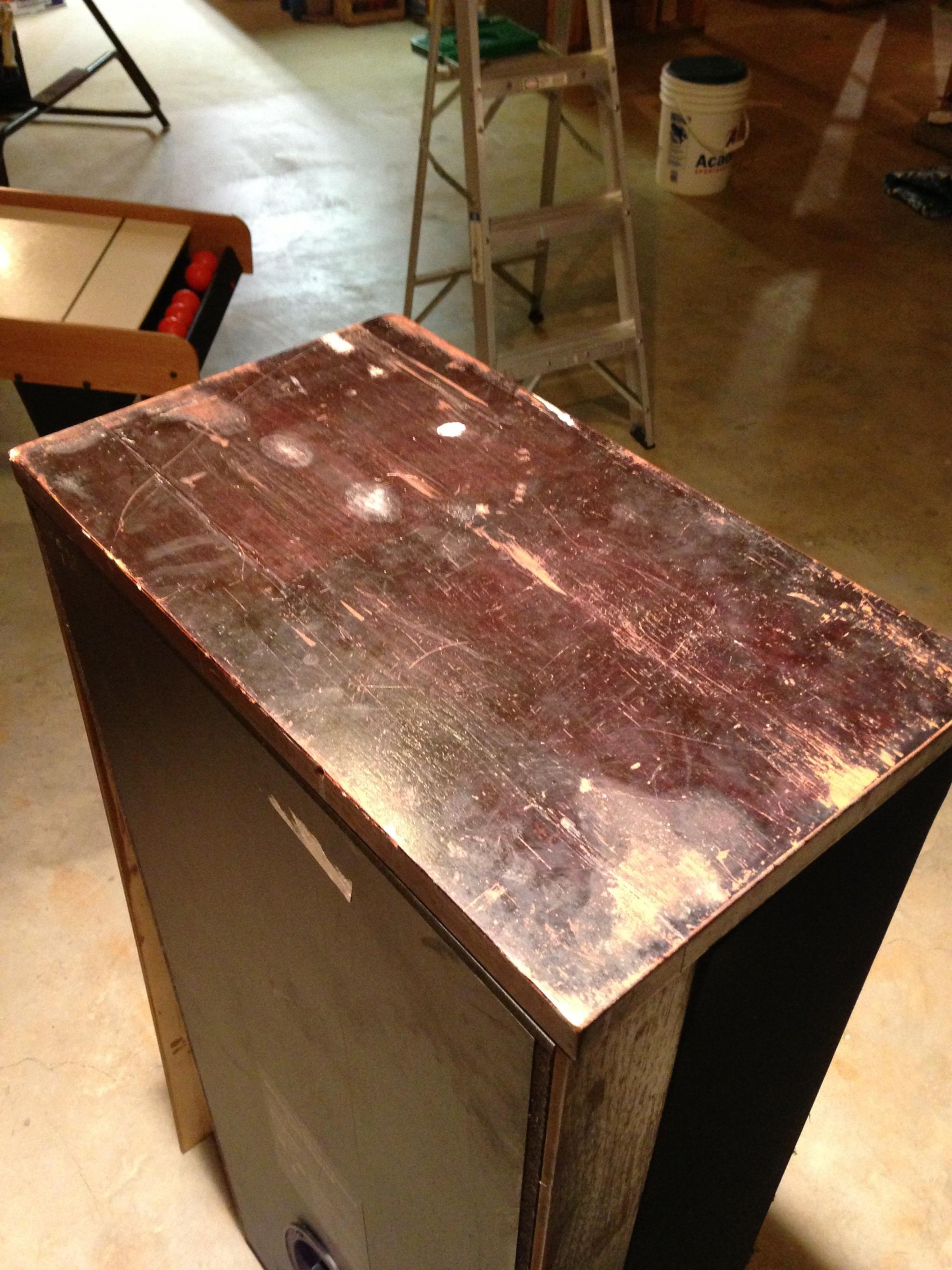

    In addition to turning his lynx loose on my SDA SRS2s, the previous owner was obviously a pipe fitter by trade and used the top of the speakers as a work bench and brazing/welding station.
    But after gluing splits, clamping, planing, sanding, staining, sanding, staining, sanding, poly, sanding, poly, and rubbing... they are now looking awesome:

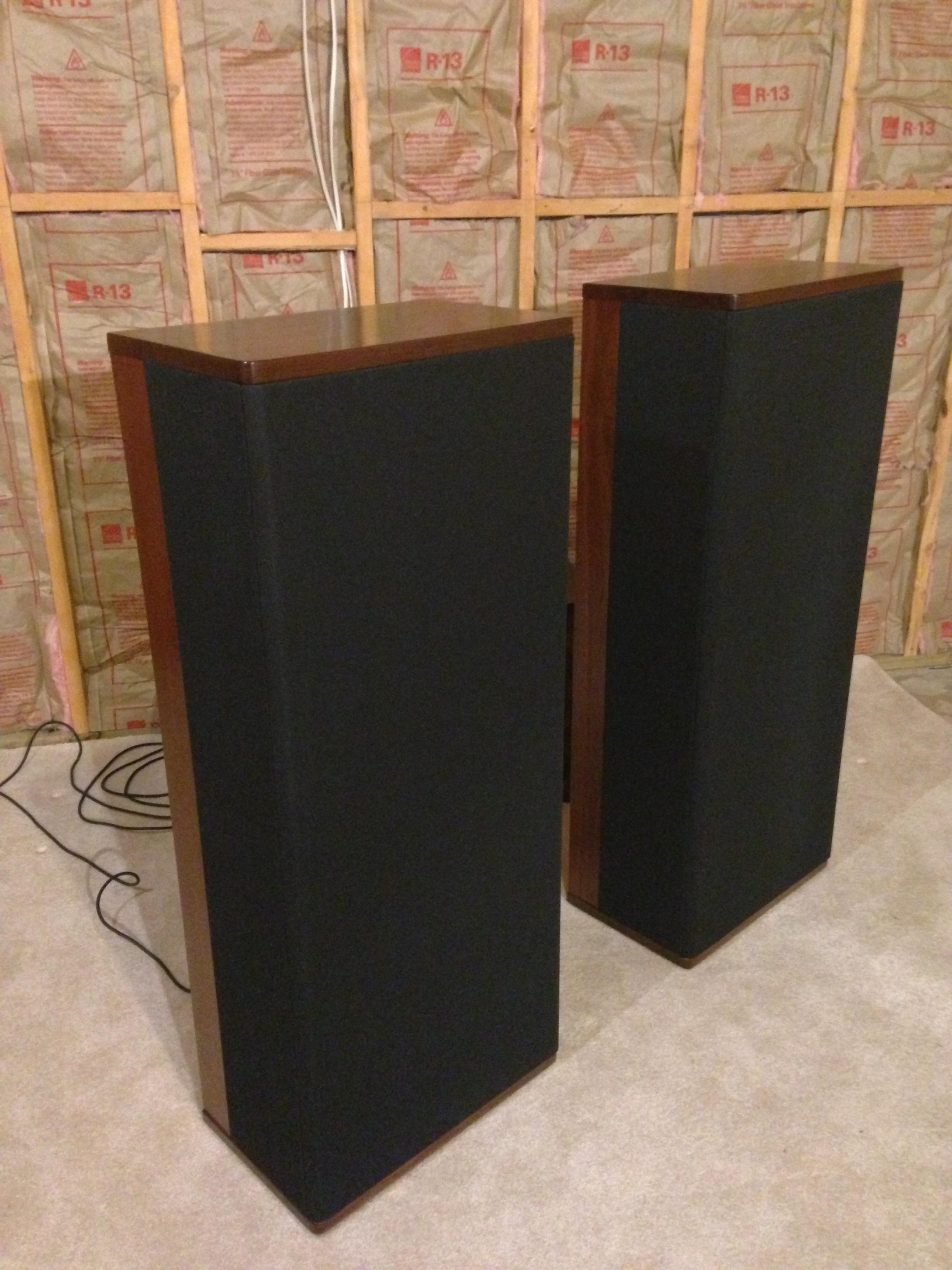

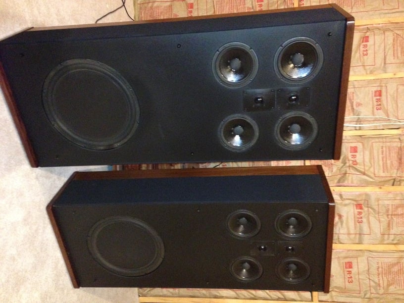

  • proffitt
    proffitt Posts: 157
    edited January 2013
    Here they are with their clothes off... ahhhh speaker ****!
    In addition to the exterior wood (tops, bottoms, & sides), new fabric (6 panels)....,
    I've also replaced the tweeters with new RDO198s.
    New armacell gaskets on all drivers and PRs.
    New Speakon Neutric connectors for Interconnect cable.
    New binding posts.
    Replaced all Caps with Daytons or Sonic Craft, all resistors with new Wills, and removed and jumpered the polyswitch.
    Dynamat treatment on all drivers and PRs.
    Repositioned and fluffed up the polyfil to a higher position in the cabinet.
    They sound incredible.
