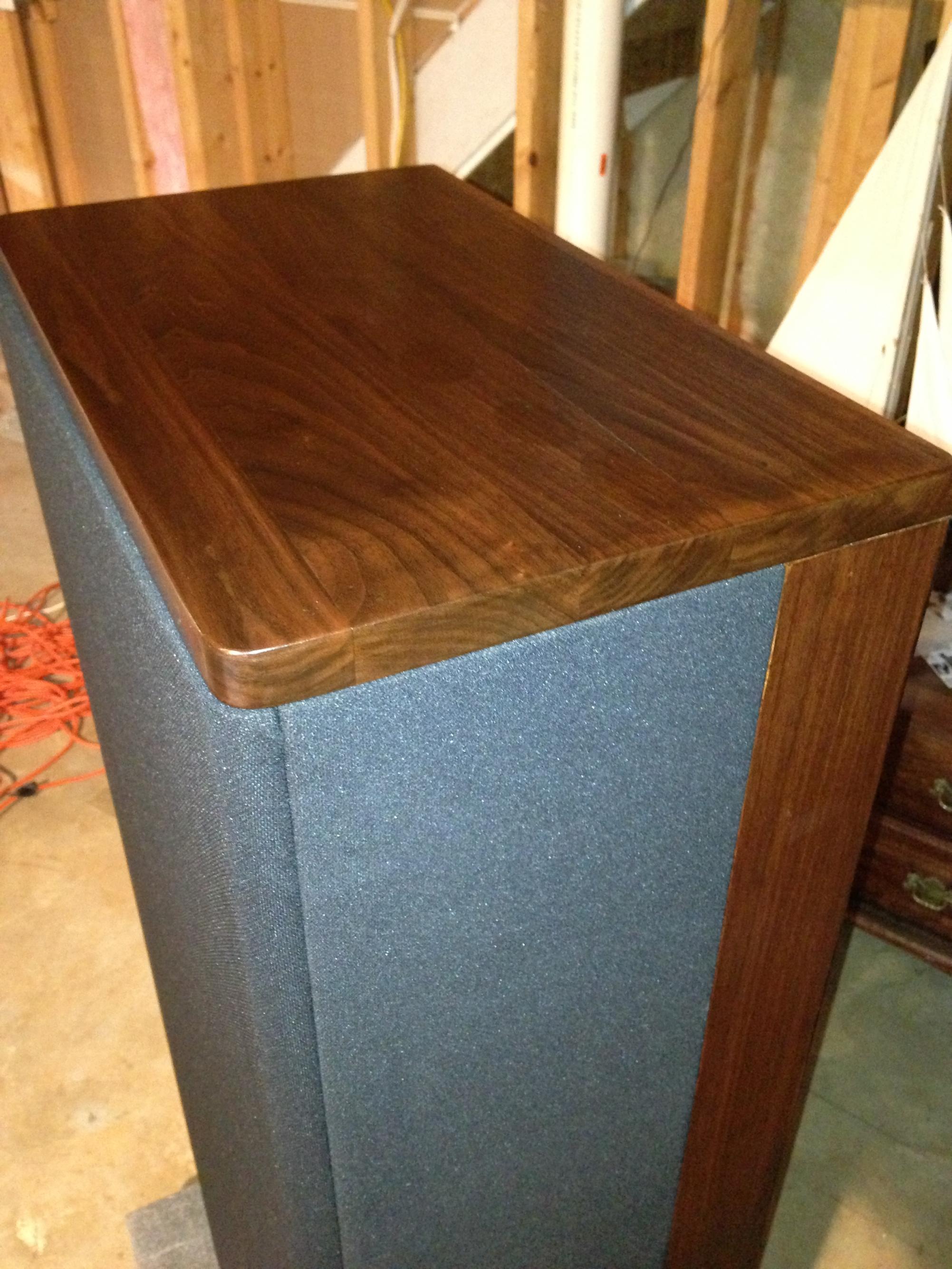

    UPDATE: The first one is finished. Take a look.
    Whew. That was certainly a labor of love, but i think it'll be worth it.
    When I first got them, the wife unit couldn't even believe I was bringing those nasty things in the house. But a full overhaul and she saw them last night and was floored. They still can't visit the living room, and are banished to the basement, but that's fully because of their size. I'll tell you what... the first one took a long while, but the second one is going very quickly.
    With the second one, I'm photo documenting and capturing everything and going to post here a "Layman's How-to". Coming soon.
    But the anxiety to hear these things has inspired me to go ahead and finish off the theater room in my unfinished basement, and has gotten spousal approval as well. For that too... I love my SDA SRS's, (and I've still never heard them).
    Two of my four new tweeters arrived damaged. The connector posts were broken off and rattling around in the bottom of the box. The "thread" filament looks too small to solder. I mean, it doesn't even look like wire, but very small thread. Any suggestions on DIY fix? Or back to Polk?

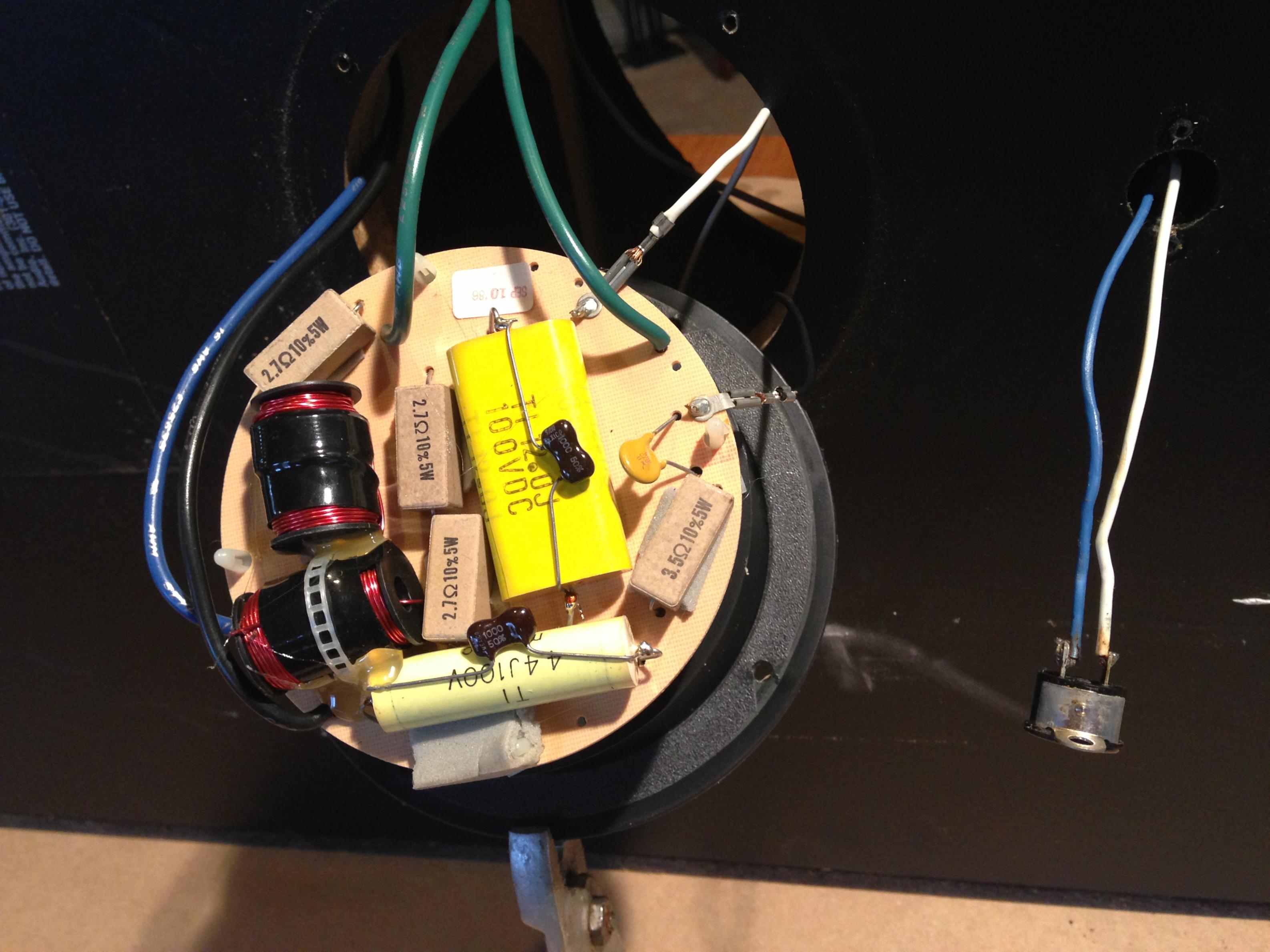

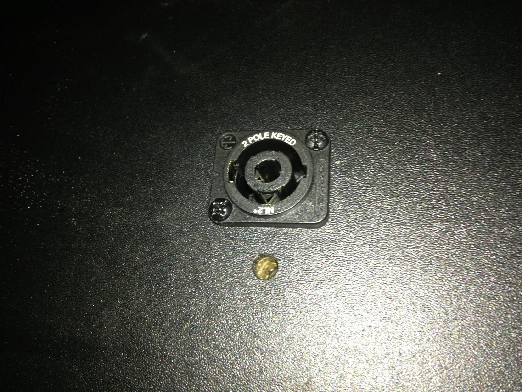

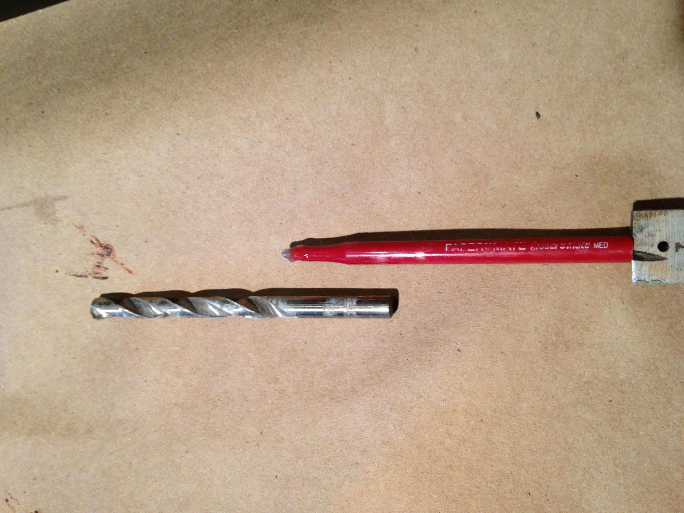

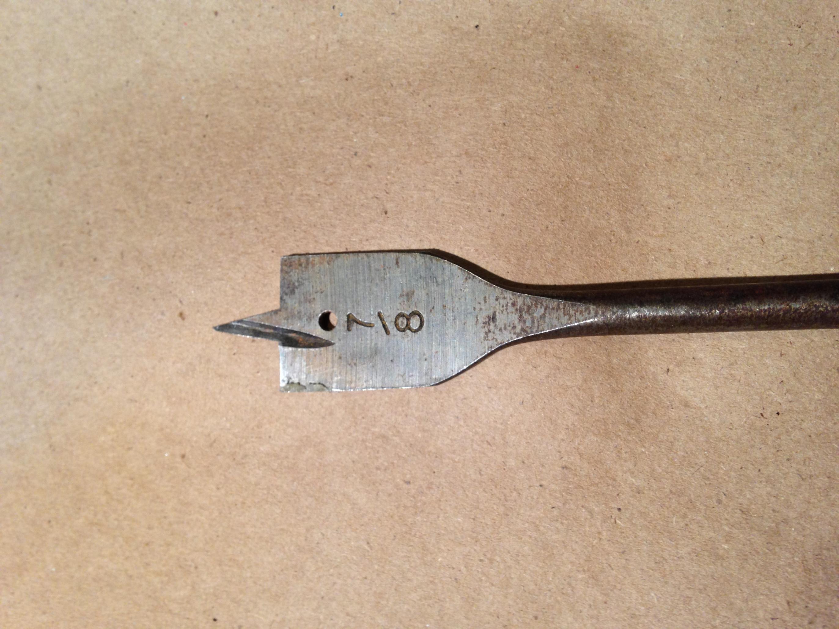

    OK... so starts the modifications to the second speaker. Of course I did all the wood and fabric panels at the same time. The wood and panels are waiting to be installed, and those are all pretty self explanatory especially from the previous posts.
    So I want to start here, and document for others, the mods, with pictures, with thanks to many here for enlightening me.
    First... I removed the drivers, tweeters, and PRs. Removed the binding post cup and the Interconnect (IC) port (mine was blade/blade). There's lots of glue on the inside of the IC connector, so you'll first disconnect the wires from the crossover on the inside, IDENTIFY THEM with tape!, and then unscrew the connector screws holding it in from the outside. You'll have to pry it up and then pull the wires through the glue one at a time. I replaced the IC connector because I didn't have the IC cable, and went with a Speakon cable with Neutrik connectors. Here it is coming out.
    Now, to replace, most likely the connector you choose will be a greater diameter than the hole left by the factory original IC. Drill it out larger, but here's the problem...a hole drill or spade bit will not stay centered trying to enlarge an already existing hole. And you don't want to drill from the inside as it will break and magle the edges when it exits the side we want to keep clean.

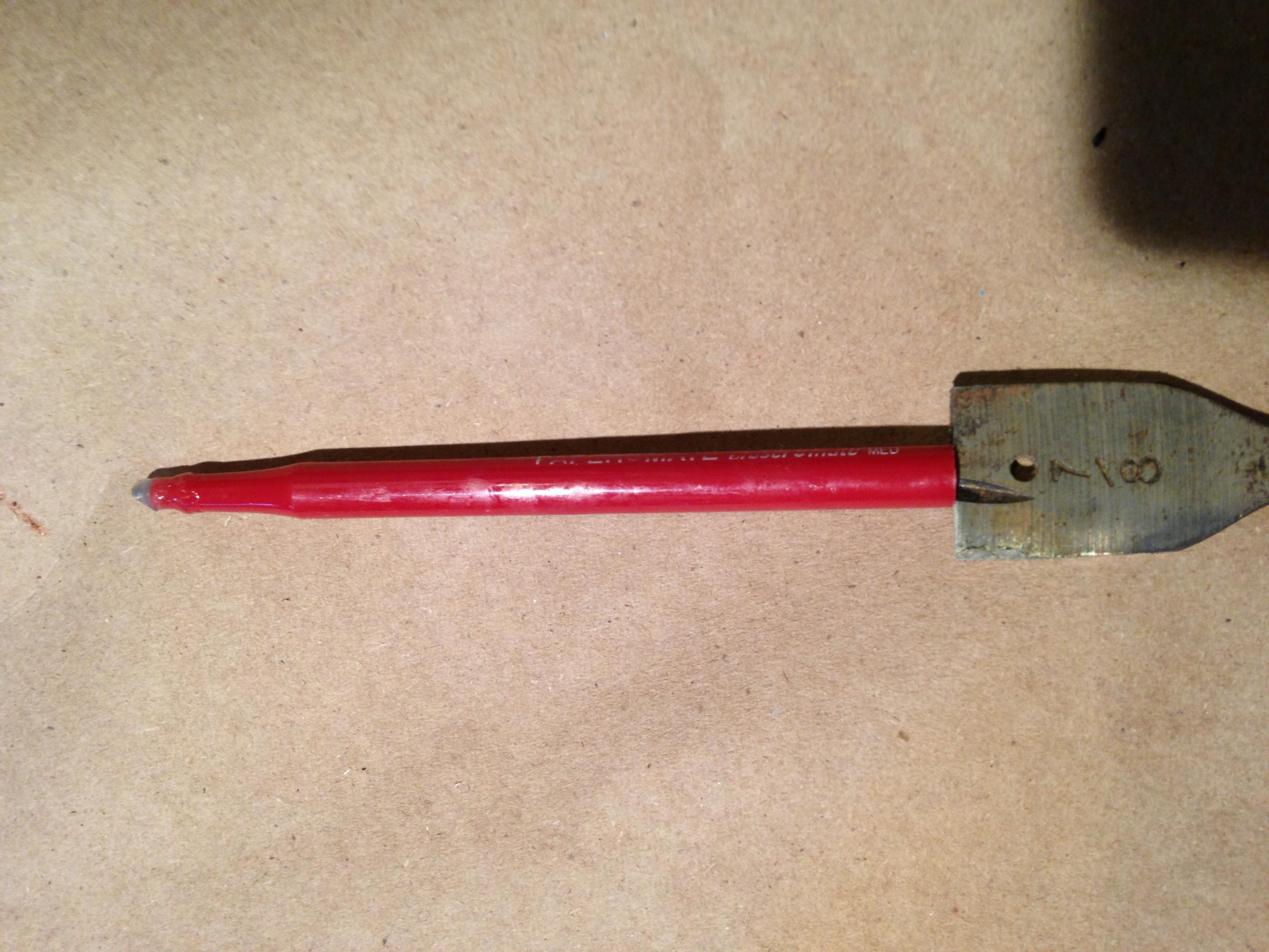

    So here's what I did. Get your spade bit, and find a pen or something that the inside diameter is the same as the point of the spade. Then find a standard drill bit the same size as the pen. Drill the center of the IC hole with the drill bit. Doesn't have to be exactly centered, but close. But it needs to be a tight fit. Then hammer in the pen into the hole you drilled. This pen will give you a stable hole to keep the spade bit stable.
    I'm sure there is a tool for this, but if I don't have one, half of you won't either, so this will work at midnight when you don't have exactly what you need.
    More to come.
    New IC connector. I used clear silicone sealant instead of hot glue on this, in case i ever had to remove it again. sealant to make sure there are no air leaks. Sealant in the hole, and then built up just a little on the inside.

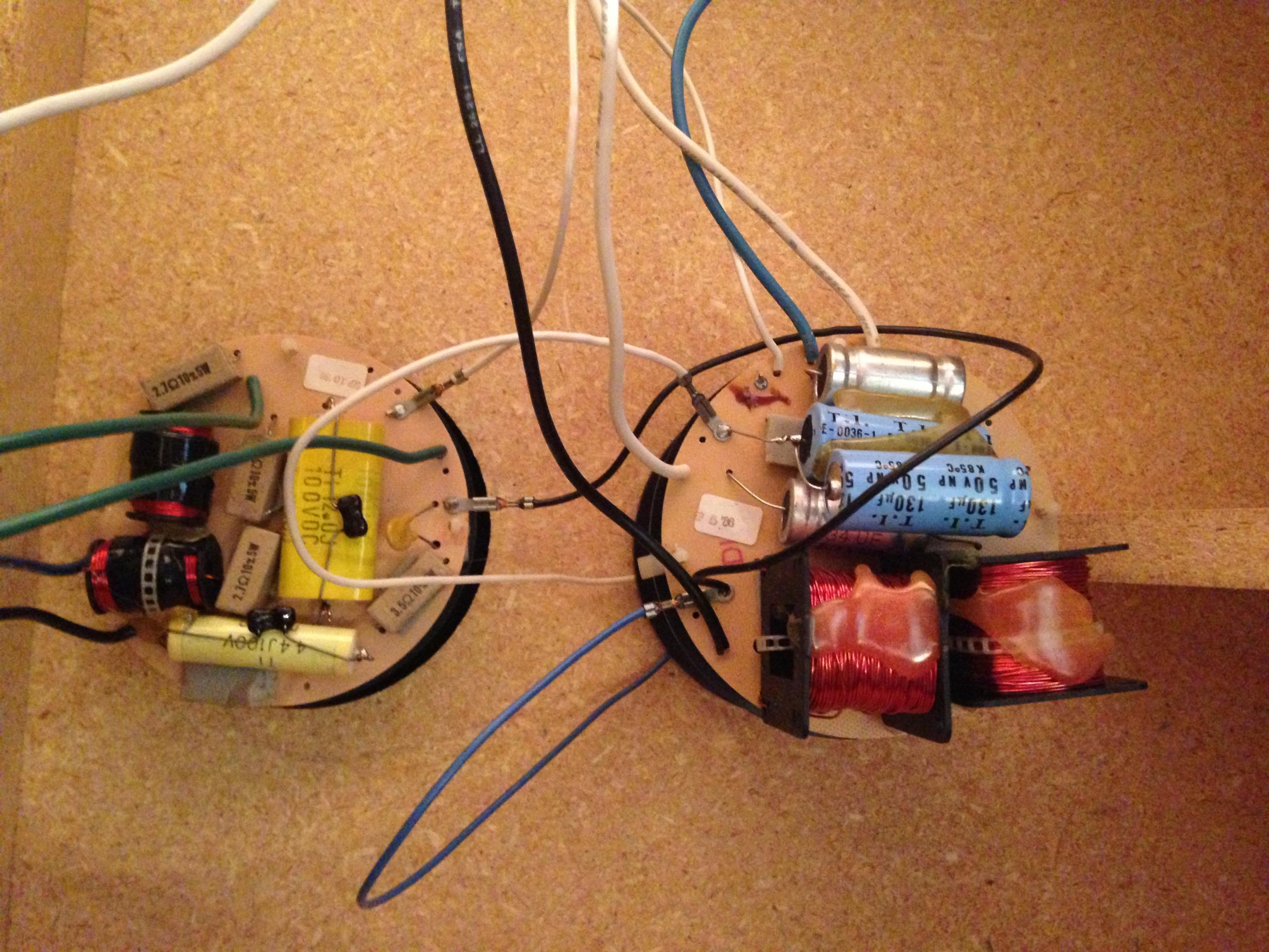

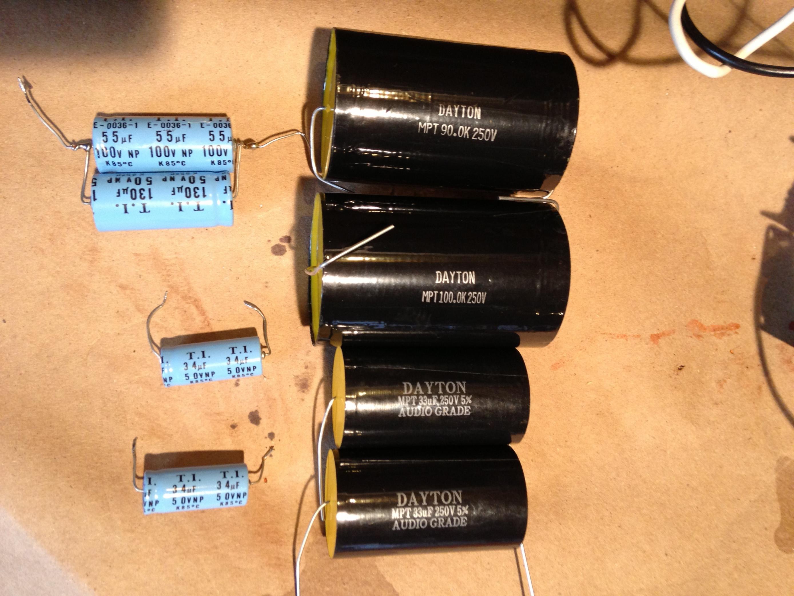

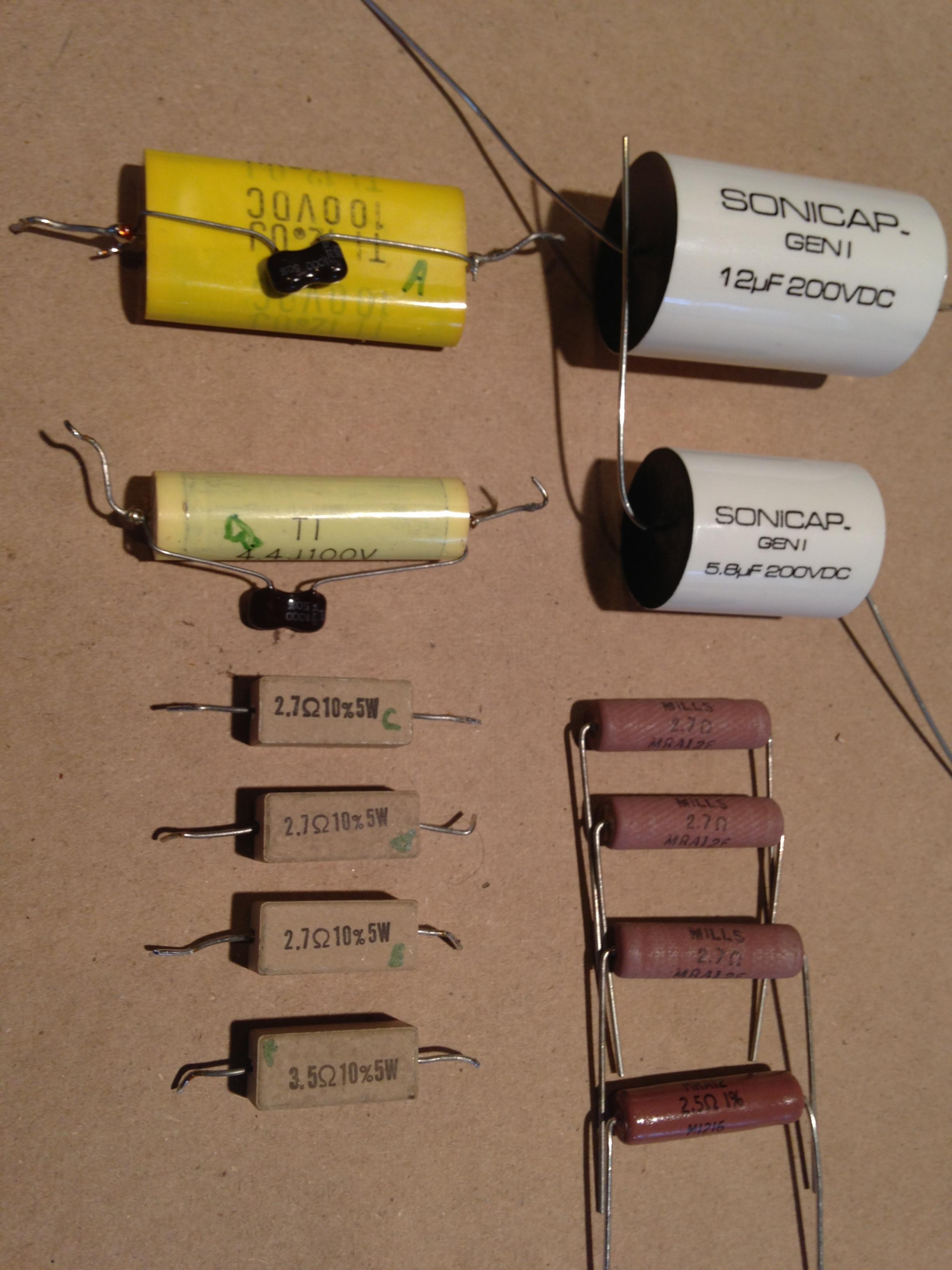

    Here's the part that I think would have helped me the most. Everybody here has been a HUGE help. But let me take from that, build on it, and help the next nube just a little too.
    Here is the hi and lo before mods:
    Here are the old components that have been removed (left), compared to new components (right) they replace, before they go on. This first picture is the high crossover:
    for the high crossover, its pretty easy, just mark the solder pin hole on the circuit board, on each end of the component. I lettered each component A, B, C, etc. Then lettered the two corresponding holes for each component. A and A, B and B, C and C....and its pretty easy. The very last component on the image, is a 3.5 ohm resistor on the old version. I was given a list of components to buy and was real confused that i had way too many components. The list it turns out, was to give me options on what to replace this 3.5 resistor with. After reading what much smarter people than i opined... i decided to try the 2.5 ohm resistor here to start with. Who knows if I'll ever change it, but i know i could.
    And the same for the low crossover, old left... new right.
