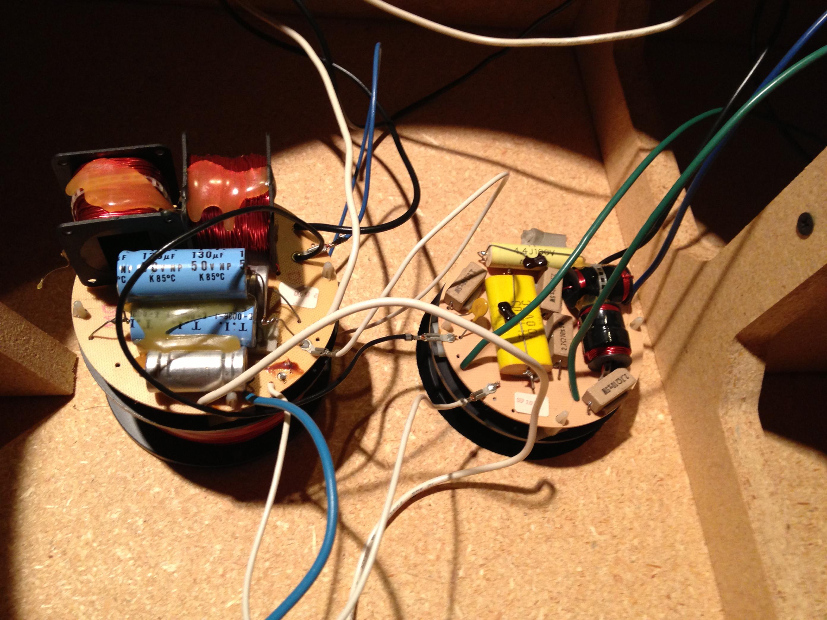

    ok, I've gotten alot of work done today. all stripping and sanding done. All staining done. Wiped down residual and drying tonight before some poly is going to make it really pop. Its looking great! Pics to come after poly. But in the meantime... the next step.
    All of my components are in, caps, resistors... I'm going to have to reach out to the group for more help on the next round of tasks. Its time to mod the crossovers. I've looked at all of the online guides and instructions, and found that most of the work modding the crossovers is done on rectangular boards. Mine are all round.
    So this is my setup here. I need some guidance on what component that I've ordered replaces what component on the board(s). Is there a document that covers my model of the round shaped pcb and details what replaces what?
    Thanks for any guidance.

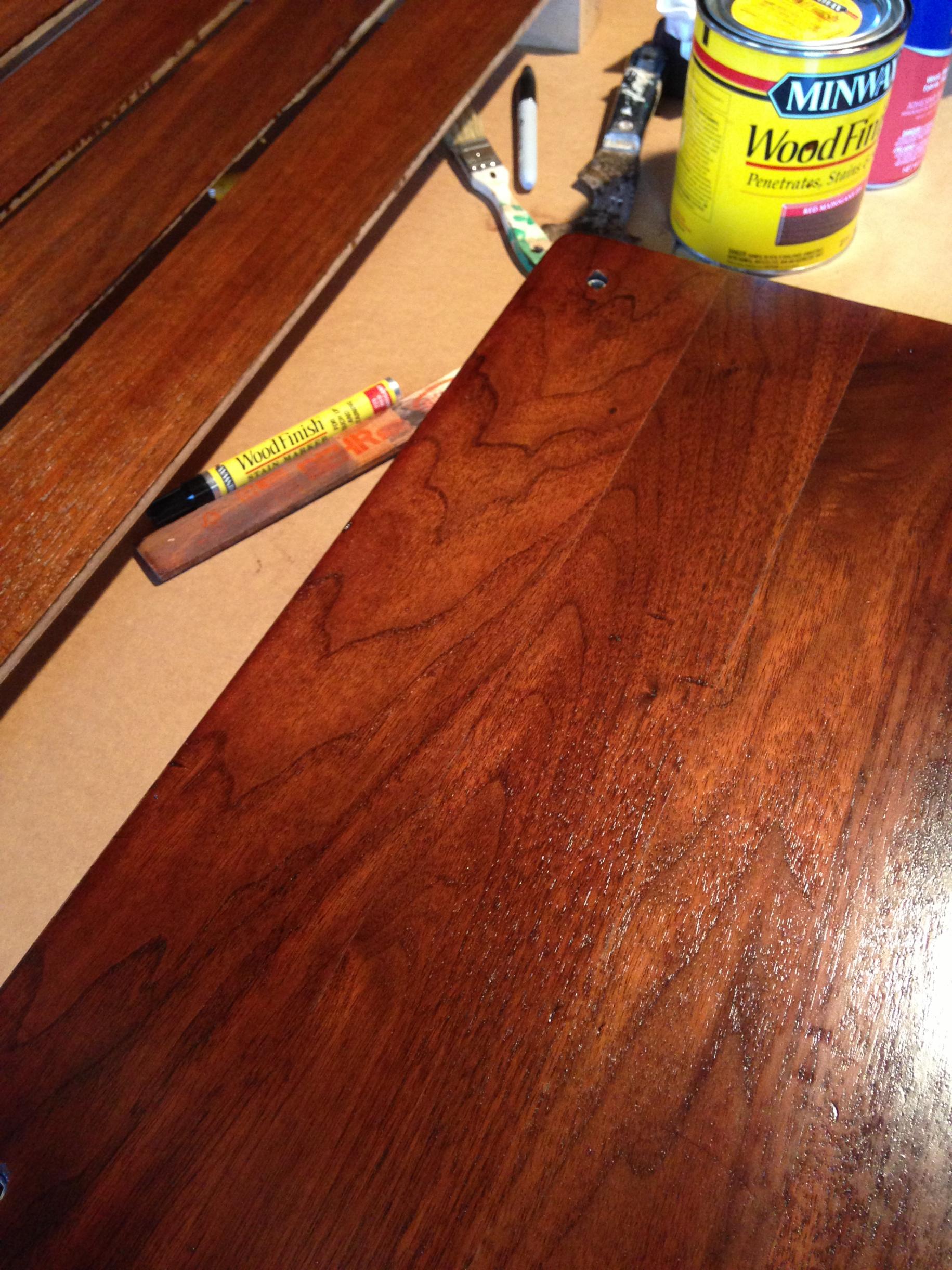

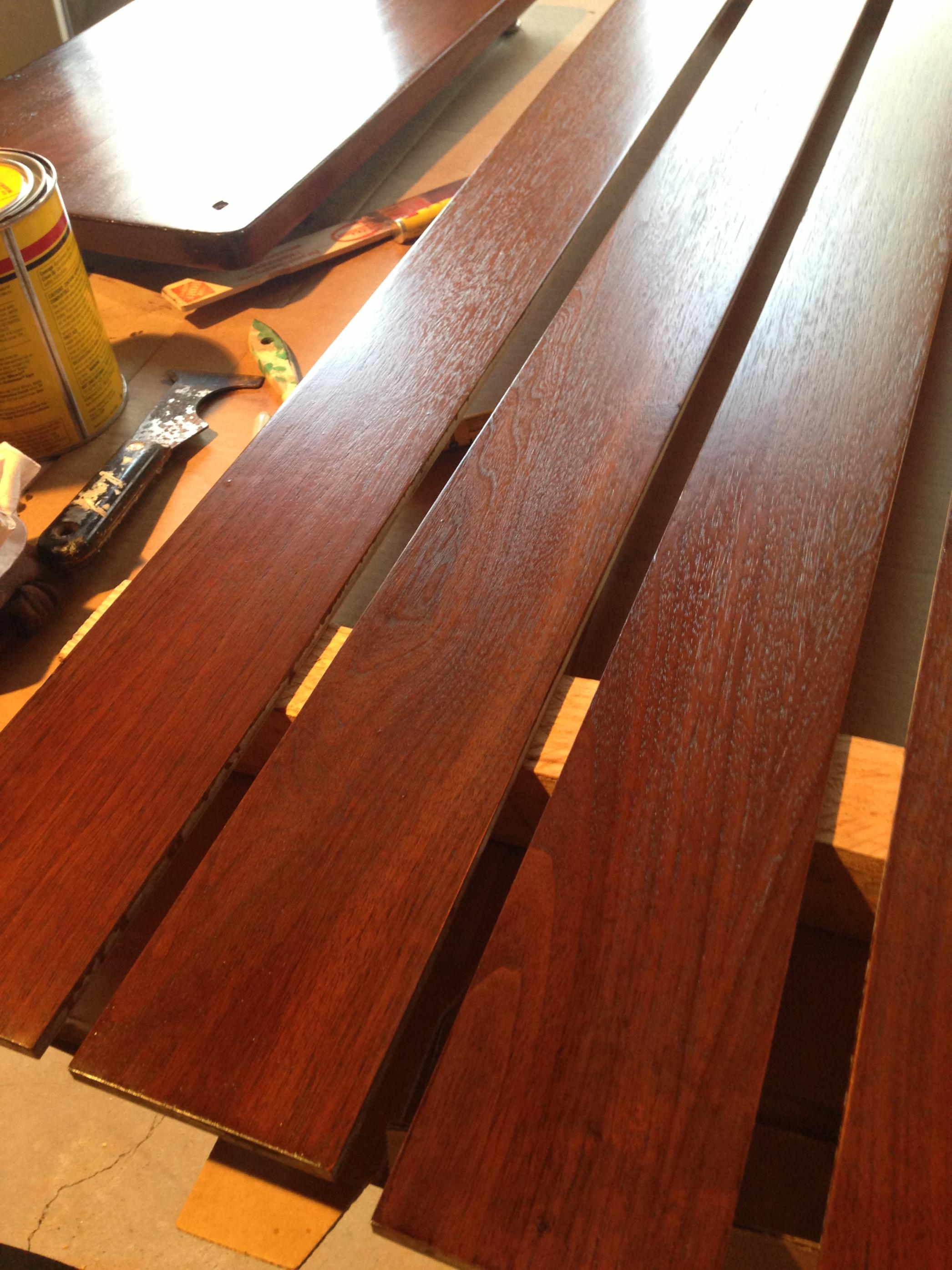

    Side slats pieces and wood bottoms are done. The wood tops are still at a friend's getting planed down. Electronics mods coming next.

    ok. This seems like a really elementary question on the electrical side but its stumped me. better safe than sorry. First thing I'm doing is making the interconnect mod. I've removed the blade/blade connector. I've drilled out the hole to 7/8th inch to fit the neu Neutrik connector. The schematic shows me that from the original connector, the pin #1 is the wide blade and is where the white wire is connected. Pin #2 is the narrow blade and is where the black wire is connected. It appears that the schematic key is showing that A equals pin #2, is black... and is positive. And that B equals pin #1, is white and is negative. Really? Black is positive and white is negative? What am i missing? The blades on the neu Neutrik connector are labeled positive and negative and I'm about to solder.

    Thanks very much Pitdogg. Yes, feeling over my head on this part. If i just knew what old component was replaced with what new component....
    Shurkey did a good job of showing me in post #7 above, that the two blue caps (130 uF and 34 uF) are replaced by the new caps (Erse 91 uF and Dayton 33 uF, respectively). That i can do, no problem. But with the rest, I don't know what old components come off, and what replaces them. If i knew that, I'd know where to solder and what to do.
    If there was a "old to new" line item list....

    Those 4 rectangular components are resistors, and yes you will replace those with higher quality ones. They have a big effect on the highs.
    The small round disc looks like the polyswitch. Most here replace it with a 0.5 watt resistor, but a word of warning. If you do this you must use high quality amplification and not overdrive it. If you do you could blow your tweeter(s). I've never had issues and I can play my SDA's loud enough to drive people from the room.
    The dark yellow and light yellow components with the little brown things sitting on top are capacitors. You'll replace the big yellow ones with new film caps, and throw away the little brown ones. They're bypass caps and are unnecessary when you use high quality film caps.
    See, all that stuff is easy. The main thing is to go slow and don't forge ahead until you're sure what you're doing. And if you're not sure ask here on the forum. Lots of knowledgeable folks that are willing to help.

    ou guys are alot of help and I'm so close i can taste it. Tops came back from planing today, and got their final sanding and first coat of stain. Look great.
    I think i have a good grasp of the low freq boards. The pictures helped alot Schurkey and helipilotdoug. Thanks very much! I'm ready to make these mods to the low boards.
    I'm still a bit confused on the high freq boards though. Maybe a little more help will put me in line.
    Helidoug... I see on your pics that there seem to be 3 replacement Mills resistors with 2.7 ohm. Is there a 4th one that i can't see? my original board had 4 rectangular resistors, 3 of which are 2.7ohm, and one which is 3.5 ohm. If there is one i can't see, what value is it? If there are only three, which one did you not replace? and did you jumper the void, or just leave it unpopulated?
    Schurkey... I'm realizing that there are different approaches to components to choose for replacement. It never was a set list of replacement components, and "to each their own" on what to choose and what route to go. I appreciate your input and helping get me there. From what i can tell, i think i got the best quality and am happy i stumbled into your good advice. I am confused on one matter though, and i fear i might be missing something. For the high boards, here's what we/I decided on ordering:
    Highs:
    8 Mills resistors 2.7 ohm
    2 Mills resistors 1.5 ohm
    2 Mills resistors ~1.75 ohm if available
    2 Mills resistors 2.0 ohm
    2 Mills resistors 2.5 ohm
    2 Sonicaps 5.8uF
    2 12uF
    Its the resistors that have me confused. There are 4 original resistors on the board, as detailed above. Looks like (depending on feedback from my first question) I'll be using either 3 or 4 new resistors per speaker, or 6-8 total. What are the other 8 new resistors for? What's worrying me is that there's something I'm not seeing under one of the big caps or something.
    Final question (for this evening!)... it appears that the yellow disk component is the polyswitch. I've read in one place that it should just be removed. Another read says to jumper a straight wire to the pads where the poly came from. And another piece of advice is to replace the poly with a resistor of some un-remembered value. Any consensus on this from the group? I'll not be cranking the volume to destructive levels, and I'll be using a quality, powerful amp. And if the worst that can happen i can blow a tweeter or two, i know where to get two more. Advice?
    Thanks ALL!!!!!

  • Schurkey
    Schurkey Posts: 2,122
    edited November 2012
    proffitt wrote: »
    Highs:
    2 Sonicaps 5.8uF
    2 12uF
    Replace the three 2.7 ohm resistors on each HF board with 2.7 ohm resistors. 6 2.7 ohm resistors total.
    Replace the single 3.5 ohm resistor per board with WHATEVER SOUNDS BEST IN YOUR SYSTEM. Mark the location of that 3.5 ohm resistor, and do some "experimenting". That single resistor--the 3.5 ohm unit--is the single electrical difference between the SRS 2 B/B and the SDA 1B. The 1B comes with a 2.0 ohm resistor instead of a 3.5 in that position. I wish I'd have installed a 1.5 or 1.75 ohm in place of the 2 ohm in my system.
    inspiredsports appeared to sanction 1.5--1.75 ohm resistors in that location; but in the end went with another 2.7 ohm, four total per board. He didn't give any reasoning behind his change-of-mind.
    You are left with some options:
    Install a 3.5 ohm resistor where the original 3.5 ohm units were--one per HF crossover. inspiredsports and I agree that 3.5 is too damn much, and the treble is not loud enough. This is why I didn't encourage you to buy 3.5 ohm resistors. You could ignore us both, in favor of the original engineering done by Matthew Himself.
    Install a 2.7 ohm resistor in place of the 3.5 ohm, as inspiredsports has done with his SRS 2 B/B speakers, having conducted considerable testing and evaluation. As I recall, he DID NOT install a .5 ohm resistor to compensate for the resistance of the polyswitch.
    Repeat inspiredsports listening tests, select the resistor value from the "extras" you bought, that sounds/measures best in your room. Solder-in the 2.7 where the 3.5 used to be. If you're in heaven when you listen, you're done. If the treble sounds feeble after some time to get used to the new, improved SRS 2 B/B, remove the 2.7 ohm resistor from the position originally occupied by the 3.5, and stuff in the 2.5 or the 2.0 instead. Listen awhile. Repeat if needed with a lower-value resistor, until the treble sounds/measures balanced to the mids/lows to you, in your room with your ears/measuring equipment.
    "I" think you'll end up with 2 ohms or less, where the 3.5 ohm resistor is now. But that's me, and I don't have an EE degree.
    You'll therefore have some extra resistors when you finish.
    If you don't use the two 1.5 and the two 1.75 ohm resistors, I'll buy them from you. The 2-ohm resistors on my circuit boards are going to disappear when I get around to soldering-in the replacement SDA inductors this winter.

    You cannot leave the polyswitch space void. The tweeters will not function.
    You can install a dedicated jumper wire across the polyswitch solder-joints. Some folks do this by giving the polyswitch a half-turn or more, and then tacking a touch of solder to the lead wires where they cross. Doing this shorts out the polyswitch so it is no longer effective. The polyswitch leads become the jumper. Another option is to remove the polyswitch completely, clip one lead, bend that lead so it bridges the two solder points, and then solder the clipped-off wire into place.
    You can install the input lead for the resistor into the input solder-joint for the polyswitch, and the output lead for the resistor into the output solder joint for the resistor--the resistor bridges the remaining two solder joints. Those two solder joints aren't filled, and cannot degrade the signal. I like this better.
  • proffitt
    proffitt Posts: 157
    hey guys.. the crossover electronic mods are going fine.... slow but fine. Quick question- none of these caps are directional or polarized are they? They can install either direction in the circuit, correct? Thanks!
  • PolkieMan
    PolkieMan Posts: 2,446
    Yes the caps and resistors can go either way along with the inductors
    proffitt wrote: »
  • helipilotdoug
    helipilotdoug Posts: 1,230
    Schurkey wrote: »
    Pretty sure he removed it and did not install a replacement.
    Yes.this is correct. There was a jumper installed in place of the poly switch.

    Hi All. I'll get new pics up soon. One speaker electronically complete. reinstall next and I don't think my low crossover is going to fit back in without the passive radiator hitting it. Think I'll have to remove the two largest caps and mount in the cabinet on the vertical brace like I saw a pic somewhere that someone did. With all your help the mods we relatively easy.
    I'm thinking of temporarily leaving one speaker unmodded. You might recall, I've never listened to these speakers before. I'd kind of like to hear the difference. And then mod the other one. That brings me to the need of an external amp.
