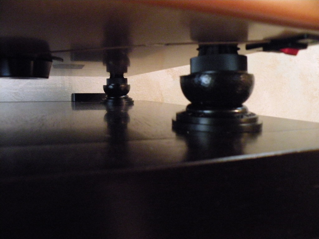

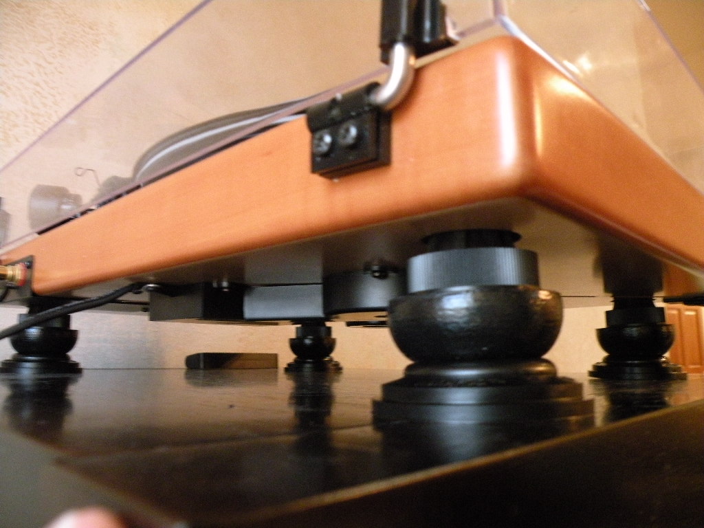

    I may end up spending more than I wanted but whatever. I just ordered a set of four Vibrapods model 2 from AA.
    Plan is to stick the sorbothane balls to the tt feet and then set them in the vibrapods. I'm gonna stick the sorbothane on tonight to at least get a little help until the pods get here.

    Sorry to dominate this thread, but hopefully it helps someone else.
    Last night I peeled and stuck the sorbothane balls to the feet just to get some isolation while waiting for the vibrapods. They worked a fair amount better than they did the other night. My thought is that I tried them out immediately the other night after bringing them in from the mailbox that was about 30 degrees. They were softer last night once they were at room temp.
    My 2yo trip/tackled a foot rest and went tumbling right in front of the rack and it didn't skip. I was able to make it skip without too much difficulty with the old 'stomp' trick, however.
    Hopefully, with the improved performance of the sorbothane at room temp and the vibrapod 'bases' that will be all I need for my setup.
  • hochpt21
    hochpt21 Posts: 5,423
    edited December 2012
    Here are a couple pics with the sorbothane balls and vibrapod feet.
    This will pretty much take care of it for me.
    Without any isolation, the needle would jump when I walked by sometimes. Now I can jog by it and it is fine. I can still get the needle to jump, but I have to stomp pretty good. Now, the kids can dance/wrestle/whatever. It's a big weight off my chest, and I finally feel comfortable again spinning while the family is home. I actually stopped for awhile because I would just get stressed out when the needle was jumping every couple minutes while the kids were in the living room. About $50 invested.
