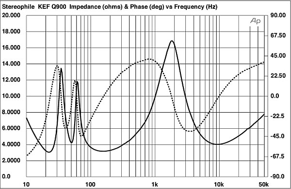

    Being efficient doesn't mean they're easy to drive...it just means, they're efficient.
    I measured the KEF Q900's frequency response in the farfield with DRA Labs' MLSSA system and a calibrated DPA 4006 microphone. The Q900's voltage sensitivity is specified as 91dB/2.83V/m. My estimate was slightly lower, at 90dB(B)/2.83V/m, but this is still usefully higher than average. The speaker's impedance is specified as 8 ohms, but as fig.1 shows, the impedance drops to 4 ohms in the top octaves and to below 4 ohms in the lower midrange, reaching a minimum value of 3.17 ohms at 160Hz. There is also a combination of 5 ohms magnitude and ?42? electrical phase angle at 80Hz, meaning that the KEF does need to be used with a good 4 ohm?rated amplifier or receiver.
    http://www.stereophile.com/content/kef-q900-loudspeaker-measurements
    txcoastal1 Posts: 13,512
    edited November 2012
    I stand corrected, but you may have to raise the budget for a decent 2 chnl amp
