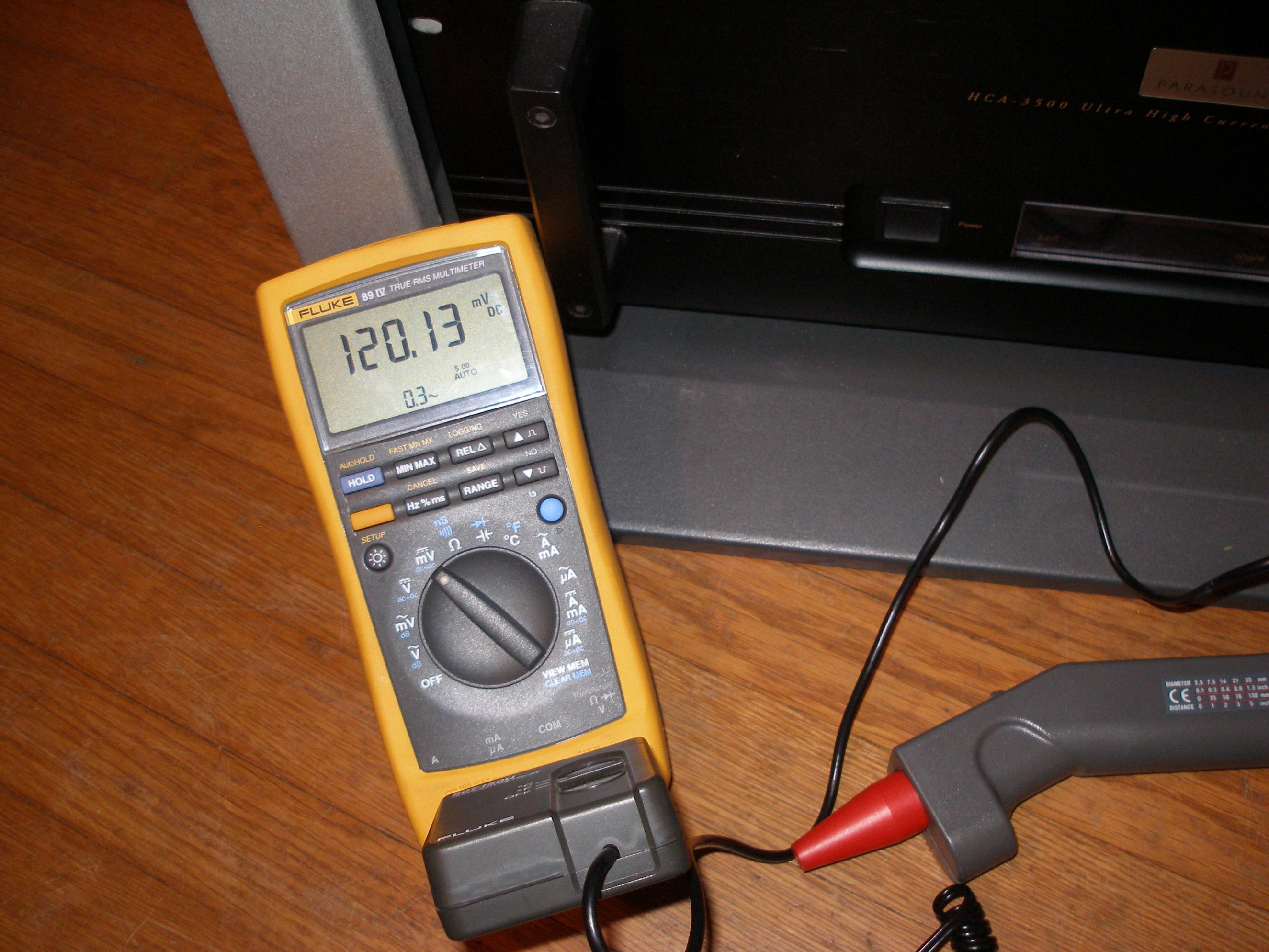

  • Amherst
    Amherst Posts: 695
    edited October 2012
    Going to implement all the advice above. Thanks everyone and especially FGTV for the insight.The unit is in a cabinet that has fans installed. The cabinet is headed for the trash heap once the new one is complete that is planned. Plenty of air movement already.
    Took some measurements this morning and the heat sink right side is running at about 120*F with a medium volume level set for a half hour run (pic below). The heat sink left side is running 15*F cooler at 105*F. Going to cool down and set at idle with no connections and re-measure the temps.
    Hope to open today and take a good look inside and check bias settings. Waiting on Parasound tech support.
    Emailed Parasound yesterday for specs and no response yet. Will call them later on if nothing shows up to the in-bin.
    All else fails it will have to hit the repair facility.

  • Amherst
    Amherst Posts: 695
    edited October 2012
    The amp stabilized at 89.1*F left side and 92.2*F right side with no connections and idling for an hour.

  • nhhiep
    nhhiep Posts: 877
    edited October 2012
    120 mW DC is way too high. normal amps shouldn't be more than 60.
  • Amherst
    Amherst Posts: 695
    edited October 2012
    nhhiep wrote: »
    Not sure what you are referring to here.
    The multi-meter is not measuring any currents or voltages of the amplifier internal circuits.
    These are temperature measurements with a temperature probe in direct contact with the heat sinks.

  • BlueFox
    BlueFox Posts: 15,251
    edited November 2012
    Amherst wrote: »
    He is probably looking at the display, which says it is 120 milli volts DC. I wonder why they didn't change the display for temperature.
  • Amherst
    Amherst Posts: 695
    BlueFox wrote: »
    Most if not all battery powered temperature probes for multi-meters return a 1 milli-volt signal for each degree of temperature to the meter. The meter is set to read milli-volt DC and read accordingly. I simply did not use that position on this read. There are some meters with an actual temp position built in, this is one of those, and will show the reading as degrees. No difference.
    Thermocouple type probes are not powered and produce a mili-volt signal directly. Generally this type of probe is more accurate but built for a smaller and more specific range of temps. The powered probes are more general purpose.
