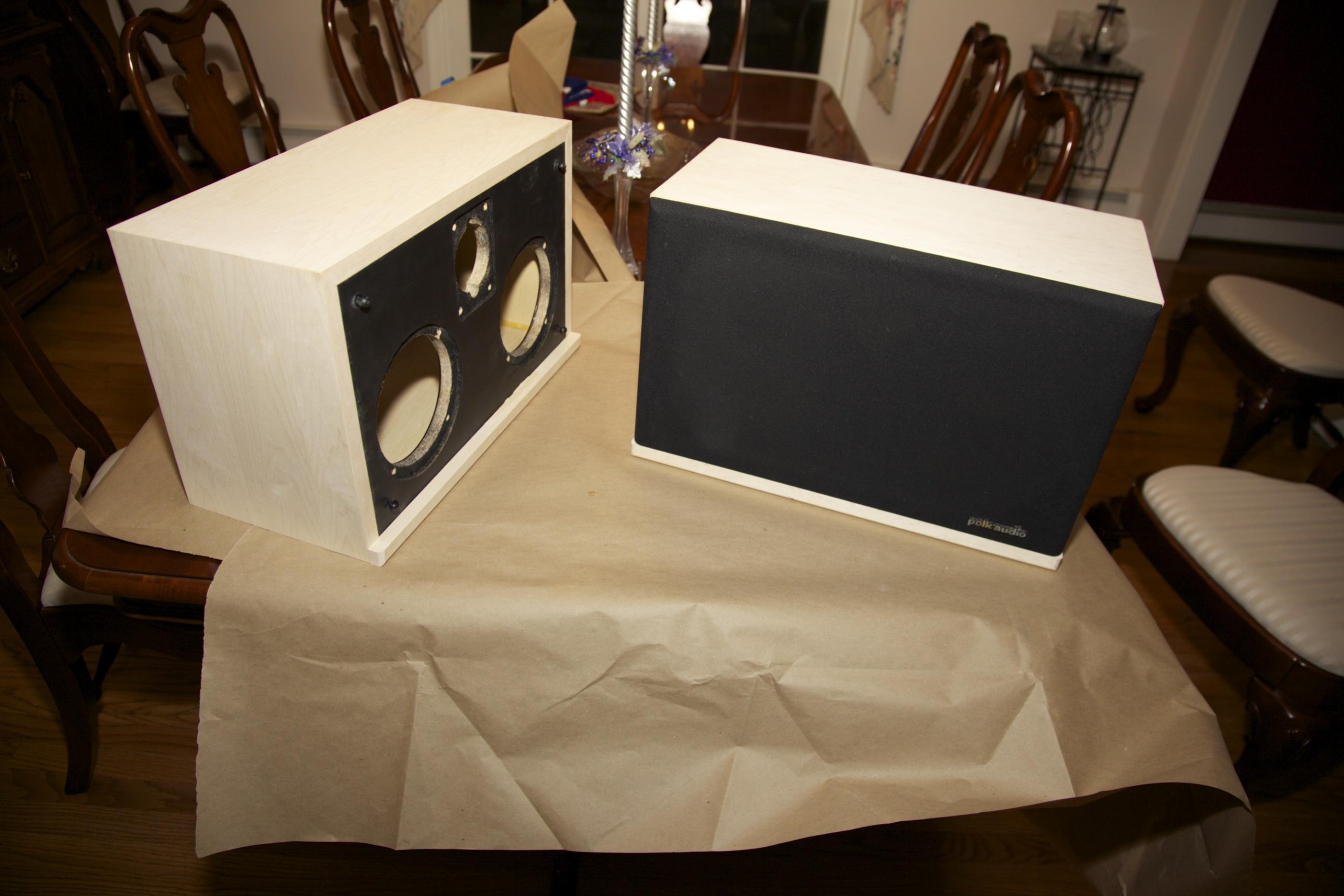

I have to say, these came out even better than I thought they would. I'm going to put up another thread after I do the final assembly (still waiting on the Dueland resistors) but I couldn't wait that long to show these off! A world of thanks to my brother-in-law, he is the wizard of woodworking. Brought these out to his wood shop yesterday, and he did an amazing job. He's got the skills, and he's got the tools. We used his planer, drill press, table saw, laser-guided chop saw, router, biscuit joiner, and an array of hand tools.

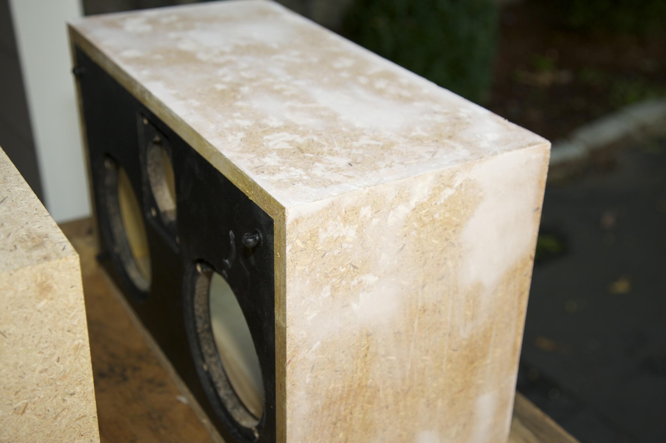

The first pic shows the raw pressboard cabinets after I did some bondo repair work on them, after botching up the removal of the old veneer. But all's well that ends well, as you can see in the two later photos. The pics came out a bit bright with the flash, I'll try to take some better ones when I do the final build. I'm showing one with the grill on, one with the grill off so you can see the trim piece and edge banding. These were done in maple, I'm going to hit them with 220-grit sandpaper, and then three coats of tung oil. No stain. Hoping those Duelands arrive very soon, and are singing for me next week!

I like them! The maple gives them a more contemporary look. Good work!SRS 3.1TL
Harman Kardon Citation 5.1
Anthem AVM2 -
Wait till they're oiled, the grain will pop a lot more then when they're raw wood as they are now.Good music, a good source, and good power can make SDA's sing. Tubes make them dance.
Those look spectacular !!! You might want to "re-think" the oil treatment and consider a high solids coating like poly/lacquer/etc. After a while oiled stuff just sorta looks dirty(IMO). Dispose of any tung oil rags CAREFULLY, they'll burn yer house down to the ground if you don't ! :eek:
Nice job, nspindel, they look great so far! When your pics are clicked on and blown up, the wood grain really comes out. That oiling that you have yet to do will really be the start of their new life! Well done....will be nice to see the final product. :biggrin:

Wow those are really great looking! On a woodworking scale of 1-10 how difficult is a job like that? What tools are needed?
It wasn't overly difficult, but I was still happy to sit back and let my brother-in-law do all the real work. He didn't use a flush-cut bit in a router to trim the veneer, he used a special edge trimming blade that worked extremely well. The trick was to work the blade with the grain, otherwise it would split along the grain line. The edge banding was easy, you just iron it on and trim. Fabricating the bottom trim piece required truing the maple board to desired thickness with a planar, cutting it to length with the chop saw, rounding it with the router, and then ripping it to correct width with the table saw. He then used his biscuit joiner to attach the trim to the speaker.
Let's put it this way, I watched the entire 5-hour process, and was the "hold it still" helper. Now that I thoroughly understand exactly what it took to do this work, I'd still prefer a skilled woodworker to do it, I wouldn't be confident enough to embark on this myself. But if you know someone who has the tools and the skills, it's a very doable job.Good music, a good source, and good power can make SDA's sing. Tubes make them dance. -
