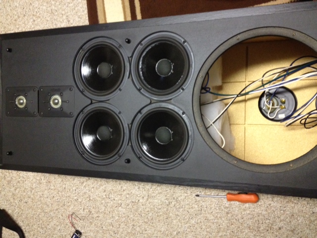

    Sounds like a bad driver (voice coil shorting out or fried), What driver is it the MW6510 or the MW6511. Take your meter and measure the DCR MW6510 = 6.57 Ohms and MW6511 = 3.13 Ohms. Also check for any reading between the connector and basket/base plate (this is a no no). Ether way I would be on the lookout for a replacement. FYI the MW6511's are the stereo drivers and the MW6510's are the dimensional drivers.
    A word on magnet shift: This is almost always caused by really rough handling or bad packing and ends up with one of two results, 1. The magnet shifts jamming the voice coil against the base plate i.e frozen driver, 2. The magnet comes completely off. In both cases usually the driver is toast because the voice coil gets damaged. If the voice coil is ok the driver might be able to be fixed but I still wouldn't trust it and would be looking for a replacement. Now Polk still sells a replacement driver but it does not look exactly like the original and some say they don't sound the same while others say they sound the same. (how's that for confusing issue)

  • Saftgeek
    Saftgeek Posts: 114
    edited August 2012
    Awwwwww... I am really bummed out now. I pulled the driver and it is toast. A complete short. It looks like I've got an extra passive radiator in my right speaker. I am in the market for a MW6511. I would love two, just in case. I've looked on ebay, Craigslist and did a random Google search... it looks like I'm in for a real easter egg hunt now. It's such a shame too, because these speakers are really, really nice.
    I guess I now have a new purpose to my life... Stay tuned.
    -Saftgeek
    F1nut Posts: 51,798
    edited August 2012
    Have you checked the lead wires that run from the terminals to the voicecoil for breakage, a cold solder joint or if they are touching each other?

  • Saftgeek
    Saftgeek Posts: 114
    edited August 2012
    I did check the leads. They are intact and not loose. The ohmmeter registered 0... From a previous post I believe they were supposed to register 3 and some change.
