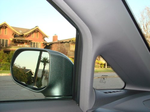

Would this location work for the SR5250? It's a newer model Civic.
Or would the same issues still exist?
By the way, if you do put a small midrange in the location Andy Jones did (further forward), is that ideal or would it be the same to install it anywhere near the midbass in the door?
