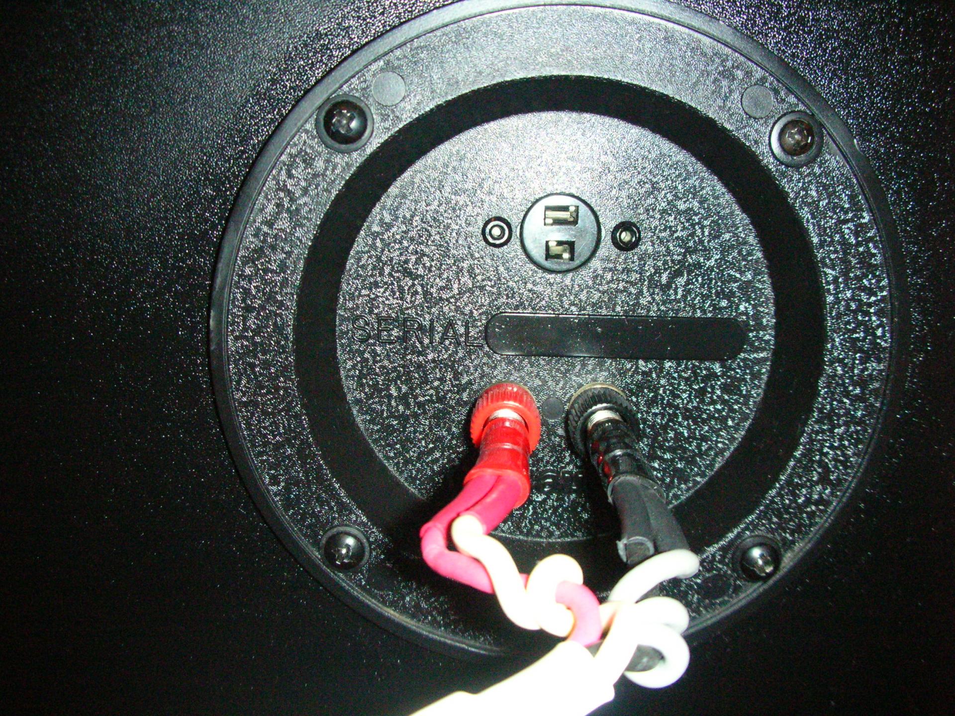

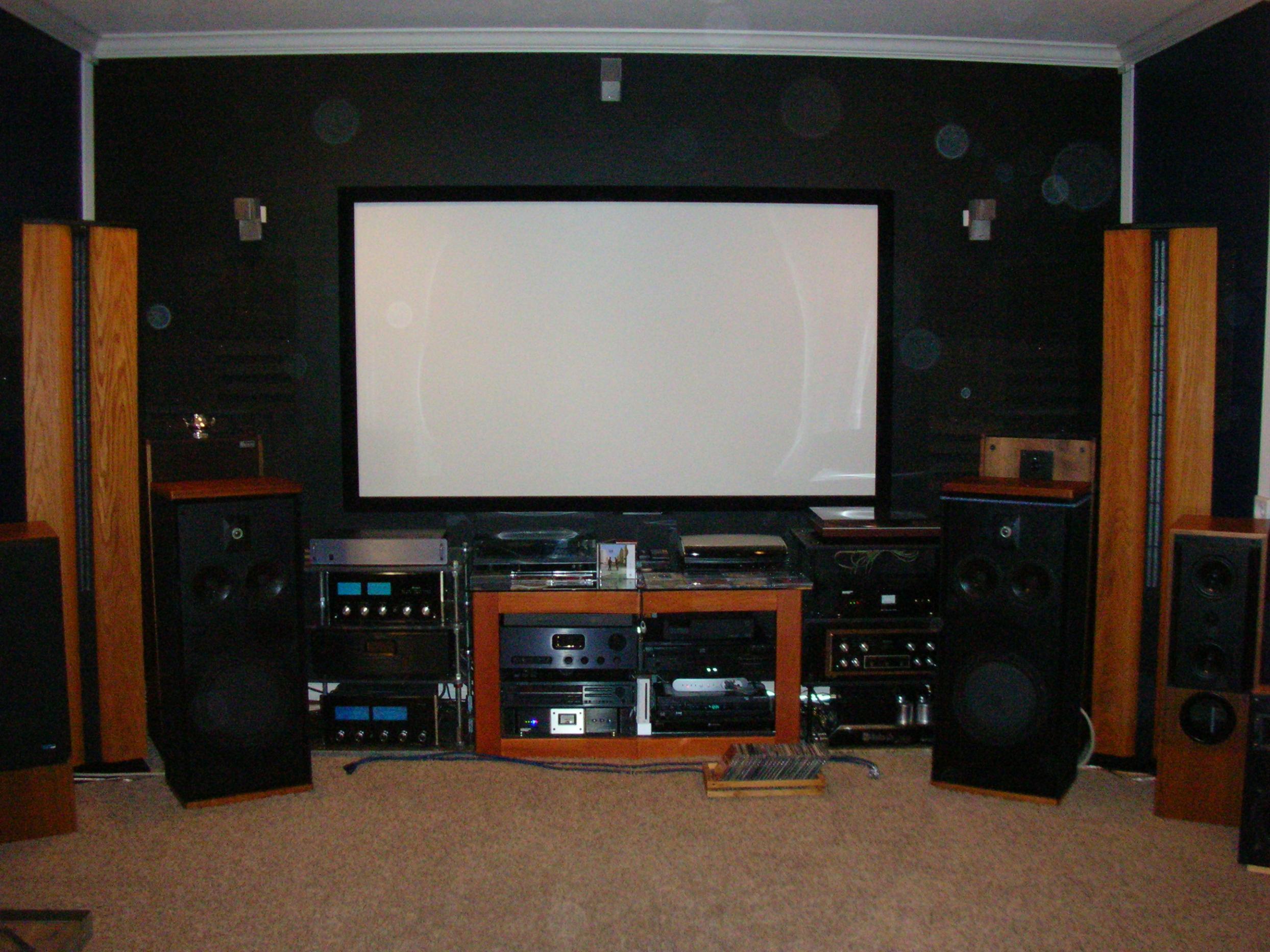

    Here's a few pics of them. Pardon the bungie cord on one....glue still drying on top of the sides. No cord connected, so they are toed in for now. Pic of the rear indicates blade blade and is there only one such cord or terminal size for these? Brgman, will your cable fit mine?
    For you guys that use Carvers Sonic Holography, how does it compare to the use of the Polk interconnect cable? I didn't get much listening time last night, but they sounded very nice without the cable, toed in, and running through my C9 Holography generator.
    Would love to hear your opinions here, thanks guys.
    Toolfan66 Posts: 18,069
    edited January 2012
    Freaking nice room and gear!! When you get your SDA cable don't toe in your SDA's

    Toolfan66 wrote: »
    +1.
    Those are 2B's, BTW.
    Congrats!:biggrin:

    Just curious about the Serial Numbers on your SDA 2's and if you have pics. Some models connected with the pin only, and some had both the pin and blade in use.
    Pic posted below, thanks. Looks like blade blade.
