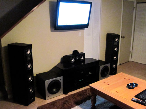

Hey folks,
So I'm a headphone guy. But recently built a film room. It works. Sounds good. But I have this feeling that I'm not powering the speakers properly. So I wanted to run it all by you experienced folk to let me know if I'm just not putting enough juice into my speakers.
Currently have:
2 x Monitor 70's (fronts)
1 x CS1 (center)
2 x Monitor 40's (surrounds)
2 x PW505's (subwhoofer, on y-splitter to run two)
My receiver:
Onkyo TX-SR308
So from what I'm reading, here's what we have from that receiver:
"65W x 5ch (8 ohm, 20 Hz-20 kHz, FTC)"
And from the speakers:
Monitor40's are 8ohm and 89db/mw
Monitor70's are 8ohm and 90d/bmw
CS1 is 8ohm and 89db/mw
The subs have their own built in amplifiers (right?) so do not draw from this (right?).
I'm not sure what the power ratings mean. The 20watts to **** watts. Does that mean it takes a minimum of 20 watts to properly power and can handle up to ****?
Also, is the "65w x 5ch" 65watts per channel or is that 65 watts divided into 5 channels so that it's 13 watts per channel (and thus very under powered for the M70's?)?
Problem is, I have no idea if that's enough.
Here's what I'm experiencing from the Monitor 70's: I hear treble out of the tweeter, and muffled mids and some muddy bass from the rest of those 4 drivers. Not very loud either. It gets louder when I turn it up of course. But I don't hear all the frequencies coming from each driver. The Monitor 40's sound fine, like they always did. The CS1 sounds fine. The Subs do what they do regardless of the receiver's power output (right?).
So am I under powering these things?
Do the 70's need more juice?
I currently have them wired on the bottom bracket on it's plate. Does this matter?
Any suggestions if I am under powered what I will need to sufficiently push this setup?
Any other suggestions or advice that I'm missing?
Thanks so much for your time and consideration.

    Yes, the subwoofers have their own amplifiers. They have nothing to do with your problem.
    Have you tried just using one pair of speakers, like the MON40 since they're simple, nothing else, and really rocking them out? If your soundstage changes and the sound is better, than YES, you need more power. If nothing changes and the sound is still muddy and not what you're expecting, it's a deeper problem. You could also hook up your center channel to the left or right and see if the condition changes and/or sound improves. You may have blown a tweeter or two....who knows.
    You can use either the top or bottom set of binding posts to power them but ensure you have the plate installed between them both.

    I would say yes, you are probably underpowering with that receiver. One thing that you can do that should help, is change your speaker settings to "small" if they aren't already. I'm guessing they are currently set to large.
    By changing this setting, you will use your receivers power for mids and highs, and let the subs take care of the lows. This will take some load off the receiver since the lows are really what take the most power. I'd start with the standard 80hz crossover setting and go from there. Using your M70's in full band mode really isn't an option until you get into something with some heft to it (Pio Elite or comparable) or external amplification.
    Edit - almost forgot... check your sub settings in the receiver, and choose the sub setting that says LFE Plus, or something similar to that. This will allow the sub to take over the bass, not just the LFE soundtrack for movies.

    I'll try that small setting (yes, they're set to large) and take crossover from 150hz to 80hz and see what happens. I have not seen an option that says "LFE plus" for the sub, unfortunately.
    Do you have any recommendations (model numbers) for receivers that would provide the power needed, and perhaps some overhead (or simply an external amp that would suffice for the M70's at least, the rest seem fine).

    Welcome to Club Polk Mal. All speakers sound better when you give them more power. I will never have less than 200wpc @ 8ohms in an amp driving my speakers.
    When I got a Parasound 1500A my 21 year old RTA-8Ts speakers came alive with greater clarity across the board. I now have a Sunfire 405wpc 5 channel amp driving all my speakers & it sounds great.
    In order to get an amp, you would first have to upgrade your receiver to one that has preamp outputs, yours doesn't.
    You have put together a very nice system, you should get the most out of it by making sure your speakers are operating to their full potential.

  • MalVeauX
    MalVeauX Posts: 45
    edited December 2011
    Hey guys,
    So I unplugged everything except the Monitor 70's. I set the receiver to be in just Stereo mode. And started playing music and then played with the config. They definitely sound more full now. No more mud. When I set them to small, it's all mids & treble. But quite clear sounding. When I set to large, boom, the bass starts thumping. They sound a lot better, more clear, setup like this. Really nice.
    I take it, the receiver does more wattage per channel when simply set to stereo, yes?
    Again in this current setup, the sounds were never muddy in the same positions. So it wasn't an acoustic imbalance due to room I think. I think it's a lot more to do with simply not having enough power for the M70's.
    Thoughts?

    Tour2ma Posts: 10,177
    MalVeauX wrote: »
    There ya go.... good start.
    First, more watts/ ch? Kinda, but not exactly... more likely a current limitation at your AVR's transformer develops when pushed in multi-ch, surround mode (especially with mains set to Large), but we still may be good to go AVR-wise. So there's room for optimism.
    It's definitely premature to say that acoustics have been eliminated.
    To begin checking the acoustics I suggest your next step be that you add the subs to the mix with the AVR still in stereo mode. Don't know your AVR, but I'm guessing you can program this option. If not, just unplug the center and surrounds.
    With just your mains and subs in action see how it sounds with mains both large and small (with cross-over set around 85 Hz or so). If muddy happens one or both ways, disconnect one of the subs and repeat. Then repeat once more with only the other sub in play.
    More later,
    Tour...

    Heya,
    Tried some more of the suggestions. I agree that sound acoustics are not ideal, but they were not the source of mud I think, since there was not mud before in the same location, simply with a change to the M70 from the M40. A lot of things are at play there, but just hearing them in stereo compared to when they were split into the 5.1, it makes me a lot more inclined to think it's power. But maybe I'm wrong, so trying more things out.
    I added one sub to the mix to keep it simple for now, while in stereo mode. Same sound. Sounds great. Just added the sub bass slam of my sub to it. I set the speakers to large with a crossover of 80hz (it does 10hz increments). Sounds good. The mids are clear and the treble is great. Tested on music and movies. I like to use Avatar as a movie benchmark because the opening has a lot of nice sub bass, some interesting mids/treble and some speech to test the full range in a short span. It sounded great just as the two M70's and a single sub. Plenty of volume. Plenty of slam. No mud. Per my other post, I've unplugged completely my centers/surrounds and left only the fronts plugged into the receiver just in case for all of this. When I set the speakers size to be small, it only changes a little since the sub is there and the crossover is so low. Still sounds good. But I felt it sounded like a little less body, so went back to Large setting and liked that better.
    Now if only the surrounds & center would work with this and I'd not need to get a new AVR or AMP. I'll try that tomorrow again to see how it changes when I set it back to surround sound on the 5.1 channels, for now I have to go to work.

    Good going... Don't worry about your slight preference for large at this point... you still have one sub in reserve and we may be able to "goose" them a tad to make up for the small loss in small mode.
    Roughly what are your room dimensions? Size of added adjacent, open spaces? Is the HT on ground floor (concrete) or upper floor (wood frame)?
    Agree we're creeping closer to a power issue, but not there yet. What we're still trying to do here is see how much your primary bass radiators (subs+mains) may have been interfering with one another. So far it doesn't seem to be the case, but we still have one primary suspect to go... sub #2. Not that the center and surrounds can't create a problem, but their bass extension is more limited.
    Next suggested step:
    Add the 2nd sub in the stereo, 2-ch mode test. With the X-over still at 80 compare the large/ small selection. FYI - the x-over is only in play in "small" mode.
    After the two sub check it'll be time to ask how you've calibrated your HT and head toward a 5-ch large vs small test.
    Ultimate goals here are to get everything working together (or at least not against each other) and then see how much load we can shift from the AVR to the subs without reducing your grin factor.

    The room is roughly around 14 feet by 25 feet or so, ground floor of a condo (concrete) on tile and I have throw rugs around.
    The two subs working in tandem sound great (phase set to 0 & 180). I like having two at lower volume, it just feels more impactful when it drops a low tone. When set to small speaker with crossover at 80, it sounds good. I still feel it sounds a little warmer and fuller with it set to large, but it's probably because I'm just a basshead or something.
    Placement isn't ideal right now. I mainly have them there for the look and to get them away from the center of the room and all because my down stairs is a little oddly planned out (stairs on the far left of the room so can't block that off, there's a bathroom in the corner to the right, a laundry room, dining area and a separate kitchen, etc. Again, it's a two story condo. So I don't have just one big room with nothing else in it down stairs. Any ideas where subs would be ideally placed?
    I guess next will be to get my center and surrounds back on and see what it sounds like.

    Yup, next up is 5-ch check. How much flexibility does your Onk have? Can you set Mains, center and surrounds individually to small, or is it all or nothing?
    Couple comments on the V2600...
    - That it's price seems a bit high based on recent ebay auctions. Three of them have sold in the past two-weeks and none was over $200. Low was $145; one was $191.49; the third was a best offer of $200 or less.
    - Yamahas tend to be on the bright side, especially compared to your Onkyo. Your Mon 70's also are considered to be bright. The combination might not work for you.
    - Also suggest you spend a bit of time on-line reading its manual just to be sure it's not missing some feature your Onk has that you'd miss.
    That said... if it's local, mint-ish with remote, manuals, boxes and you can get seller to come down to the low $200's, you won't be out much, if you don't like it.
    Room size: 14 x 25 x 8.5 (a guess) = 2975 cu ft which is already pretty damn big already... plus the stairwell (maybe 500 cu ft)... plus I'm guessing there's a bedroom hall at the top of the stairs. So you're pushing maybe 4000 cu ft total... Believe it or not what that kind of room volume will really tax are your twin PSW's.
    We should be able to make up for that little something you are missing with your mains set to small, by goosing your subs' volume settings each a bit. We may even find a room placement where the room gain will give us this boost for free, i.e., without turning up the sub volume. However, while I'm trying to guide you toward shifting burden from your AVR to your subs, the room size is pushing you to lean more heavily on your AVR. The room wants you to drop the x-over point to reserve your subs power for LFE. On the plus side you are reporting good experience so far, so hang with me a bit more and we'll see where this goes.
    The solid floor is a good thing. The rugs are a non-issue. Rugs, wall coverings, drapes and such are high frequency (HF) tamers (generally a good thing), not LF drainers...
    Time to ask you about calibration. How did you calibrate what you have? Choose to set subs at opposite phase? Choose to run both subs "cool" (volume dialed down). Nothing is necessarily wrong with any of the choices you've made, but need to understand how you got where you are.
    As for placement... mosts subs default to a front corner and are moved along the front and side walls to optimize them. The easiest way (not the only way though) to manage bass from twin subs is to co-locate, i.e., stack, them (with them definitely in the same phase as each other). But there is a trick that avoids moving 100+ pounds of subs around a room... you put the subs at your primary listening position and crawl around the edge of the room to find their sweet spot. More on this later...
    A corner option doesn't appear to be available in the pic you posted, but there is some wall to play with. Not that the swap would be easy given the flat screen wall mount, but is the other end of the room an option for the front stage or is that the dining room? If it's the dining room you may have to decide which is more important, HT or eating... :cheesygrin:

    So I just watched a movie with all the speakers plugged in. Ran it in Neo Cinema or whatever that is. I had all the speakers set to small. Ran the subs at equal phase. Not high volume, but just under 12 o'clock on each. Crossover set to 80hz. Worked out great. I enjoyed the sound. I need to play more with the sound settings though. I actually keep everything flat except treble, I added a few dB of treble as I just prefer that sound, it gives it an edge during movies that I enjoy. The different preset settings though, some are good, some I just don't know what's going on. Like, "All channel" or "Neo Cinema" or "Direct." I really just don't know which to use, and one moment it will sound right, another I feel like it's messing it up. I suppose I should just set it to be generic.
    Thanks for the help. I can probably survive without anything else for now. I'll eventually pick out a new receiver to go up to 7.1 and get some more surrounds (some M60's I think). I'll see if I can find something used that does 120+ watts per channel and 7.1 with preamp out.
