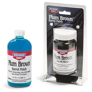

    The plum brown isn't working out so hot on the pipe either. The floor flanges came out great! The plum brown was a little too not brown but a gunsmith dude told me to rub them down with used motor oil and it'll darken them up real nice. Looks like oil rubbed bronze. He said there wasn't much I could do with the pipe though. They put a coating on it and it's heat treated so it ends up working like bluing does. The plum brown won't come out so hot over the coating. Looks kinda brownish purple. He said the only way to get the coating out is an acid bath. A local gun shop should be able to do it but, honestly, I'm not that worried about it. I'll figure something else out.

    The pipes are 30" long. They had a coating on them and they were blued underneath the coating. I stripped the coating off and acid bathed them to get the bluing out. I then cleaned them and the iron flanges with Simple Green (best degreaser ever) and then acetone. I threw them in an oven my dad has for just this type of thing. Dried them all out. Then, that Plum Brown above? Yeah, pain in the ****. Did 3 applications to get the color I wanted. Came out looking like oil rubbed bronze but very flat.
    So, using a technique I saw on "Trick My Truck" from Ryno, I took a straw and head from a WD-40 can, put it on the can of Hemi orange, ate a Good Humor Strawberry Shortcake bar and the washed the Popsicle stick. Holding the Popsicle stick at a 35 degree or so angle at the end of the straw in the paint can, I lined up the uprights outside and splattered them with the orange paint. Little specks all over the uprights gave it a bit of a sparkle. Kinda like flecks of brass or gold. Then I coated them with the Dupli-color clear coat, sanded with 220 then 400 grit, washed down with water and then a tack cloth and another coat of clear. Sanded with 400 grit again and shot again. Let dry and rubbed down with an old wool sock to get a nice smooth finish on the surface without polishing it shiny. Looks like oil rubbed bronze but the finish won't wear off.
    Next, went to cut the mahogany and I was 11 square inches short. Dang. So, went with the good old stand by birch veneer. Needed edging so I bought a couple lengths of poplar edge banding that was already molded. I cut the edge molding and finished the joinery by hand with a miter saw and a miter box. Had some issues with the wood filler I used taking the stain but my dad gave me an alcohol based tinter (basically stain that is concentrated) and I put that on to the problem spots with Q-tips. Came out good. Did another coat of stain then 2 coats of poly.
    Once that was all done, I started assembling. I used some rubber gasket material to eat up the length differences under the top plates so you can't see it. I screwed the flanges in with 1" sheet metal screws so I could get the rounded heads. They fought me and one pipe isn't totally straight but you don't really notice it unless you're looking for it. Using a level and a yard stick, I got them as close as I could. Variations in the material made it difficult to get exact measurements so it's close and eyeballed from there.
    I took forever because I was busy refinishing a room and work was also getting in the way. They still aren't finished in this picture. They need rubber feet so they don't mar the floor in the library. I'll get them either tonight at WAL*MART or at a hardware store tomorrow.
    Oh, finishing touch, the oil rubbed touch up paint that came with my bathroom fixtures from Moen. Dabbed it on the screw heads and they just disappeared in to the flanges. Sweet.
