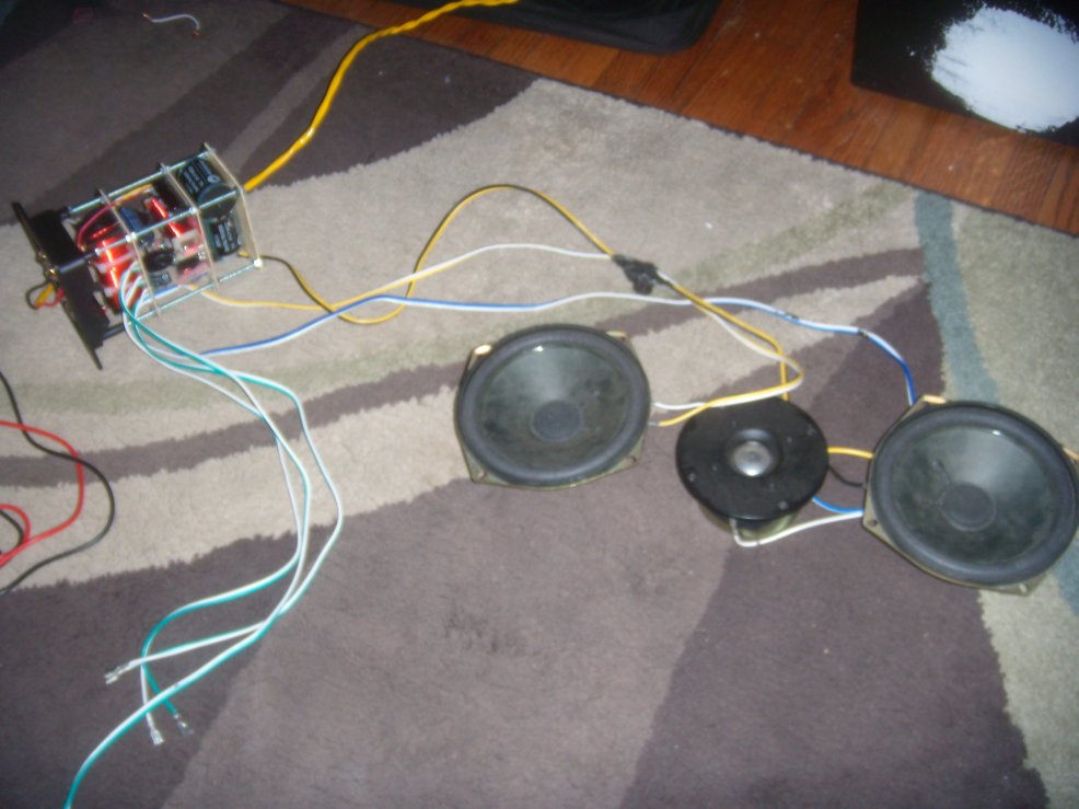

    Yep it is a hoss...
    This one is a little different than the first one I did - the 12 uf was OOS on the first one and I used dual 6's so my arrangement was different.
    I am getting faster though - clocked myself at... 1 hour and 45 minutes on this one! :)
    Going to throw it on the tester tomorrow!

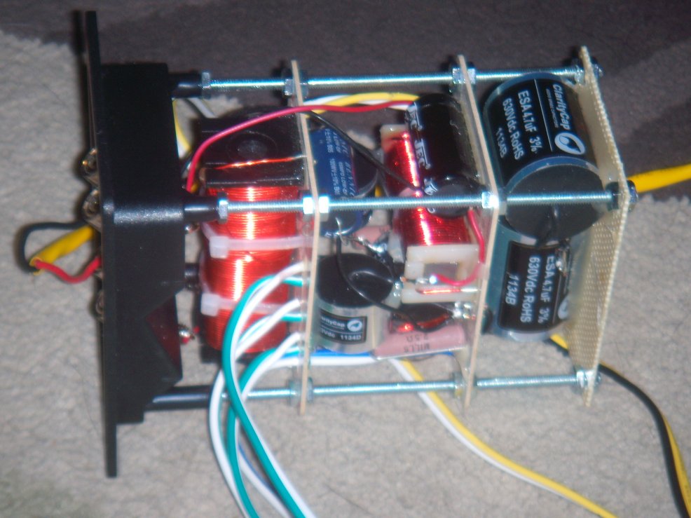

    This was an extremely difficult mod.
    Arranging the bypass caps on the stack was... interesting!
    I think it would actually be easier to replace the original caps if you could make room on my tower of power!!
    Turned out good, dont have enough drivers to test the whole speaker so I am testing each board separately -
    SKRILLEX sounds odd with no bass! lol

    I also find it interesting that the markings on the RTia boards for the values are never matched to the values on the caps.
    I am curious to see how they would sound using the board specs...

    I would like a little more education on how you tested these crossovers. what is SKRILLEX
    VR3 Posts: 29,429
    edited September 2011
    I do quick measurements with a volt/ohm meter and will throw on the wt3 with drivers just to see what my receiver will see so I dont blow anything up and then I just run the crossovers full bore for about 20 minutes...
    skrillex is a dubstep artist lol

    Trey, what is the big cap in the center's xover?

    82uf (csia6)

    just wondering, if the largest cap value is not sufficient, you can link two lower value caps together in parallel for the use of one large cap?
    for an example:
    if 82uf is not present, you can link two 41uf to fit into that slot? Would you join them as parallel circuit? or just link them together? (or something like that)
