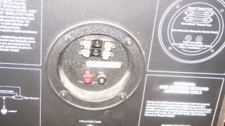

Also I swapped fuses around and I only get sound (from the tweeter) with the fuse in the top slot, and its like that on both speakers, does that mean each speaker gas a bad tweeter? -
If you've got two tweeters in each speaker I'm pretty sure that means you've got the original SDA 2 (not 2A or 2B). I have the same speakers. I haven't played with the fuses, but it sounds like you may not have any bad tweeters. Like chandler9a said, one tweeter and one of the mid-woofers in each speaker is part of the "dimensional array." Those drivers only work if you have the interconnect cable connecting the two speakers. Without the interconnect, you're not going to hear much from them. With no interconnect and the fuse removed for the "normal" stereo drivers (I assume the top slot from your description) you probably won't get sound from either tweeter.
You can make your own interconnect. In a pinch all you need is normal speaker wire. I've been using 16 gauge, just twist and double up the ends to get them to hold firmly in the slots. But, you need to be very careful matching the ends. Polk used a number of styles of connectors. Mine have one longer slot and one shorter slot on each receptacle to receive a long blade and short blade on the cable plug. It is very important that you connect the long to long and short to short. If you cross them you stand a good chance of sending your amp into thermal protection shutdown.
Later connectors have a blade / pin configuration instead, but that may just be SDA 2A's and later. (Earlier ones are different with pins that stick out from the receptacle, but these are very rare from the sound of it.) Same thing applies as far as I know... connect like to like.
Once you have working fuses installed and the interconnect in place you can test it by putting your amp into mono mode or just putting on a simple recording that sends mostly the same stuff to each stereo channel. Turn the balance on your pre-amp all the way to the left. You should still hear the dimensional tweeter and midwoofer working on the right speaker, just fainter. Then you can repeat the test in the other direction. This will tell you if the dimensional drivers are working.

1AMP FAST-BLO is the type of fuse my SDA-1's take. I'd assume it's the same with your SDA-2's.

Not to muddy the waters, but I just dug out the instruction manual for my SDA-2's. On the Physical Specifications page it says the following:
Fuses: 1 amp, 3AG Fast-Blo Stereo & Dimensional, H.F. only.

Just out of curiosity, are the fuses on the outside of the speaker cabinet on the same escutcheon plate with the binding posts? If they are, then maybe you don't need to take the fuse description with a grain of salt... you might have a slightly earlier SDA 2 that is more accurately described by the manual than mine. -

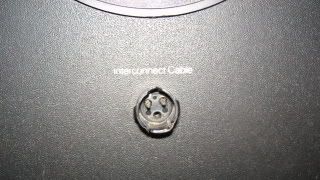

Just so everyone knows the inside of the plug for the interconncet on mine is 2 male pins the same length and a hole centered below that is maybe a female but its hard to tell if something is actually plugs in there.

Sounds like it's worse than that even. From the description, could be this thing (copied the picture from out of the thread for easier reference).
http://www.polkaudio.com/forums/showthread.php?t=24085
Unless you can find some small and well insulated alligator clips like Tide used, I'd say you're stuck pulling those out and replacing them with something else. -
Someone name me a nice vintage reciever that these will match nicely with cosmetically and power wise.
I've run mine with a couple of different integrateds (NAD) and amps (Hafler 9180 and B&K 200.2). Personally, I'd recommend something with at least 100 WPC and a fairly decent damping factor (like better than 300). Moving to a bigger amp really seemed to tighten up the bass for me, and the B&K gave me more warmth and detail in the midbass than the Hafler. The Hafler seemed to be a REALLY neutral amp.
I don't think there's any reason why you couldn't use the Pio at least temporarily... I don't know if I'd try driving your HT speakers and the SDA's at the same time, but I think all the Elites run about 90 WPC or better. -
On3s&Z3r0s wrote: »Sounds like it's worse than that even. From the description, could be this thing (copied the picture from out of the thread for easier reference).
I was just about to post a pic............
YES this is the same as what mine has. Alligator clips????? I'll see if I can come up with something better. My do some upgrades later, if so I'll swap the connector plugs. -

heres what the fuse connectors and the IC plug look like

I wouldn't recommend this as a permanent mod, but using crimp-on insulated automotive disconnects is quick and gets the job done while you're figuring out a more permanent solution. I used a combination of blade and bullet disconnects so I wouldn't forget which wire goes where. The stock internal wiring to the interconnect receptacle on my SDA 2's is 20 gauge. The left speaker has a black and a white wire. The right speaker has a blue and a white wire. The left speaker's black wire is connected via the interconnect cable to the right speaker's white wire. The right speaker's blue wire connects to the left speaker's white wire.
Those are early SDA's and I believe Parts Express sells a connector that will work. The search function isn't too good, but I know this issue has come up before and there is a decent fix.
They aren't blade/blade and they aren't pin/blade. Very early SDA's used that funky connector
H9"Appreciation of audio is a completely subjective human experience. Measurements can provide a measure of insight, but are no substitute for human judgment. Why are we looking to reduce a subjective experience to objective criteria anyway? The subtleties of music and audio reproduction are for those who appreciate it. Differentiation by numbers is for those who do not".--Nelson Pass Pass Labs XA25 | EE Avant Pre | EE Mini Max Supreme DAC | MIT Shotgun S1 | Puritan Audio PSM136 Pwr Condtioner & Classic PC's | Legend L600 | Roon Nucleus 1 w/LPS - Tubes add soul! -
Yeah, and the original booklet, iirc, called it an "RTA-type connector". Why? No clue. It's similar in size and shape, I think, to the XLR3 plugs. A good mod may be to replace that receptacle with an XLR3 jack and find an XLR3 F/F cable; you'll probably want a 20' cable at least depending on your setup. Since you'll only need 2 wires and are simply using the XLR3 for a standard cable & recepticle, you can use biwire (ie: lamp cord or commercial speaker wire).
Look at Moon Audio, it'll be $4 per socket and $5 per plug for basic XLR3 connectors, so $18 to do the mod not including the wire. They have some sockets that look like they'll fit with minimal modding. Either way, On3s's little hack-job, while it'll get the job done, will probably change the cabinet's properties a bit.polkaudio Monitor 5 Series II

Just talked to Polk support; the rep said the original cable (pre-blade/blade) was the "A-1". Since I've never tinkered that much with DIY electronics, I can't visualize how the SDA cable is utilized exactly. Disregard what I say next unless a few others validate it...
The original A-1 cable had both pins active and needed be be switched...
1 2 pin (R)
A B wire
A B wire
2 1 pin (L)
So to use biwire, you'd have to connect Pin 1 on the right side and Pin 2 on the left side with the same wire, and Pin 2 on the right with Pin 1 on the left. After that, it'd be reversible; you can use either left or right end of the cable with either left or right loudspeaker and have it connected properly. I'll do my best to validate that in about a week or two (if it's not figured out by then) with a multimeter or something.polkaudio Monitor 5 Series II
