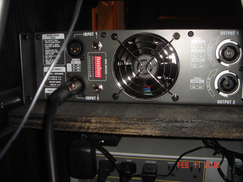

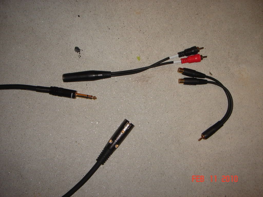

Hello Everyone,
I have been a long time follower of this forum.
I am trying to connect an EP4000 to ONKYO 805 AVR. I have 2 XLR Male to 1/4inch TRS Male , 2 Audio Y Cable, Quarter Inch Stereo Jack to 2 RCA Plugs and 2 RCA Male to Dual RCA female Y-Cable. I have attached the pictures. I would like to run my main speakers (Polk Audio RTI 12s) using EP4000, 1 Channel per speaker.
I connected 1 speaker without using the RCA Y cable. I did get sound but the speakers did not sound like I was using an external amplifier. I had to crank up the volume all the way uo to get the performance I would get from my receiver.
My questions are
1) Do I have the correct cables to do what I want to accomplish?
2) Do I need some kind of voltage adjuster like Samson S-convert to boost the signal level to the amp?
Thank you,

Well, for starters,thats a pro amp,4000 watts,not exactly what you want my friend. As far as I can see,it has pro inputs and outputs,not your standard flair for a HT receiver. Want to know why you don't hear a difference? Your speaker cables are still connected to the receiver. I'm willing to bet the amp only has balanced connections for pro speakers. Get an amp for home use friend.HT SYSTEM-
lsi 9's -

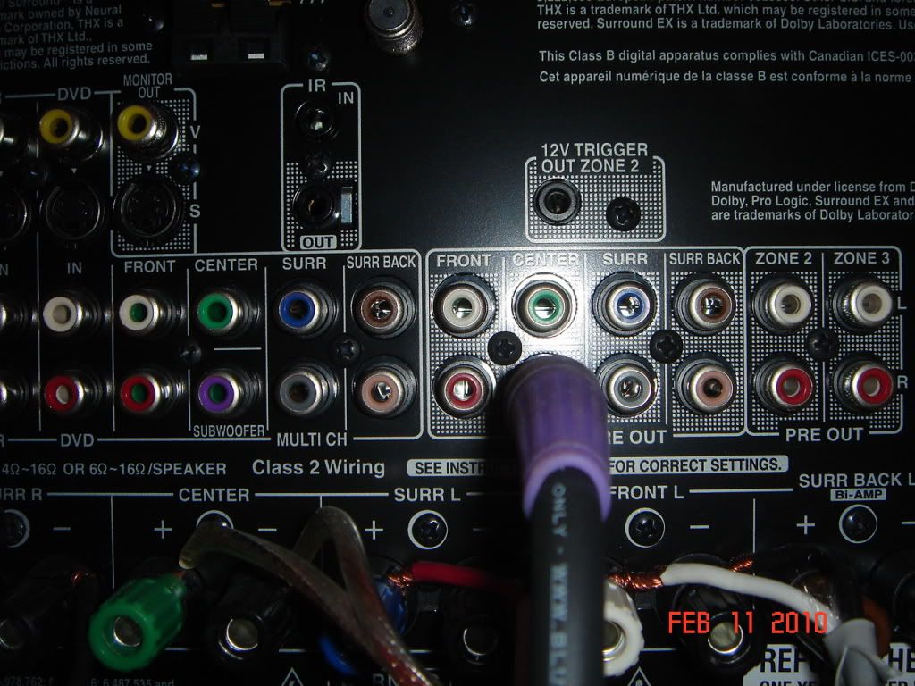

The pro amp most likely has a higher input impedance than your receiver is outputting. Your first step is to get rid of all the adapters.
Now:
Try the Art Clean Box Pro This will take care of any differences between the Pre-outs and the AMP line level in. So yes to a box like the Samson S Convert.
Next get:
RCA to XLR cables.
Then:
TRS to XLR (balanced)
You will need a pair of the TRS to XLR...
That should get you there. -
Correction the pro version will take RCA in.... Just need two RCA to RCA and two XLR patch cables.
BTW welcome to Club Polk. I see you met the other welcoming committee.
I run Mackie power amps. You want an RCA to 1/4 unbalanced cable, or an RCA to XLR cable. These can be had. If you can't find any, then run good RCA to 1/4 adapters. Come out of the inputs labeled Front L and R. Run one cable to each input on the EP labeled 1 and 2. But that 4000 is a bit much for RTi12s. the 12s are rated at 500 wpc, and will take up to about 900-1000 before drivers start over heating and the voice coils melt down. Believe me on this. There is such a thing as too much power, even if it's clean power.
If you run it like this, you'll probably have to lower the volume on your receiver channels to match volume with other speakers. I had to run my AVR at -6 db at 1000 wpc. I can get you pics if you still don't understand.
I can also tell you that once you get it working, the 12s will really open up. I get very good dynamics and an incredible sound stage out of my running them at 850 wpc out of the Mackies. It may take them a while to break in. I bought my 12s used from a guy that had had them for almost 2 years, and they didn't get really broken in until I brought in the big power. Then they smoothed out and opened up quite a bit. Prior to that they were pretty forward and very bright, even a bit harsh.Turntable: Empire 208
I did connect the speaker cables to the amp when I tried to see if the system was working. Then, I connected them back , once I figured out that I did not have what I needed to make this connection work. Movie Theater
Now:
Next get:
RCA to XLR cables.
Then:
so, it is obvious that I need the clean Box pro or Samson converter.
I will use the XLR to 1/4" Cables that I have. So, will this scenario work.
from EP4000's 1/4" inputs to Clean Box Pro's XLR input for both channels .
Then I need to use the ouput of the Clean Pro to the output of my amp.
can I just use a RCA cable for this (using the unbalanced output in the Clean Box Pro? or do I have to but XLR to RCA cables?Movie Theater

Slow down. You can't go from input to input. Its Output->Input->Output-Input.
You will go:
Receiver/Pre-Pro (RCA) Output -> Art Clean Box Pro (RCA) Input. Then Art Clean Box Pro (XLR) Output->AMP (TSR) Input. -
