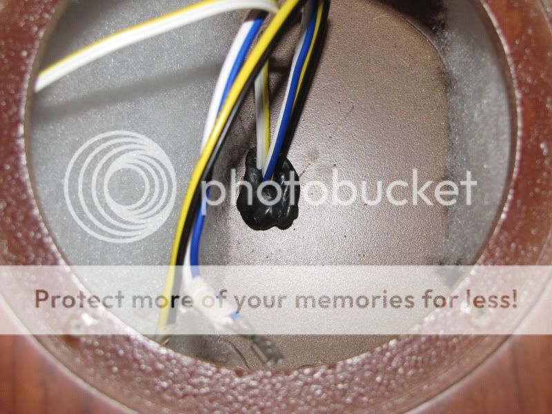

    here's the mortite plug in the upper chamber, stuff was really easy to work with. has the consistency of silly putty

    heres the culprit. as you can see the white square thing on the left, the bottom is melted and warped. after replacing the xo and putting everything back together, still no sound from the tweeter! :mad: fortunatly for me, I had a brand new one in the closet. put the new tweet in and bam! full sound from all drivers and tweet :)
