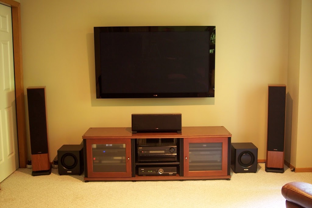

    rally - I also have two mP1K's, and have them on either side of my AV cabinet. Though I haven't done critical listening from all seating positions, this arrangement sounds great for normal movie watching. I see your second diagram is closer to my current arrangement than your initial posting's sketch. Glad that the second arrangement works better for you.

    ^^ Forgot to mention my mP1Ks are on carpet/pad/slab on grade, so they don't sink too low for the passive radiator to bottom out. When I was testing the mP3K for the popping noise, I visually verified that its radiator was not hitting the carpet. the mP3K is in the car tonight, waiting for a trip to the UPS store tomorrow... :(
    BTW, note that the mP3Ks are only 1.5" wider, 1.5" taller and 3/4" deeper than the 1000s. Surely you can fit a pair of these in your room! ;)
