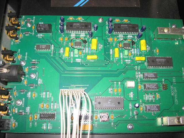

    Okay here we go
    Replace op amps(I used the Browndog OPA 627 from Cimmaron Tech,, you can de solder and replace or use a DIP * adapter that allows you to roll the opamps like you would tubes,I just replaced mine with the Browndogs and soldered them to the board
    Add 120uF caps 25 volt caps to i parrell to the .1uF bypass caps (c 528,529,530,531)at the power pins of the op amps Careful to mainatin proper polarity,these serve as local power reservoir's for the opamps.
    Next--the all inportant 15 volt regulators that feed the analog section (OPA 627)Remove the 2 10uF caps (C100 and 104)and install 470uF 35 volt or larger(i used the 470/35v)
    Replace the 2 .1uF caps at (C122 and C 123) with 22uF 25volt caps.This will increase the ripple rejection.
    L550 and L 555-1 remove the inductors and jump them(it is felt that these ferrite inductors might mask the flavour of the op amps)
    Remove the caps at C 550 and 551(just desolder and remove)
    I ordered my caps from Digikey--get the Panasonic FC series
    At first I felt the unit was not as "laid back" as before,,it was different,,in a good way,, very revealing,apparently accurate,very fast,,and overall,it just sounds damn good.If anyone is going to attempt this,,you will NEED a desoldering iron to remove the components,as they are small solder joints.Also make sure that you install the opa's correctly,,pin number 1 is usually designated with a marking of sorts,,and the corresponding pin on the browndog is the "b",in browndog,,if you are not sure,, call the manu. or shoot me a pm. I have some extra caps left over from my project,,if you need some,to do THIS mod,,pm me.I only wish the I had the talent to compose this mod in better format,,but I have to give thanks and credit to a former member GV-27 who hung with me,and stepped me thru this project.Up until now,,I never thought an external DAC could make such an impact in my system,,this has to be one of the least expensive/biggest bang for the few bucks spent mod I have ever done,,I'd rate it on the level of going from stock SDA crossovers to ones with sonicaps--huge impact.
    If you attempt this easy mod,the biggest price impact will be the OPA's.If I can help,please pm or call me.

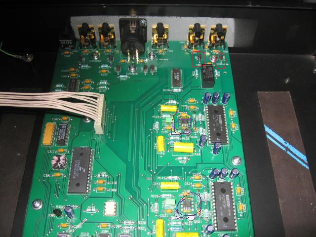

    the op amps are circled in purple. When you renove the note their orintation,specifically the power pin( usually dsginated by a mark,logo,letter)-,then replace the new op amps with the proper orientaion of the powwer pin. Solder in place
    Next the "ferrite conductore--circled in red are removed and replaced with jumpers. If you follow the instructions,you will not that each component has a corresponding number.Jusr br careful when replacing the electrolytics that you maintain prpoer polarity
