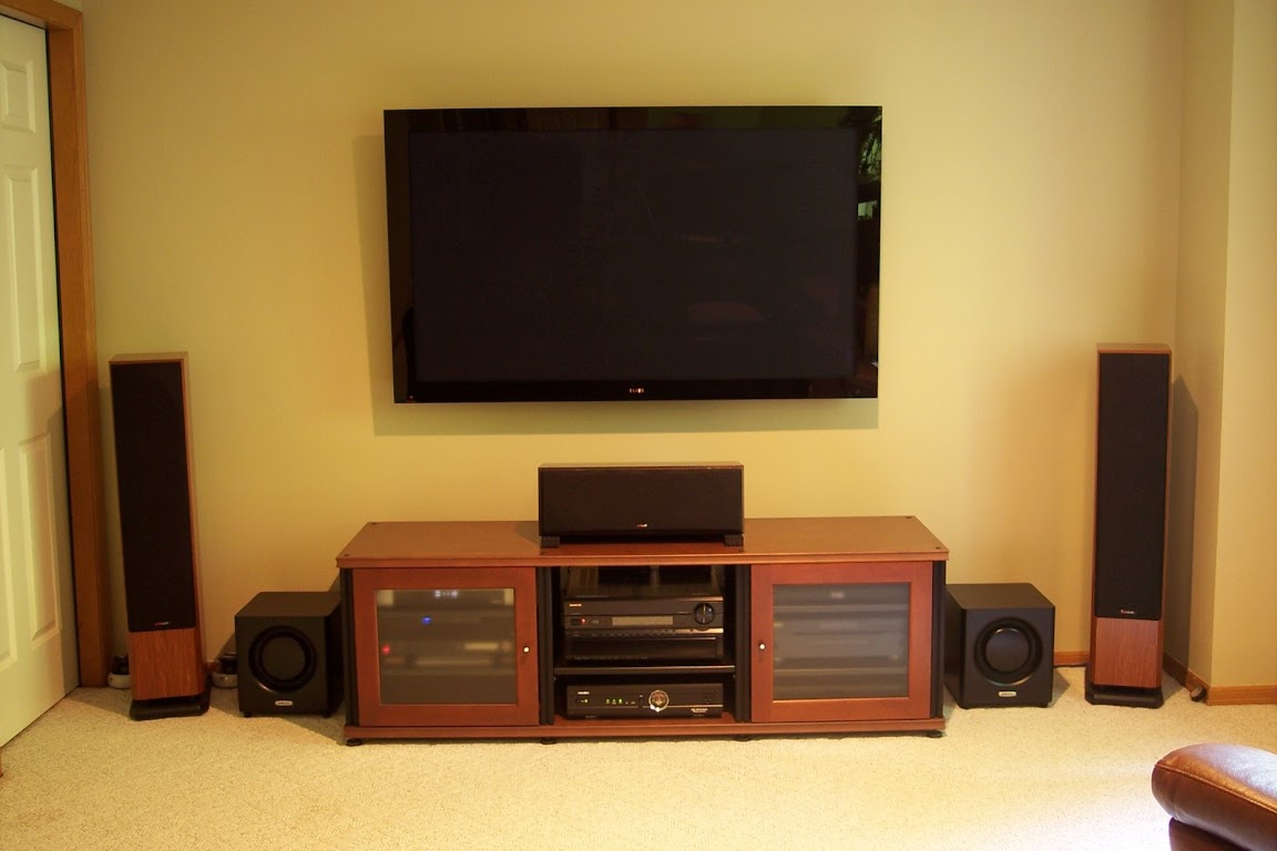

I have two microPro 1000s fed by an Onkyo 805. I used an AudioQuest splitter at the Onkyo's sub connection, with equal lengths of sub cables into the subs LFE inputs.
This works perfect for my setup as the subs are about three feet to either side of the amp. I didn't have to worry about long cable runs like you do - see pic below...
