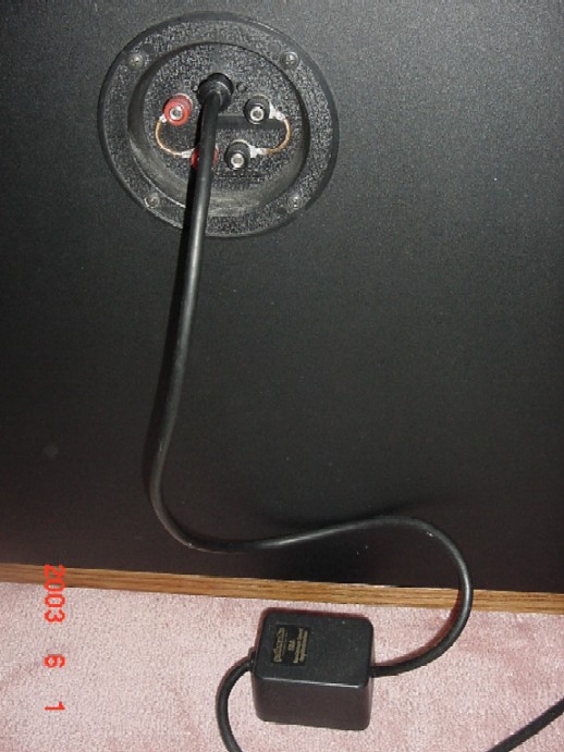

Pin/blade interconnect for SDA speakers...
I know you are looking something like this:) -
that would work:D how much?:)
Sorry that is the Original Interconnect for SDA speakers from
Polk and they are not making them anymore.

For Scotts purposes he probably would want to hook up both pins even though only one is required. The reason is that the grounds are not tied directly together on his amps. To be safe he should probably use a 1:1 transformer as well. (like the original polk isolation cable. I think I still have the info on the xformer if anyone needs it.

Sean,
I can build one like this for ya, but the Isolation transformer alone costs around $35.00 + the pin/blade interconect cable.
Here is the link to get this Isolation Transformer.
http://www.newark.com/NewarkWebCommerce/newark/en_US/support/search/searchResults.jsp?action=0&First=0&QText=isolation+transformer&x=16&y=5 -
