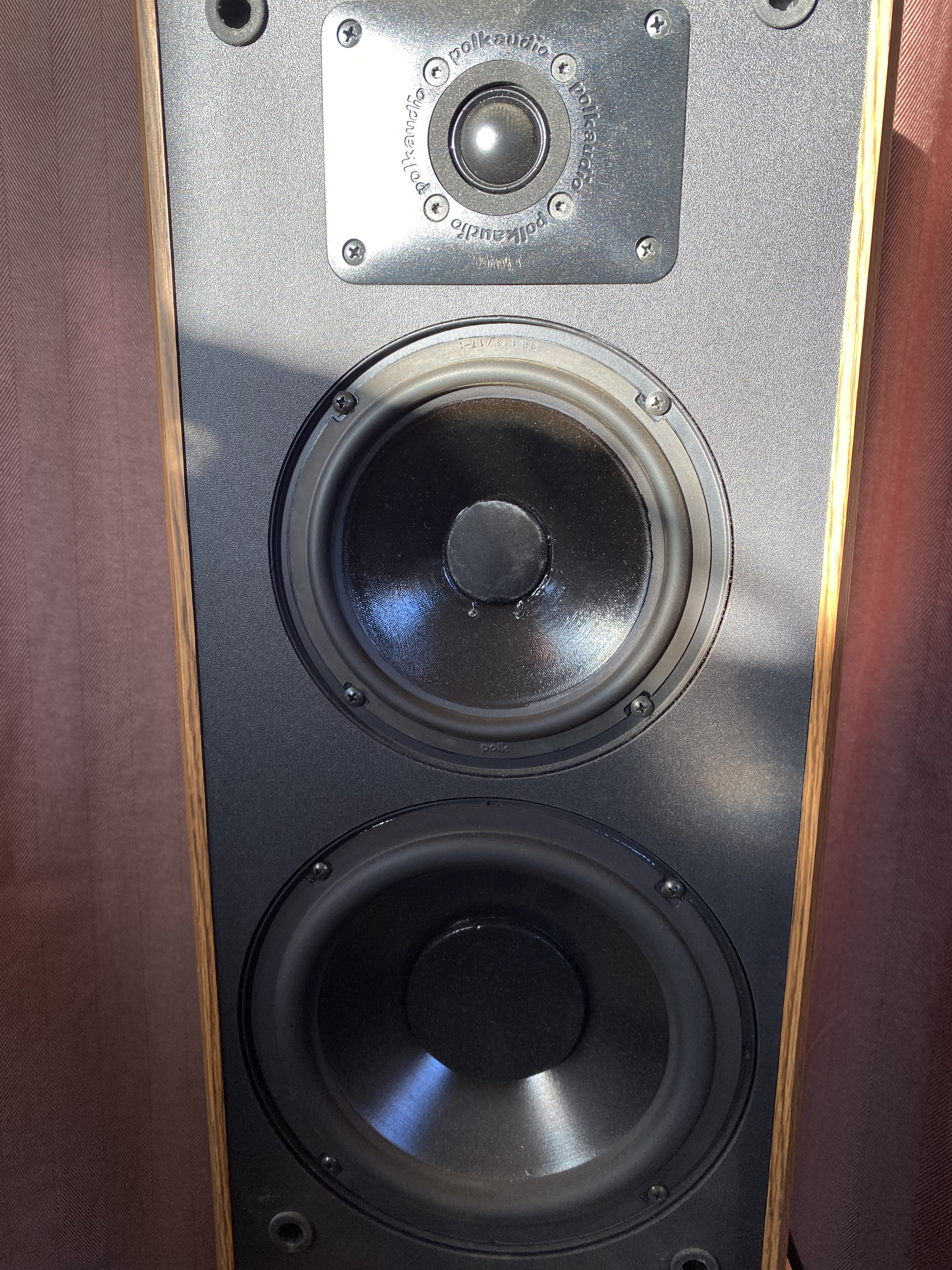

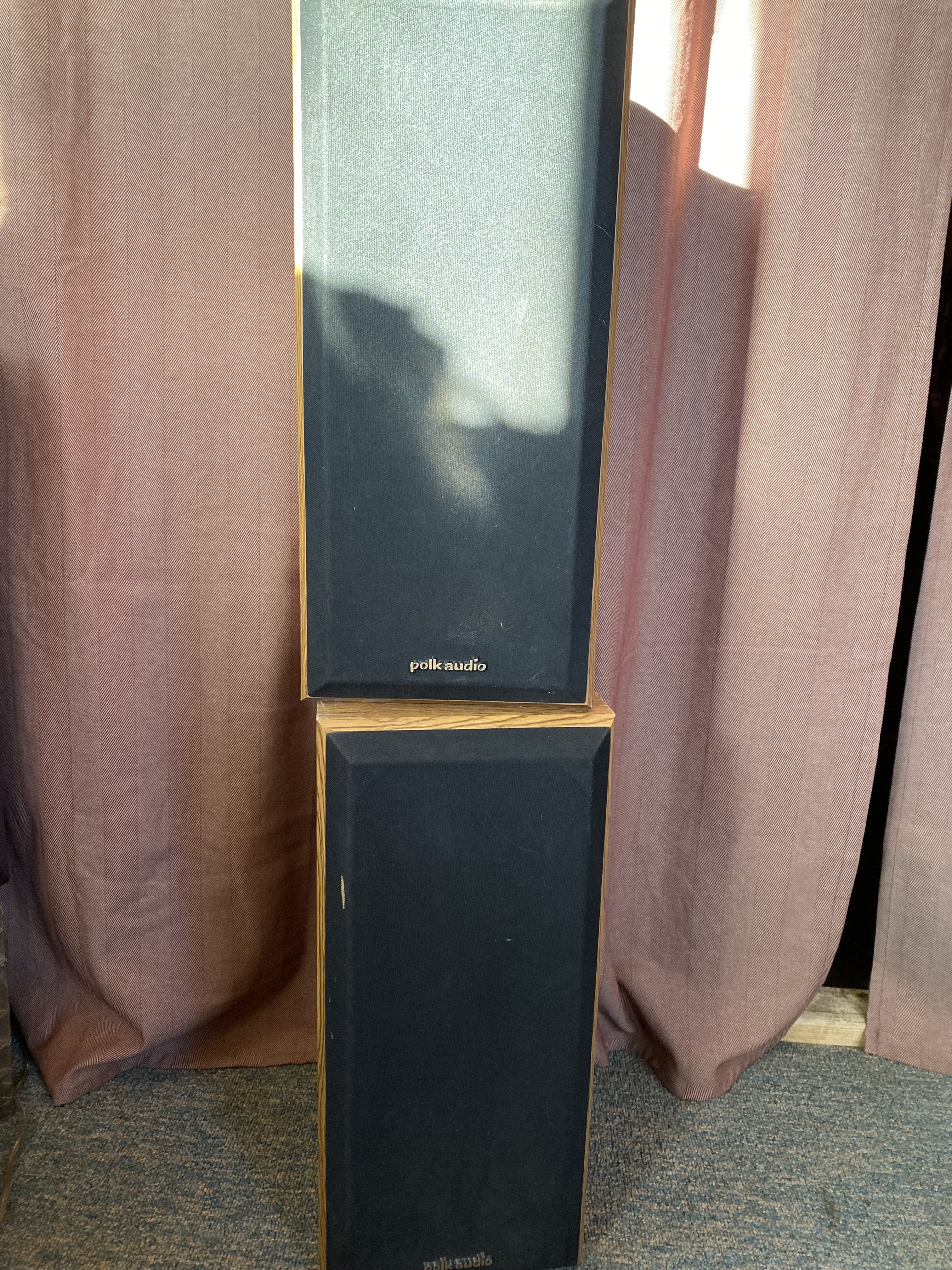

    I’m new here also and have the same question. These guys came from the thrift store today. I paid every penny of ten united state’s dollars for the pair…
    Thanks in advance 🙏🏻
  • AuggieWest
  • AuggieWest
    pitdogg2 Posts: 27,780
    edited April 2025
    Monitor 5jr+ series 2
    F1nut Posts: 52,305
    You paid nine United State’s dollars too much.
  • AuggieWest
    Thanks muchly for the quickness of responsiveness.
    Dang, highway robbery

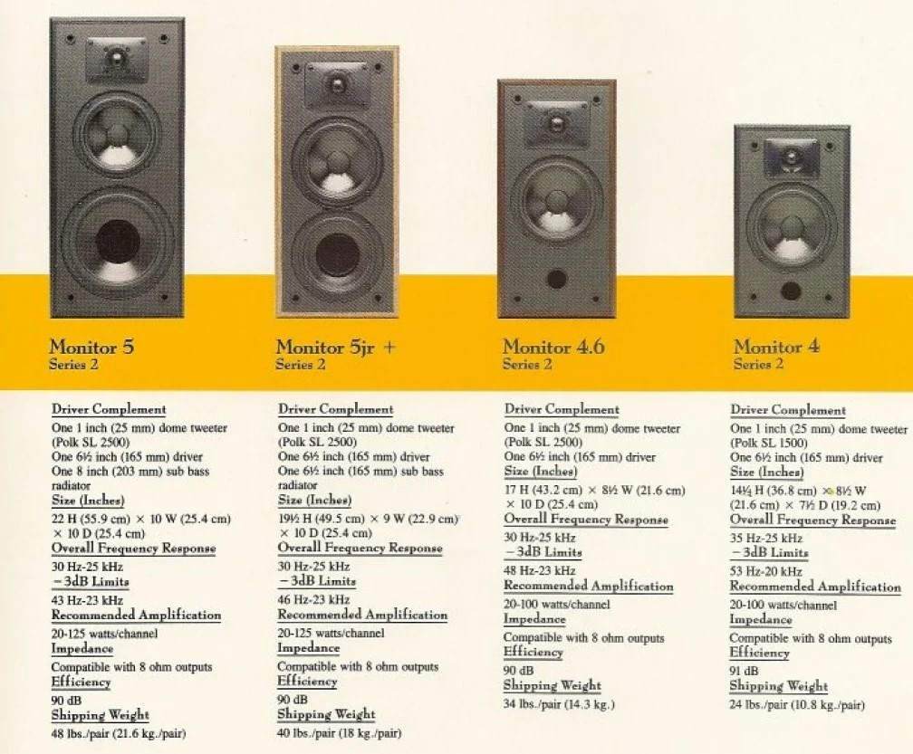

  • stevep
    stevep Posts: 366
    Given the size difference between the mid-woofer and the passive I think they might be Monitor 5 Series 2. The 5jr+ passive is the same size as the driver.
