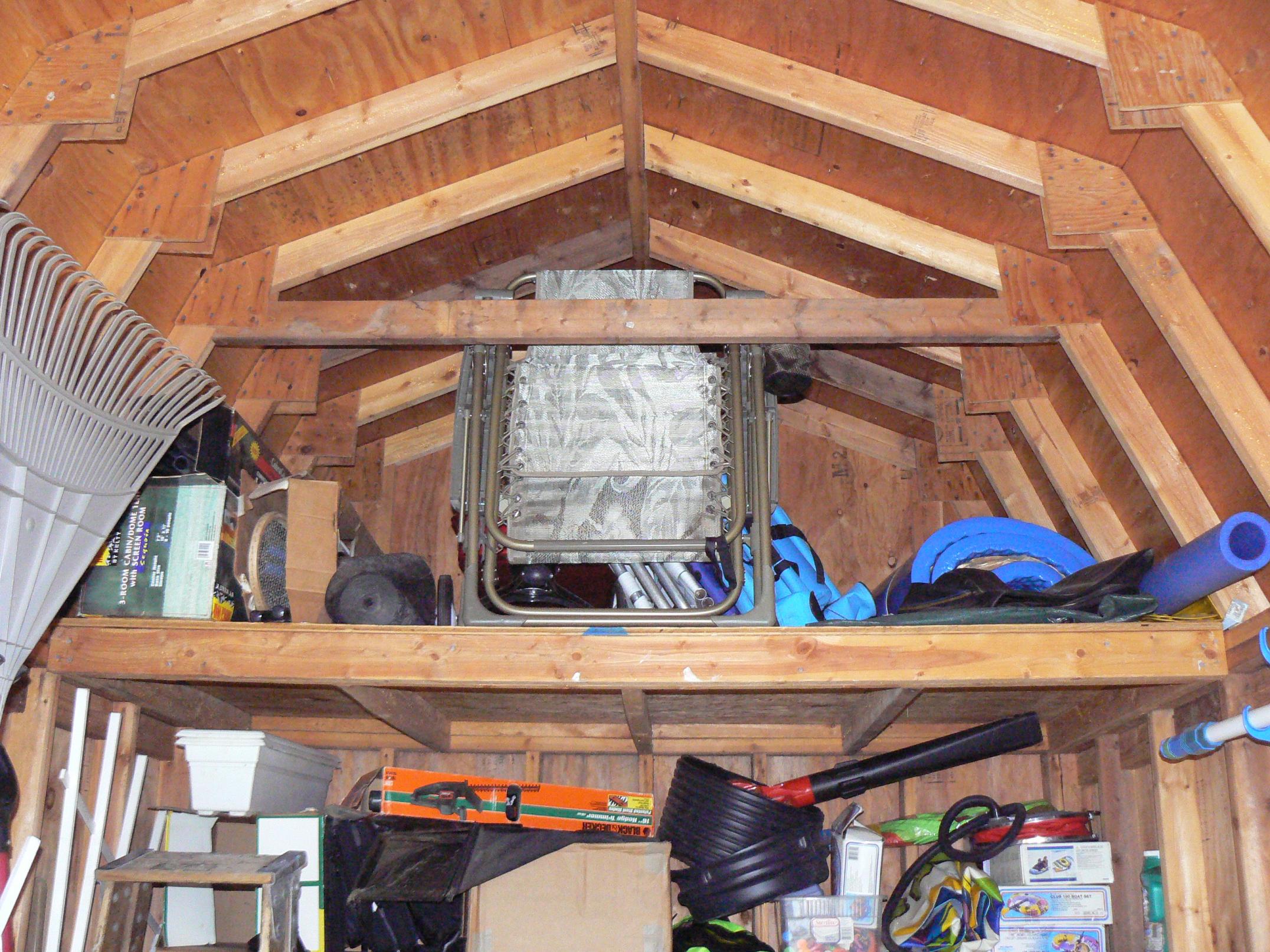

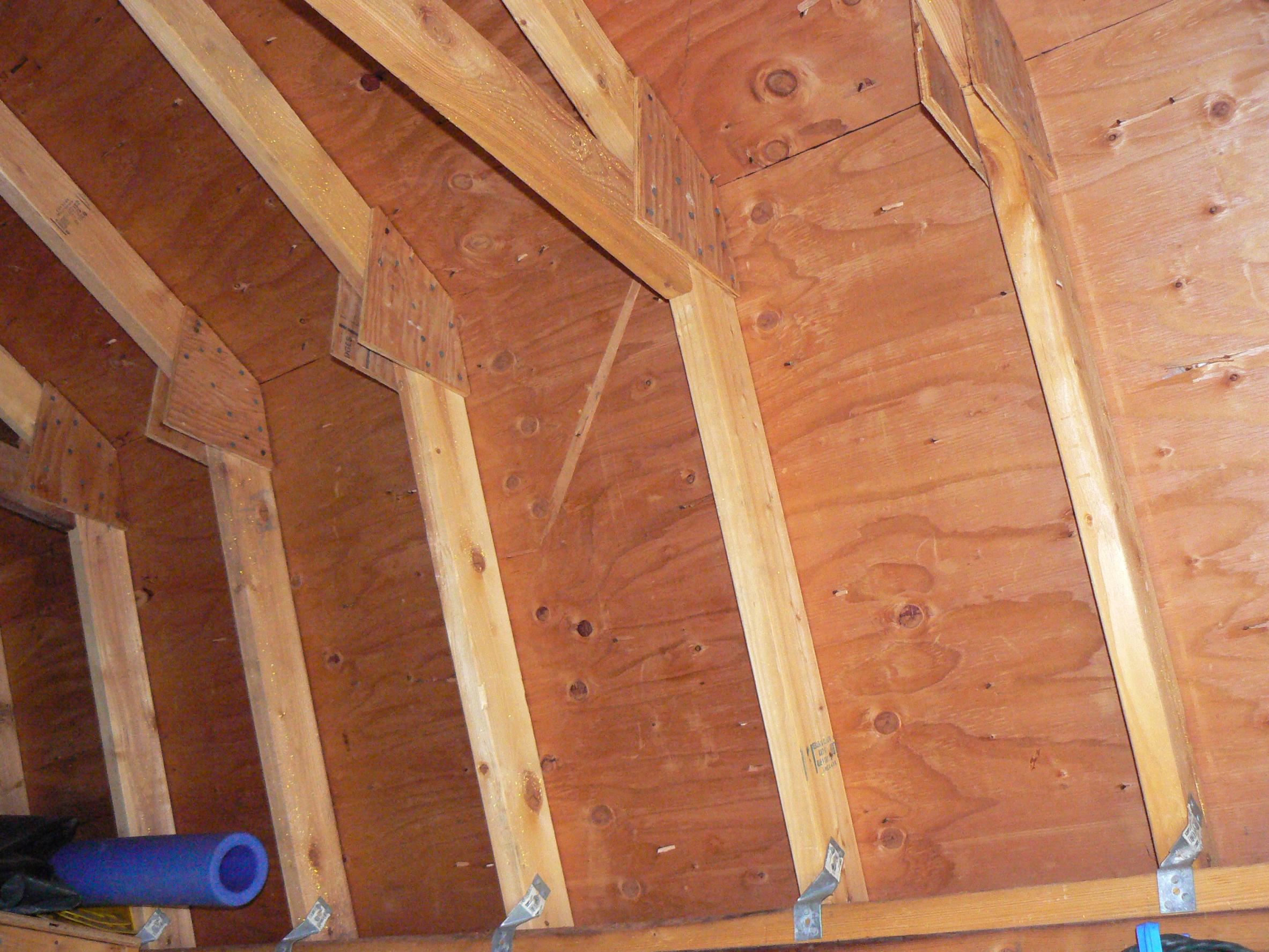

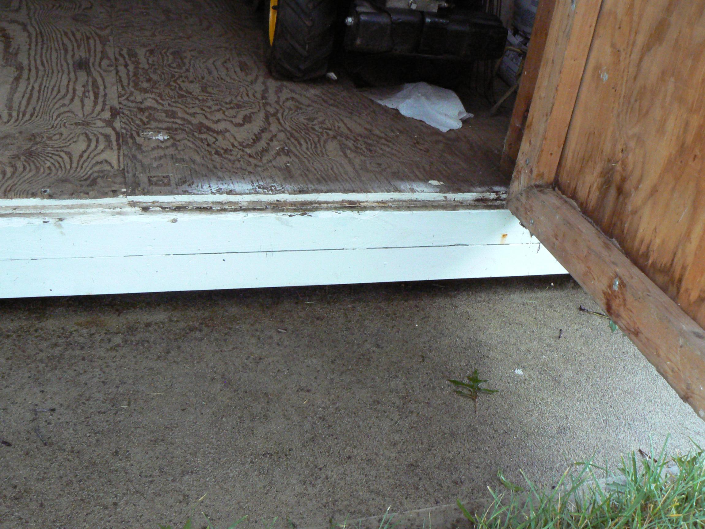

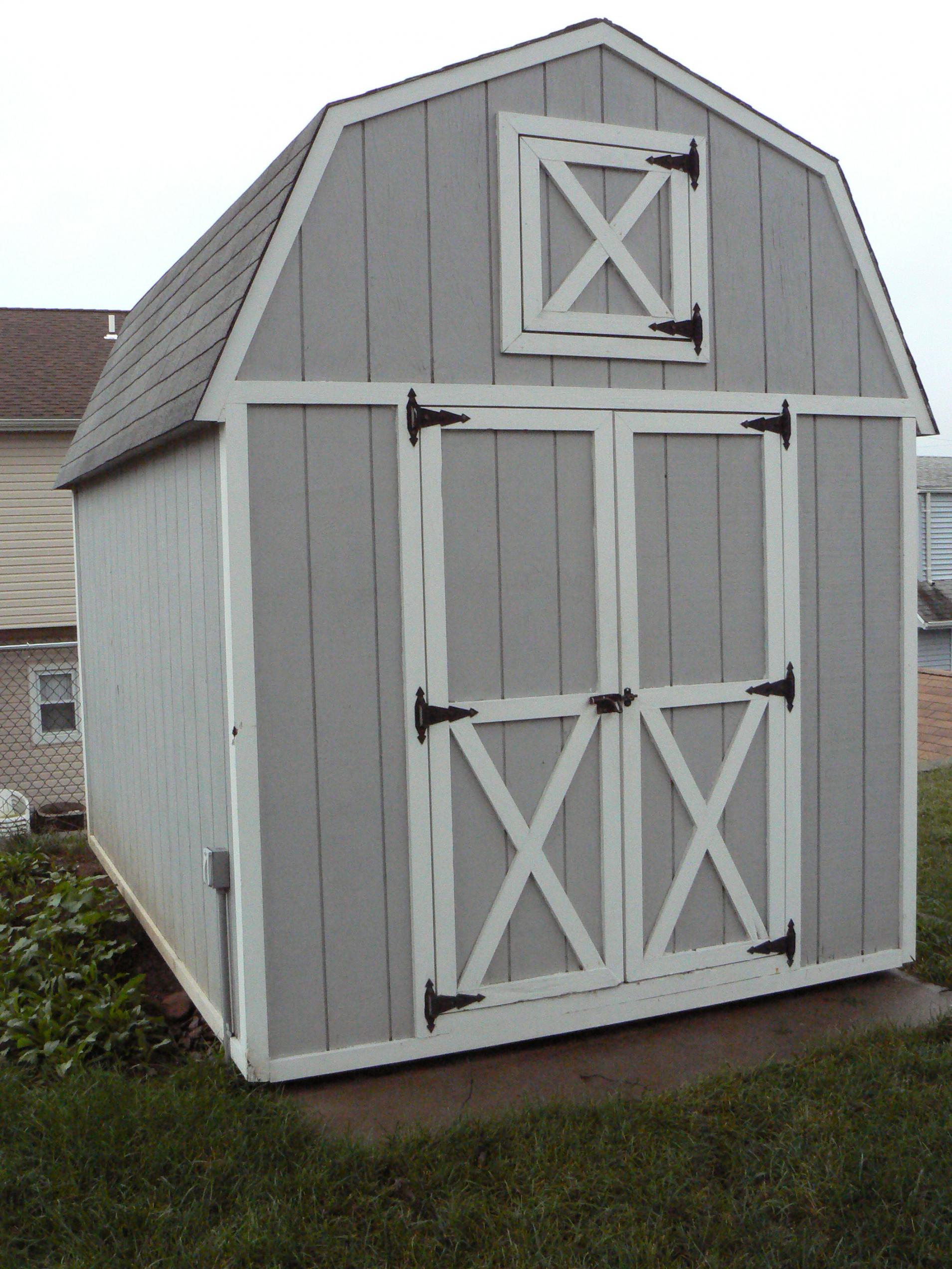

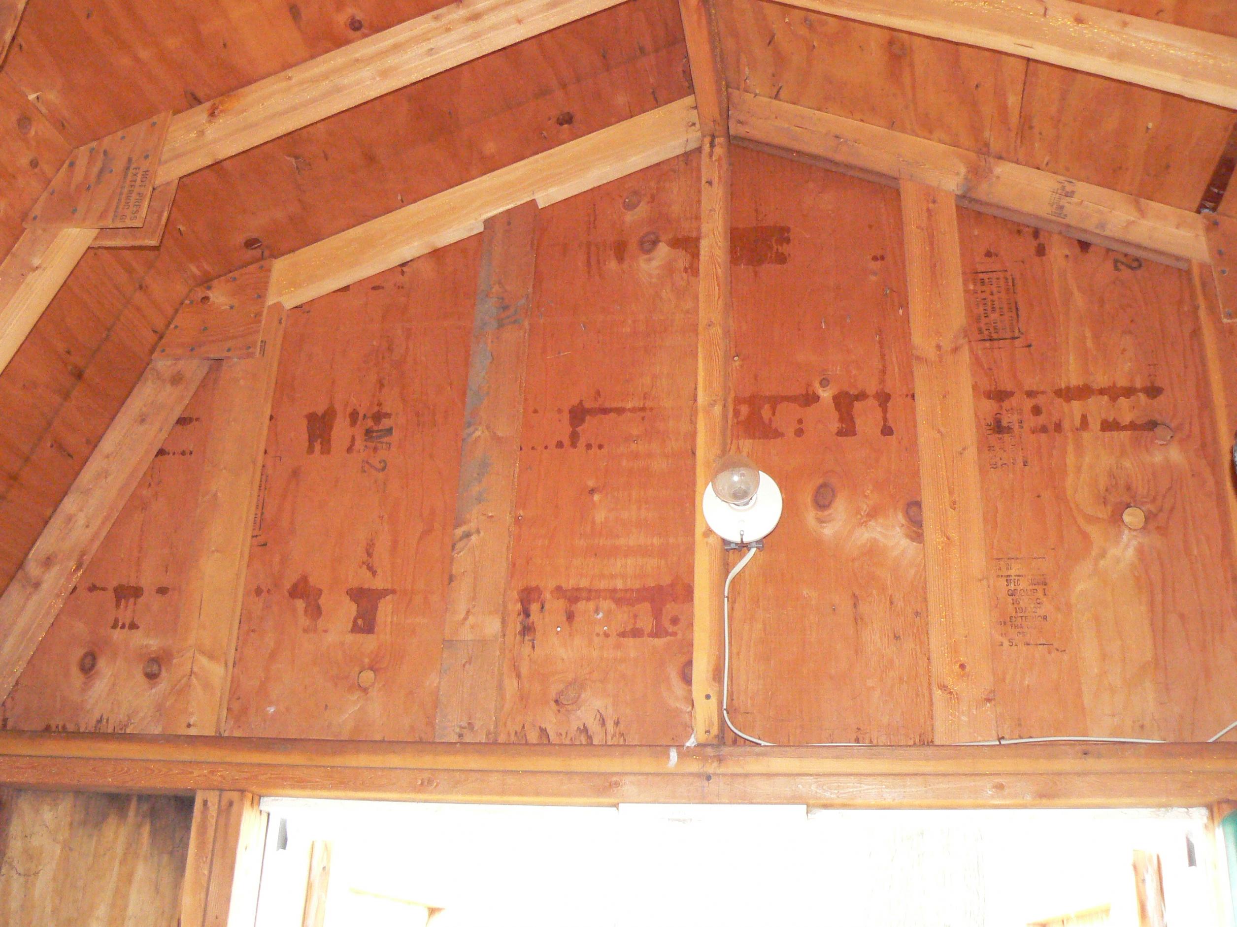

    Polkie, Here's some pictures of my 12yr old shed I built, and links to some how too sites. The Gambrel roof is not too hard to construct and the nice thing about building it yourself is you can modify the size and design to meet your needs. On mine I raised the walls to make a loft for more storage.
    My shed is 8'x12'x10' high and cost about $600-$700 in materials, and took me and a guy one day to build, putting the roof shingles on the next day. I set the shed on a concrete pad so the critters wouldn't make a home underneath it.

    wow looks really good and a great price...i dont think I have the skills to make one that nice...thanks for the help and info im gonna check those sites out ...I appreciate it alot
