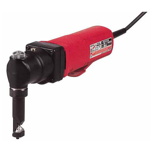

    Another alternative to a shear (and we use around here) is a "Nibbler".
    That nibbler pictured goes up to 16 gauge. The one we use will slide though 10 gauge metal like a hot knife through butter but will still make nice, clean cuts in thinner (22 gauge ?) sheet metal without bending/warping edges.
    We still have the original "blade" on the nibbler. We had to replace several jaws on Milwaukee shears (trying to cut through to heavy of metal) before we got the nibbler.
    With some experience, you can make some pretty decent circular cuts. It does waste about 3/8" of metal that it nibbles out, though.
