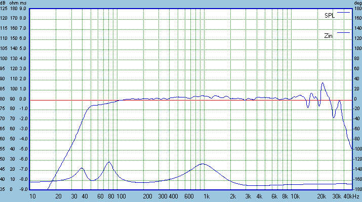

      I recently build a pair of ZMV5's.http://www.polkaudio.com/forums/showthread.php?t=74167&highlight=metal+mini+monitor
      They do some things very nicely but have one big shortcoming,they have great imaging like one would expect of a good point source ,very articulate midband ,and driver blending is spot on with no apparent lobing issues.They are quite detailed and maybe a tad on the bright side.They are rather unforgiving of poor recordings and the electronics upstream.
      The bad news is,while the bass response is impressive for their size the woofers can be overloaded very easily which makes them very restricted dynamically.Listening to bass heavy material even at normal levels will not be a pleasurable expierience as the little woofers will be hitting their excursion limits.
      IMO high pass filtering and using a sub is manditory if you are using them for hip hop monitoring.
