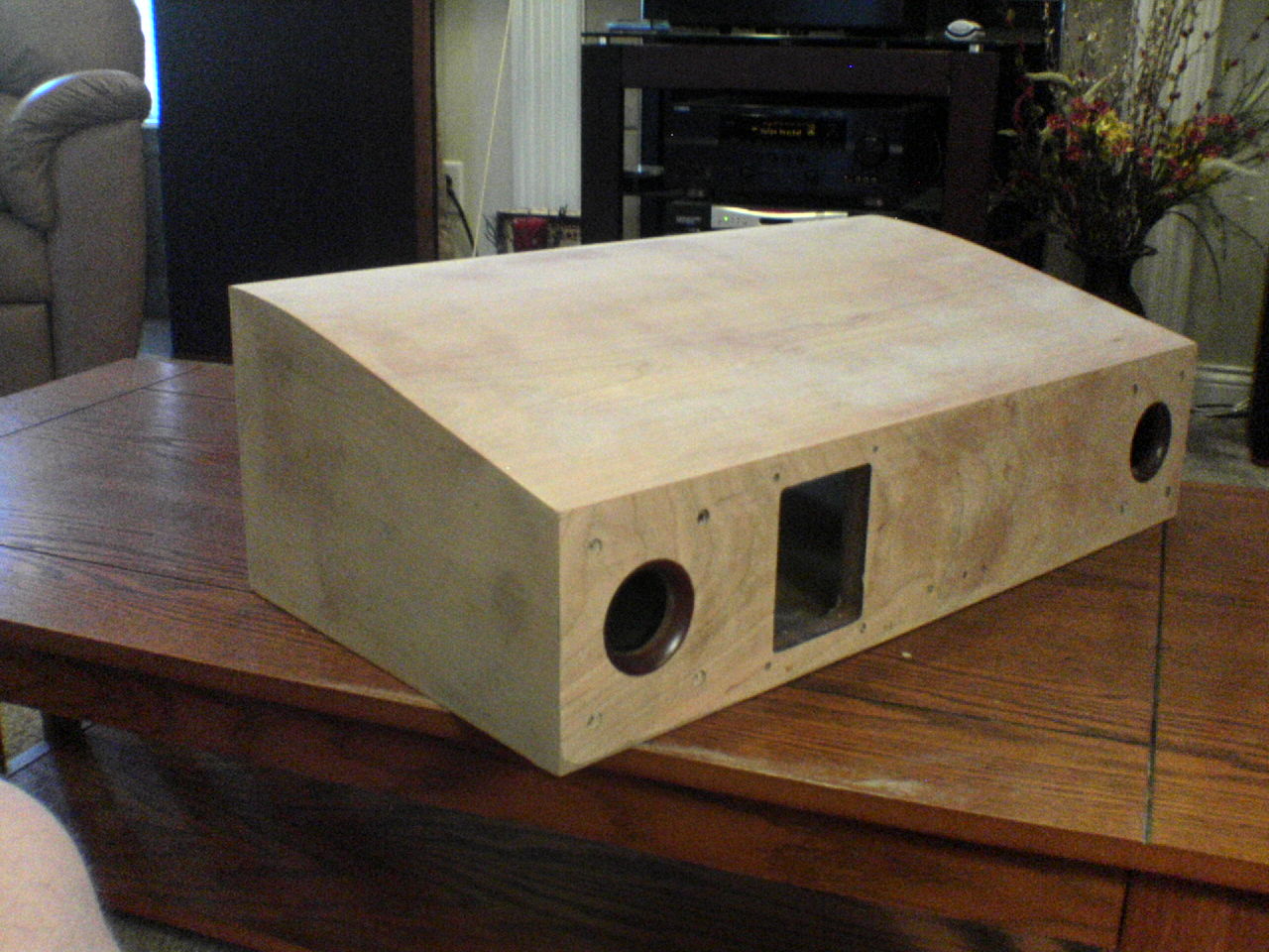

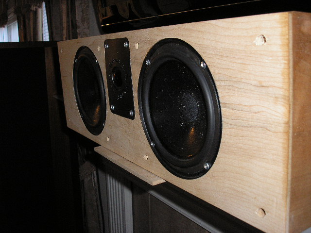

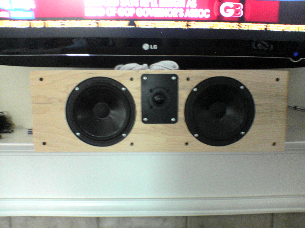

    Thanks Larry! Looks is one thing but sound is another. As I said, in an audio environment it sounds pretty good, but as a center for movies, the dynamics are terrible at this point. There is an audio repair shop that specializes in crossover setup here in town and it will be headed there in the morning.

    When I finish the cabinet off, I will be sealing one of the two ports on the back as it sounds much better that way, and I think once the mids are set at the proper crossover points everything will be fine.

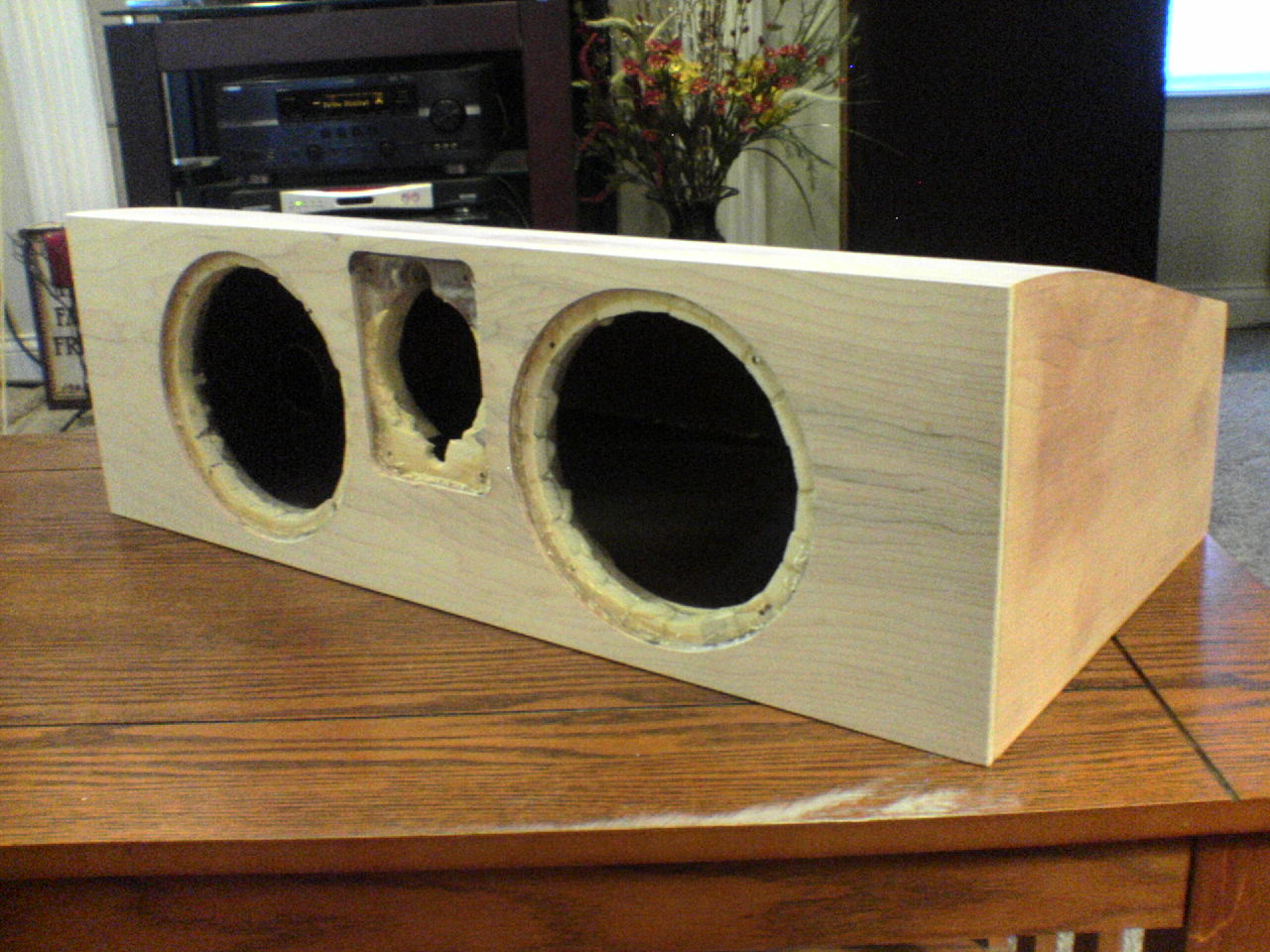

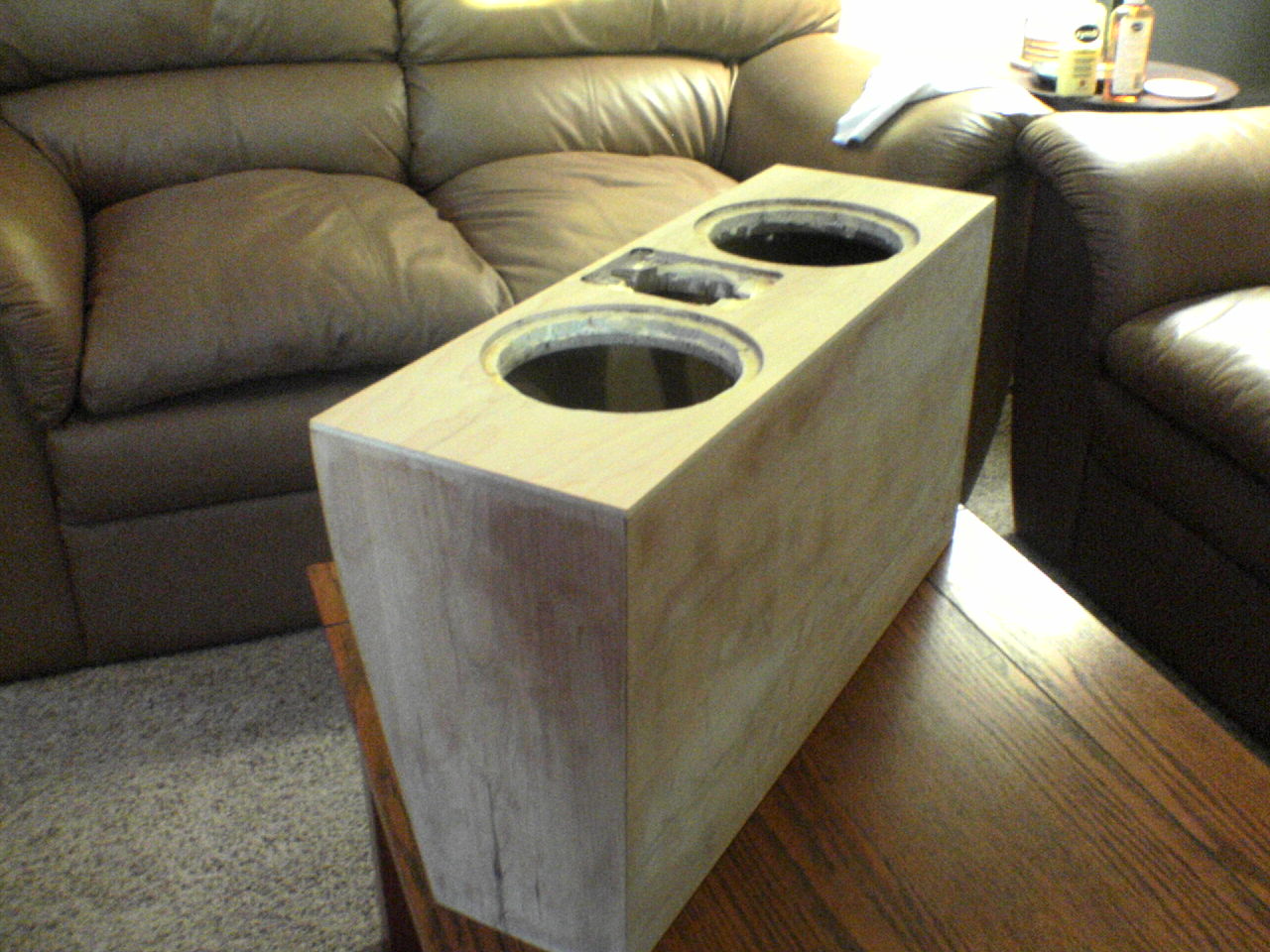

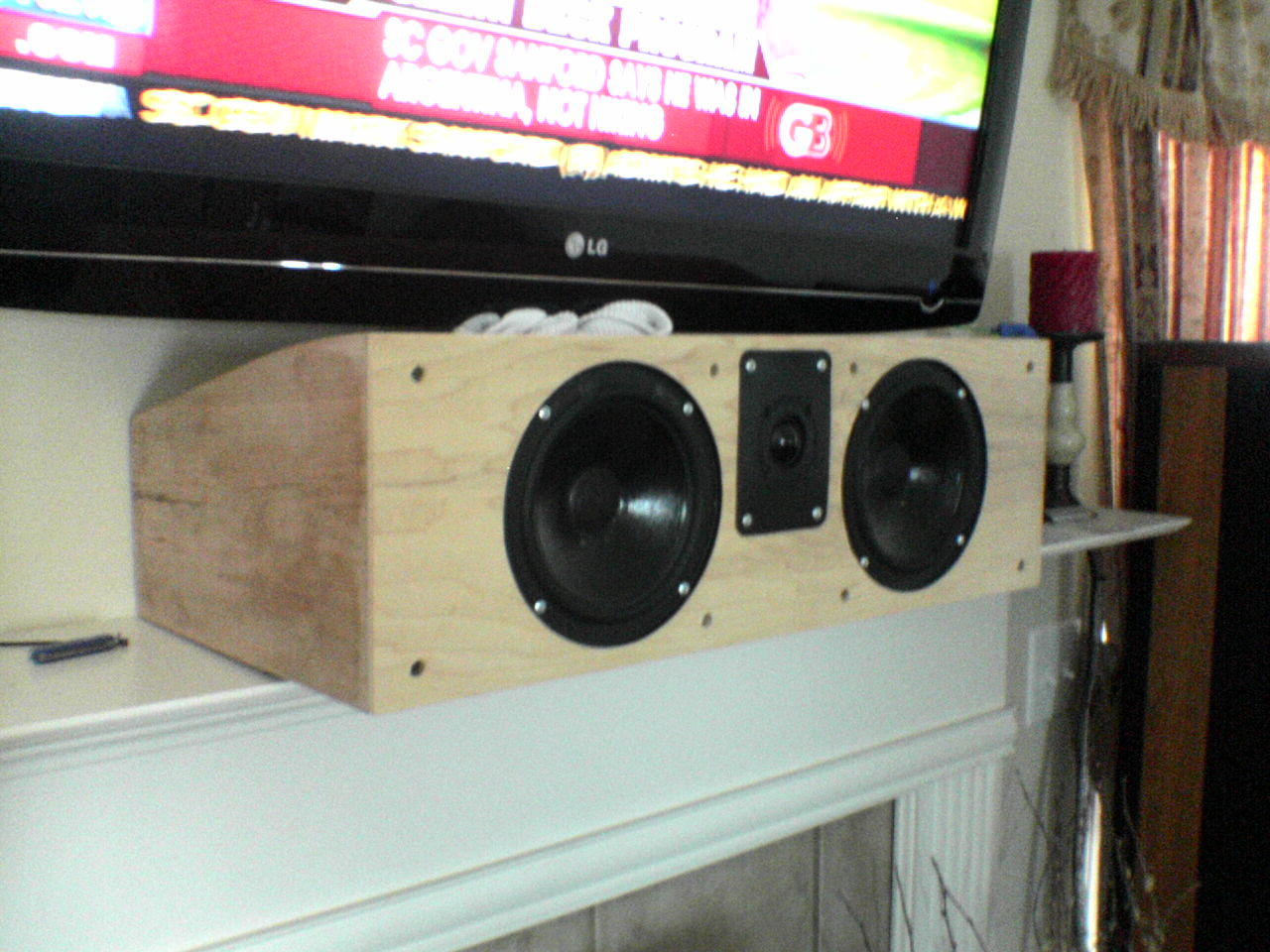

    I have taken the speaker to an audio shop here in town to work out the crossover bugs and will report back as soon as I get it back. I will provide the crossover values so others can try this as well... I also have an extra csi-a6 cabinet and some drivers...
    nooshinjohn Posts: 26,002
    edited June 2009

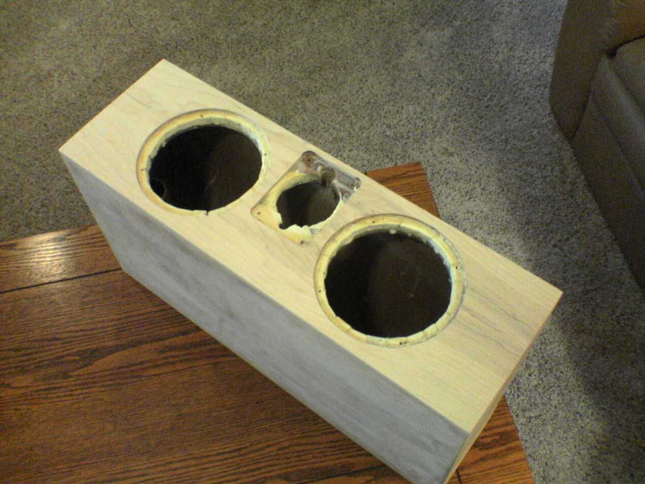

    I will have the center back in a couple days. The crossover was so far out of spec for this thing it isn't even funny. He did a volume measurement for the cabinet, researches the specs for the 1.2tl's, tested the drivers, and all the other stuff I don't have the tools to do. He says this thing should rock when I get it back. I will post a list of components when I get it back.

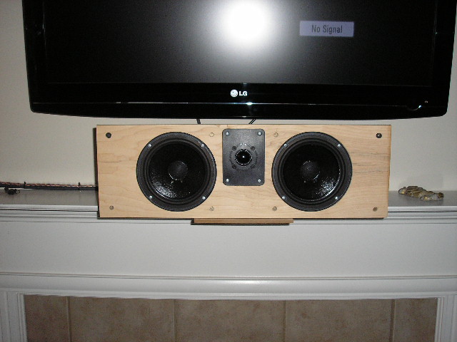

    6510's, they're used in the RTA8L, which is a ported enclosure like yours. They still may not be perfect, but a better match.

    I will look for a pair of them... The center is back at the shop already. He came and took it so he can work with it while I am out of town. I do not know what is in it yet.

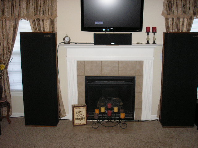

    John, I know it's probably been said, but what about changing the room around?
    That way you are not as limited. I struggled with my H/T room for 3 years, then I finally broke down and said...OK Everything is getting changed...it took a lot of work but my room is 100% better now.
    MOVE THE TV!
    ...and don't say you can't because you can.

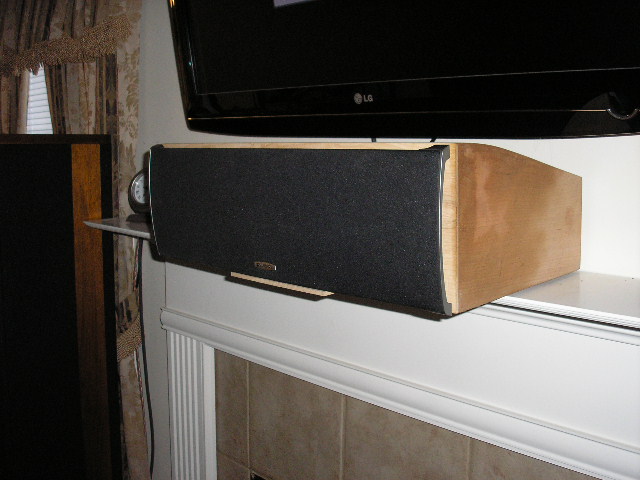

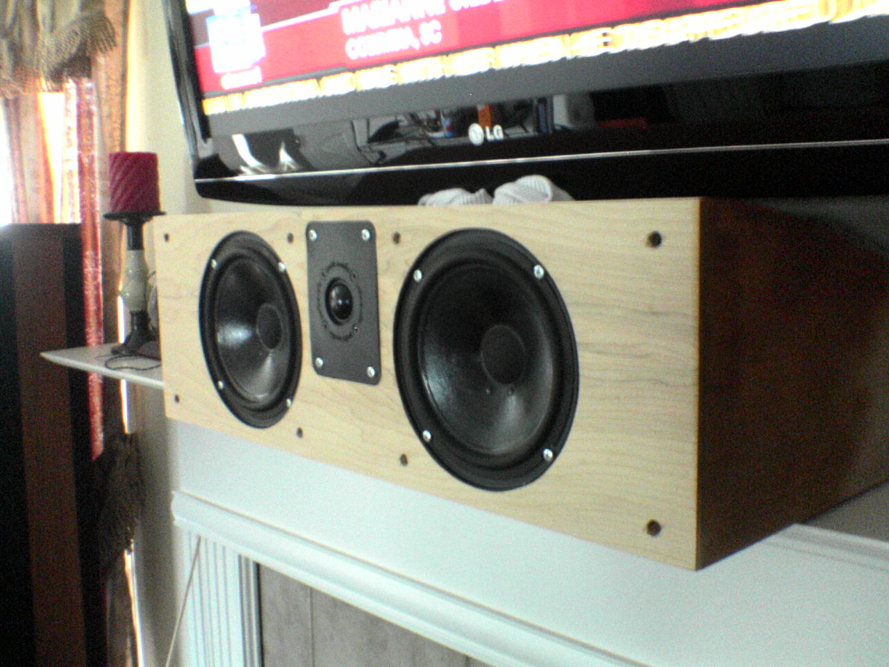

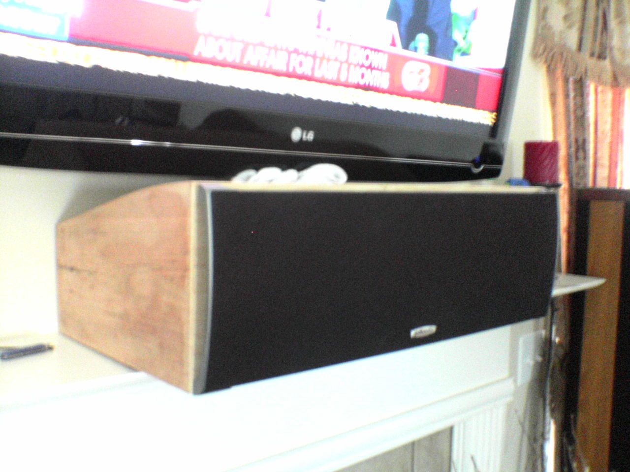

    I have spent the past couple days making adjustments and listening to the center channel and I am pleased to report that it works beautifully. Whether i am listening to the news, sporting event, or 5.1 audio, the center is more than able to keep up with the big polks, It is clear, dynamic and precise, and serves as an invisible bridge to left/right, and holds dialog locked in the center where it belongs. I will be happy to provide crossover specs and have a few extra parts around for someone that is wanting to try one for themselves. It will take about two weeks for me to recover the cabinet in walnut veneer and post up some pictures of the finished speaker, but I am so happy that I kept with it as it is worthy of being called an SDA Center channel...

    the key to it for me, is to have the center channel wrap into the left and right. It should almost not be heard at all. The reason I wanted to do this is to give the SDA's a more focused center point for tv watching and movies, especially for those that are outside the sweetspot, and so far it is working quite well. I am thinking of tweeking one of the drivers to deliver a bit more bass, but other than that, I really enjoy the sound. Having an RDO-198 delivering the highs really does provide the focus I have been looking for. I will post up some pics just as soon as I am able to finish the cosmetics, as for now it looks no different than it did a month ago.

    the adjustments have been completed with the speaker and the surround processor. I have been listening to various sources over the past couple days and I am convinced this center is just what I have been needing to effectively bredge the distance between the TL's in a 5.1/7.1 setup. The soundstage remains focused and dialog tightens up for movies, but it does so discreetly and without calling attention to itself. For music, it is both musical and detailed. I am very pleased with the results.:D
    So pleased that I am going to call it the CSRS 1.2TL;)
    I will post pictures of it when the walnut veneer is applied and the speaker is finished cosmetically
