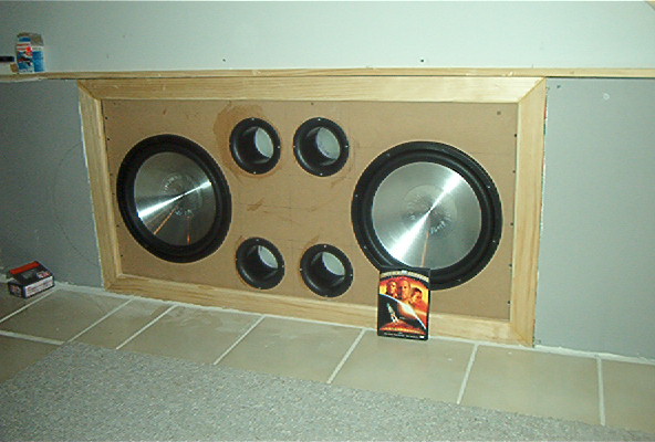

  • goingganzo
    goingganzo Posts: 2,793
    edited March 2003
    the pics are here.
    [IMG]http://C:\Documents and Settings\Bryan\My Documents\My Documents\Picture 2605.jpg[/IMG]
    the ports are 6 in wide and the trim is 2 and 3/4 wide
  • goingganzo
    edited March 2003
    the rrim will be black to match the other speakers and the mdfb will be a textured blackish color.
    the lines in the dust caps are bareley viseable olny in pics.

  • HBombToo
    HBombToo Posts: 5,256
    edited March 2003
    Nice work ganzo!
    I have to wonder how the the dry wall will stay together?
    HBomb
    ***WAREMTAE***
  • goingganzo
    edited March 2003
    actuley that might be a problem i cut out the botom plate and didknot replace it. i did a test fit of the box and havent been able to remove it. lol i will be adding some later when i bud a shelf over my sub.
