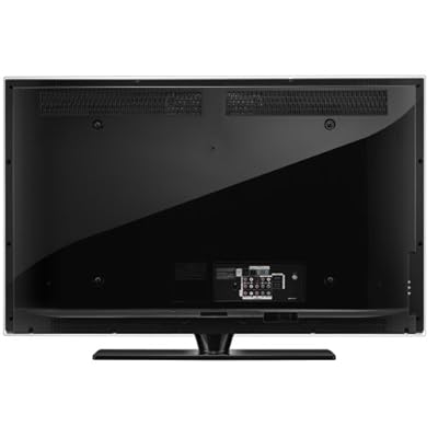

Wasn't sure where the best section for this topic was, so I figured I'd try here.
I have my system set up as follows......
...with the shelving about 13" out from the rear wall and the rear of the TV about 22" out. I'm getting some pretty substantial standing wave resonance back behind there at around 50-55Hz or so. It stands out and you can really hear/feel it when you put your head near or in that area while sound is playing. I was thinking of taking some corner bass traps, putting them together like so....
...and mounting that to the wall right behind the TV in hopes of breaking up some of those standing waves with that parallel area behind the TV. The whole thing will end up being 2-ft square and 1-foot out at the peak. Does this seem like something that will help? That's really the only sound resonance/peak that's bothering me about my setup. It's definitely coming more from the main speakers than the sub, since I've tried sine wave test tones through them separately....and I really don't want to push the whole thing back farther towards the wall for several reasons.

    Not trying to absorb it as much as maybe help break up the parallel facing surfaces. It helped a bit when I put a guitar case back there, but I can't leave my guitar case back there. We'll see....I might end up going that route anyway.

    The 'resonance' is actually in the 100-120Hz region. The 50Hz is obviously much lower and that's a slight boost in the room, but that's been tamed a bit with the BFD/ParaEQ on the sub. I was reading off the wrong numbers that I had written down while measuring. :eek:
    So yeah, that 50hz thing wouldn't be the whole TV/wall area, but at 100-120Hz, it should be within the reaches of some wall treatment back there.

    Whadyasay, how are you mounting your center over your tv? I am looking for some kind of shelf like that, but the back of my tv is straight down. It looks like yours might be too. I have a samsung ln46a630. Thanks.

    It's actually a combined TV mount/center mount that I built out of 2x4's and bolted down to that Salamander shelf. It ends up being two posts extending up behind the TV, and two 8" steel L-brackets that extend out over the top to support the speaker. Not the most elegant thing, but it does the job.

    That is very cool. I hadn't even thought about getting that involved with a bracket system, but have found no other satisfactory solutions. I will be studying that schematic!
    I used a basic standard plasma wall mount to attach to the wood frame. You have to do some pretty precise measurements to know how high the TV will sit when attached...at least I had to because I had less than an inch of wiggle room on either end. 30" high ended up being right on for the height of my TV, which is a 42" Panasonic, and the kind of shelf dimensions I was using. But with your Samsung which I assume is a 46", you better check the overall height and see how high the two tall posts have to be. I used two 8" brackets because I attached them after mounting the TV, over the back side of the posts. They only ended up extending about 4.5 inches past the front surface of the posts, which was pretty much the overall depth of the mounted TV, but I still had the full length behind to support the rear edge of the center speaker.
    The reason I even went this far was that the actual included tabletop stand for the TV was too wide to fit in that truncated space on the shelf by a whopping .25"! So i had to figure out a way of combining a new tabletop moiunt and speaker shelf in one. If you're still using your tabletop stand, you could probably rig up some sort of shelf support using the wall-mount screwholes on the TV itself. Something as simple as....
    Just find the right threading for your TV's mount holes, and go to a Home Depot and see if they have them in 3-5" lengths.

    The specs list that at 17 lbs, so it should be fine to mount on a simple shelf supported by the TV's wall-mount screws as discussed above. The only thing you need to be careful of is that the TV isn't bumped into and cause it to wobble back and forth on its stand. From the looks of it....
    ...that stand isn't the sturdiest-looking thing. You could also bolt some 2x4's down to the tabletop (if it's wood/MDF) behind the TV and extend some sort of support beam to the top of your tv to rest the speaker on....padded with rubber bumpers between the beans and the TV, of course. That way, only part of the weight is supported by the TV and stand, whereas the other is supported by the 2x4's in back, if there's room.
    Or...you could get something like this...
