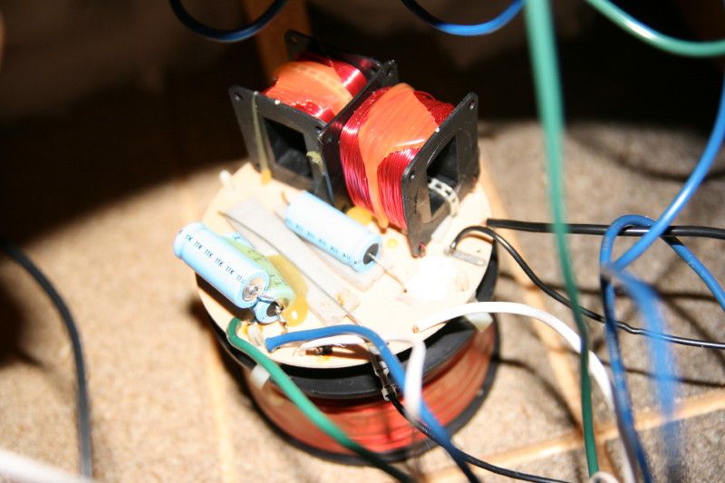

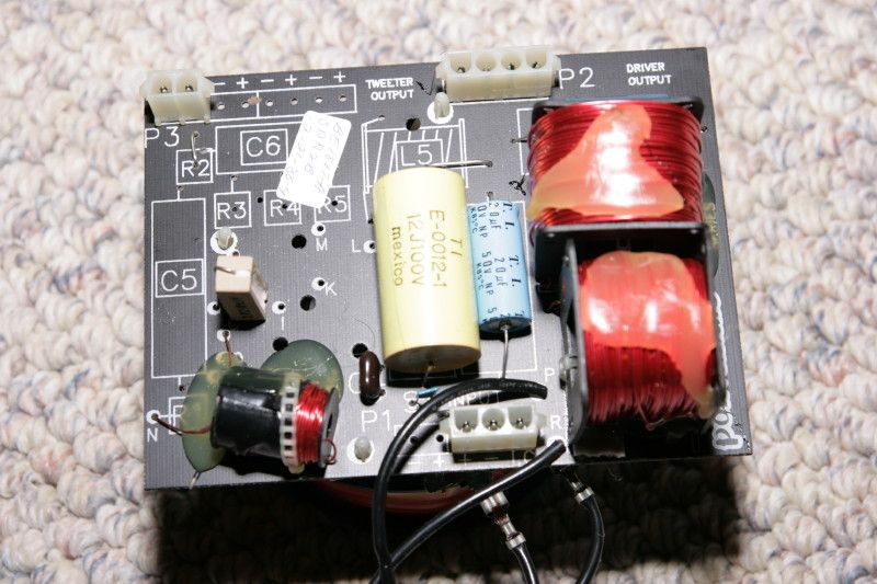

    here are some pictures and information...
    near as i can tell they were build in february of 1988 as indicated by the inspection marks on the drivers. the serial # for left is 8331/8271 right...
    both cabinet tags state sda1, and no reference made to a,b or c models
    the crossovers are quite large and rectangular in shape as shown in the pictures.... ok how the @#!$ do I upload pictures... they are all about 2meg and the system allow 512k. how do i get them into a submittable format?
    thanks as always:confused:

    Wtf, looks like a PB SRS2 crossover.

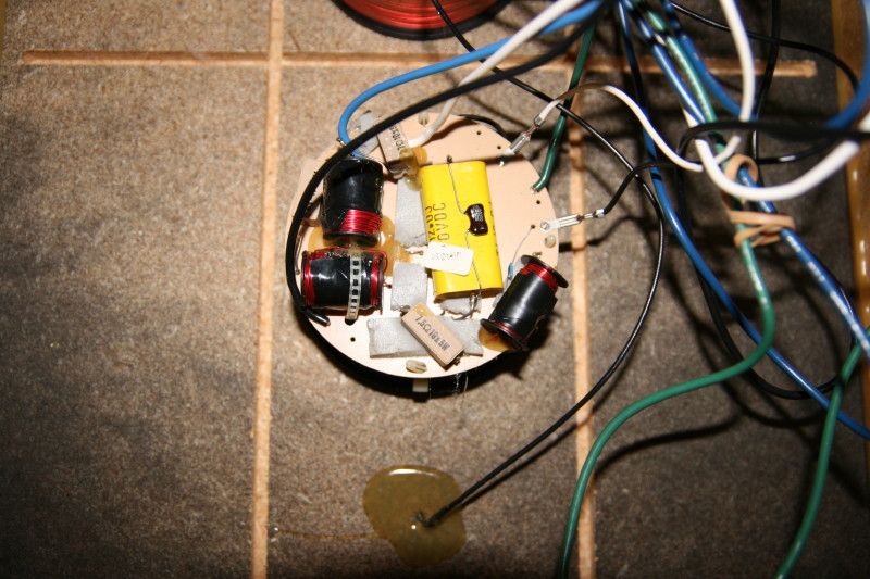

    It's definitely the same board as my 2B XO, although I see a cap in the C2 position, and resistors in R2 and R3 that aren't present in the 2B's. Here's one of the XO's I pulled from the 2B (before I started taking it apart):
  • nspindel
    nspindel Posts: 5,343
    edited January 2009
    Also looks like there are two extra inductors, one in the location where mine has a ceramic resistor standing up next to C5.
  • Face

    P/B SRS 2.
