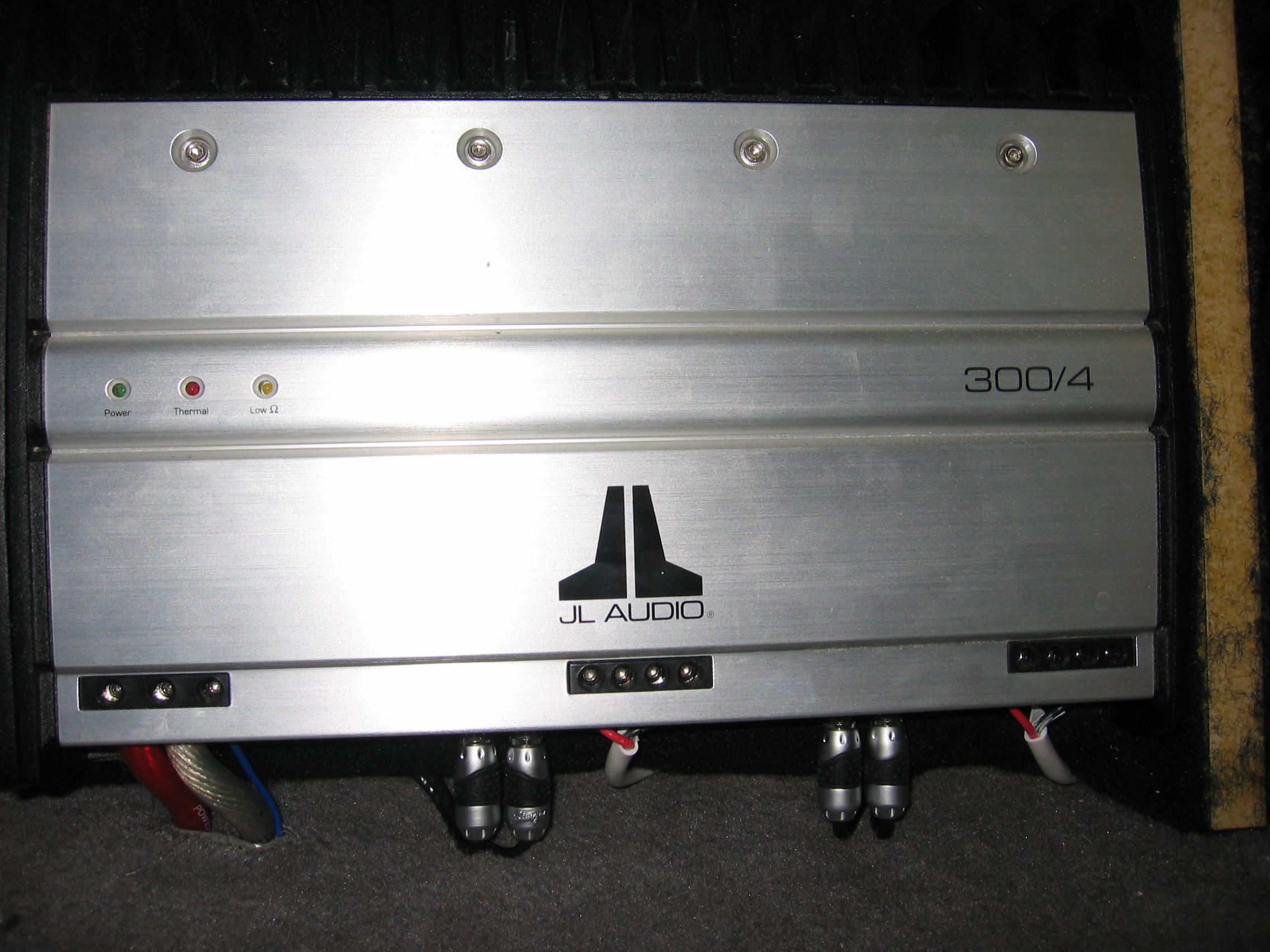

    I have a JL 300/4 Great x-over control for bi amping and over all sound quality. I had it bi-amped to my bostons for awhile, and than changed around my system again. If your interested hit me up

    heres the specs of the JL 300/4
    INPUT SECTIONS:
    No. of Inputs: Two Stereo Pairs (Front, Rear)
    Input Type: Differential-balanced with RCA jack inputs
    Input Range: Switchable from 200mV - 2V RMS
    to 800mV - 8V RMS
    AMPLIFIER SECTIONS:
    Amplifier Topology: Class AB with patented Absolute
    Symmetry™ dual N-Channel MOSFET output design
    Power Supply: Independent, pulse width modulationregulated
    switching power supply with multistage
    impedance optimizing circuitry.
    Rated Power (Stereo):
    75W RMS x 4 @ 1.5-4Ω (11V - 14.5V)
    Rated Power (Bridged):
    150W RMS x 2 @ 3-8Ω (11V - 14.5V)
    THD at Rated Power: <0.03% @ 4Ω per channel
    (20 Hz-20 kHz)
    Signal to Noise Ratio: >108.5 dB referred to rated power
    (A-weighted, 20 Hz-20 kHz noise bandwidth)
    Frequency Response: 5 Hz - 30 kHz (+0, -1dB)
    Damping Factor: >200 @ 4Ω per ch. / 50 Hz, >100 @ 2Ω
    per ch. / 50 Hz
    Slew Rate: ± 25V/μs
    FILTER SECTIONS:
    Front and Rear Filters (2): State-variable, 12 dB/octave
    Butterworth or 24 dB/octave Linkwitz-Riley low-pass or
    high-pass with continuously variable cutoff frequency from
    50 - 500 Hz, switchable to a range of 500 - 5000 Hz, via
    x10 switch. Defeatable.
    seen here bridged b4 I pulled it out
    link to the manual
    http://mobile.jlaudio.com/pdfs/Slash_amps/300_4_MAN.pdf
