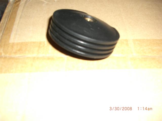

  • Posts: 3,066
    edited March 2008
    Send me a list of everything you need for the SRT.
    I have an SRT genie that will get me anything i need for the precious SRT.
    I had to refurbish my SRT and i was able to get all the parts i needed including a cracked foot.
    Carl I'll post a picture for the SRT foot for your viewing pleasure.

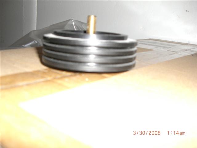

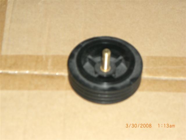

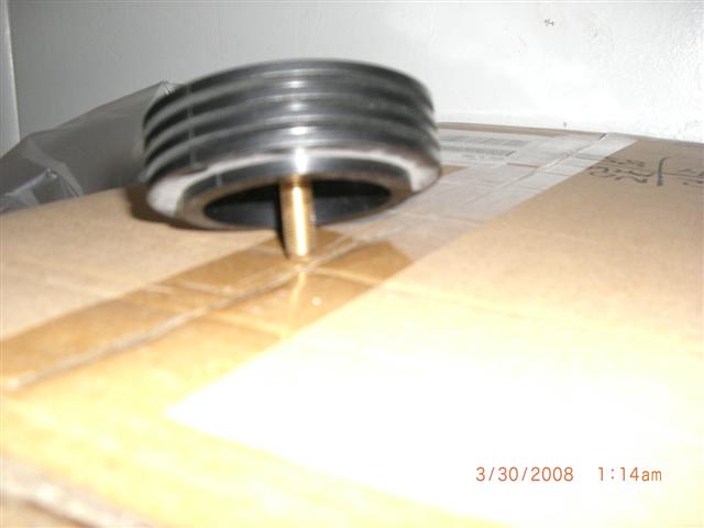

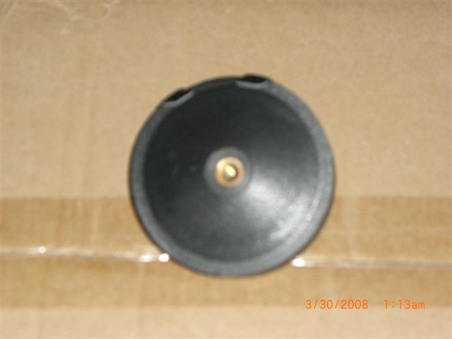

  • Posts: 3,066
    edited March 2008
    Here's the pics for the SRT foot:
