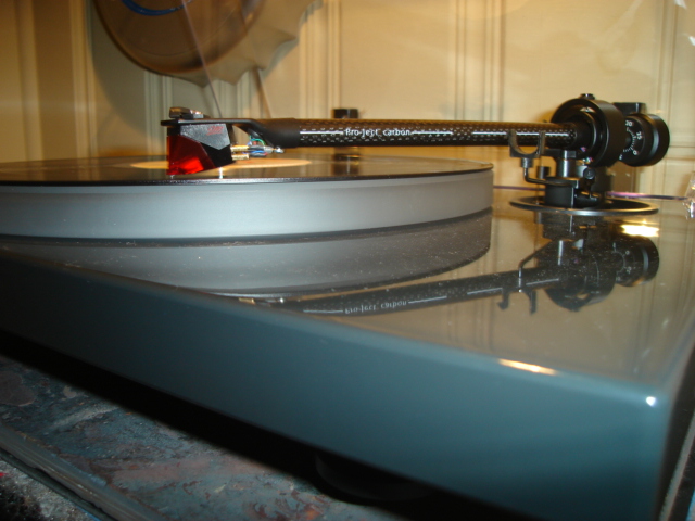

    Excellent question. I just got an acrylic platter for my Project and have found it sounds best without any of the mats that I have. Haven't noticed any damage so far, my thought was that if the platter's clean it wouldn't be an issue. The way Joe explained to me why an acrylic platter has an advantage is that the acrylic is very similar to the vinyl that the album is made of. In effect, the needle sees the album on the platter as one thick record. Of course, I've had my platter for, oh, about 2 weeks now; hopefully someone with more experience will chime in and either corroborate or tell me I'm full of ****.

    Acrylic with no mat is the BEST IMHO. Very little static generation also.

    Maybe the sound difference you are hearing without a mat comes down to the change in VTA caused by the needle dropping further down to the record surface? Has anyone made the comparison between mat and no mat whilst compensating for the VTA change?
    I say this as I placed an old record under the mat on my Thorens to adjust the VTA on my non-adjustable Rega RB300 arm. It made a very noticeable difference to the sound.

    Actually that would be an excellent point if you set your tonearm up with a mat in place then removed it.
    The reason I go with the record making intimate contact with an acrylic platter is explained in the second post of this thread.
    BTW that is a great work-around you've come up with for VTA adjustment with a fixed tonearm. Have you tried the SRA adjustment. That would seem more suited for a tonearm that is incapable of a VTA adjustment.

    He is talking about stylus rake angle. It is something that is not directly adjustable. It is controlled through a combination of VTA and VTF. The more VTF, the more the cantilever is deflected, thus changing the stylus rake angle.

    SRA (stylus rake angle) is acheived by increasing or decreasing your VTF (vertical tracking force) in increments or detriments of .1 gm at a time until you achieve the desired focus in imaging and depth of soundstage. It is much easier and more efficient than adjusting the VTA.
    I was a diehard VTA believer until I tried the SRA adjustment. I've actually increased the VTF up to .5 gm more than the manufacturer recommended. Harry Pearson of The Absolute Sound swears by that fact and has set his VTF up to .75 gm higher than the cartridge manufacturer recommends.
    Don't worry about record wear hear. Record wear is more a result of improperly set-up cartridges which cause tracking errors which cause record wear.
