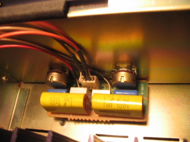

I think the static shock is coincidental to the problem. Most likely the gain adjustment hadn't been used for a long time and is causing the problem. Try rotating the gain knob back and forth repeatedly and see if the problem goes away. Cleaning the gain control with DeOxit is probably a good idea if you are comfortable doing it.DKG999

Well, I fiddled around with the gain knob last night and that did not seem to have any relation to the issue. When the amp cuts out, turning the gain knob up or down for the left channel has no impact. And when the amp cuts out it happens regardless of whether or not I have touched the gain knob.
I couldn't see any specific damage to the input jack for the left channel ... it was dark and I did not unplug everything to move the amp into better light, so there might be something wrong with the input jack that I couldn't see. I will unplug it and remove it from my HT stand to see if I see anything under better lighting conditions.

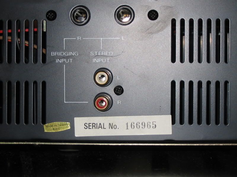

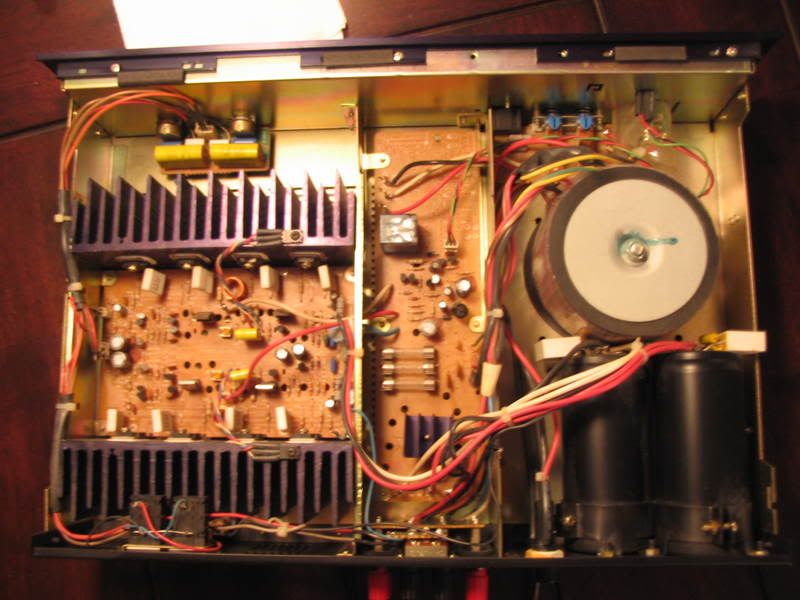

I opened 'er up and took some pics, and the only thing that looks weird to me (like I know what would look weird and what is normal!) is some blue goop that can be seen here:
Here are the other pics I took ...
Gain knobs from the inside:
L/R input jacks:
Top view:
Any ideas about the blue goop?My HT

Not sure what that goop is. was there any residual on the interior of the case on top where it vents? will the material clean up or is it baked on? the service tech is probably the best bet with regard to your sanity. finding a needle in a haystack is just that sometimes.[

Thanks guys for the info. There was no residual on the top of the case where it vents ... it was a bit dusty (as were other parts on the interior), but other than that it was clean as a whistle.
The amp has not gotten hot during the times I've used it, but I have not specifically checked one side vs. the other side to see if there is any difference in temperature. I will give that a shot this weekend to see if there is any difference from the left vs. right side.
Ben - I made sure that the amp was turned off for 48 hours before opening it up ... I've read about caps storing charges for a while after turning it off - I think it may have been from one of your posts, actually. Thank you for the warning.

The blue goop looks like manufactures goop that tells the manufacture if the transformer has been tampered with.. ie unscrewed...Monitor 7b's front

Well, I finally took it into the repair shop ... and a week later my wallet is $85 lighter, but I have a fully functional amp!
The repair guy said that a few of the internal connections (can't remember exactly the word he used) had corroded and needed to be replaced. He also said he cleaned the connections very thoroughly.
