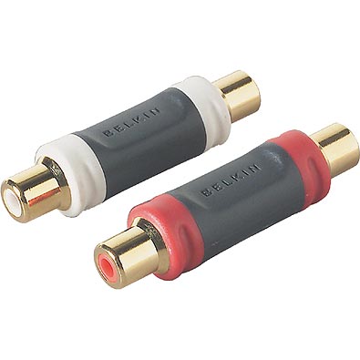

    the cables on the TT are only 2 or 3 feet long so i could not put the TT where i wanted so for now it sits on top of my pre. what is the best place to put it?Payton
    get yourself a pair of these RCA couplers.. it allows you to use another pair of interconnects on your turntable.. and it will give you a much longer cable. so you can move your TT where ever you like.
    It's best to keep it away from any amp and certainly away from your speakers. try and place it so it's not stacked on anything.. namely a pre amp.
    http://www.radioshack.com/product/index.jsp?productId=2477686&cp=&pg=2&sr=1&origkw=audio+cable+connectors&kw=audio+cable+connectors&parentPage=search
