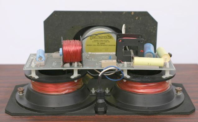

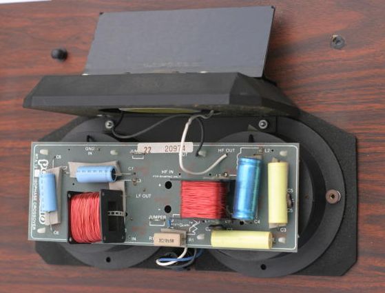

Does anyone have an idea as to which model (a, b, c) my RTA 12's are? Most of the RTA's I see use a fuse whereas mine has a polyswitch. The PCB has RTA 12 printed on it along with "ISOPHASE CROSSOVER". I'll try to upload some pics.

    What tweeter is on it? Are the serial number tags on back by the speakere posts?? Might be 12Cs keith

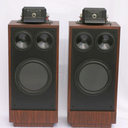

    I replaced the tweeters with the new ones from Polk. On the left of the posts it says SERIAL, and on the right there is a flat place where I assume the serial number was placed with a sticker. However, there are small plates on the rear, upper right corners with serial numbers R12 23424 AND L12 23456. There is a sticker on the left speaker, "LEFT CHANNEL". The one on the right side fell off.
    Here's two more photo's. I took a picture of the serial number plate but the numbers aren't visable.

    I've included some pics of mine, which are a funky RTA12 B/C hybrid. The back of my speaker cabinets say RTA12C & the PCB says RTA12B.
    & You'll see that the PCB (am I using the right term?) on mine looks exactly like yours, which suggests that you've either got 12B's or C's, or are pivilieged like me to have a funky hybrid!
    If yours have the built in speaker stands of about 4-5 inches of wood at the base, you can eliminate the 12A.

    BottomFeeder, Do your serial numbers start with L & R? Your speakers definately look my mine. I don't see an A, B, or C anywhere on my speakers. The PCB has a little white space, just like yours, right after the RTA12 but there's no letter in it. Either it wore off or there was never one on there.
    Yeah, I've included a pic of where mine are identified as RTA12'Cs (R12C & then the rest of the serial number).
    & OOPS! The hybrid versions that I was talking about were a minty pair that I almost bought this summer. They said RTA12C right where mine do, but RTA12B on the PCB. As with yours, my PCB just says RTA12 but w/no letter following.
