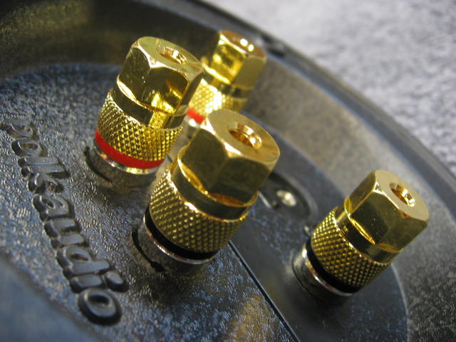

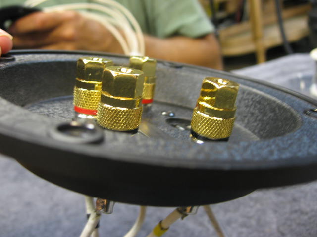

    Here are some pics of the Cardas post upgrades I did on my 1.2 TLs.
    A word of caution here; the shape of the Cardas mounts are like an oval with flat sides. The holes need to be drilled out, then you will need to file the backplate to the right shape.
    The Cardas posts are of excellant quality and very heavy and massive. These DO NOT have color coding. Jesse took some pinstriping and applied it to each post.

    Just a side note Roy, I don't know if the cost of the Cardas posts reveal the same in ratio to improvement in sound quality. However, I just couldnt' resist the quality, feel and look of them. I know for a fact now that I am getting very solid connection with these posts. . . I didn't have that confidence in the stock posts. . . quite the contrary, I didn't feel the stock post had a good electrical connection.

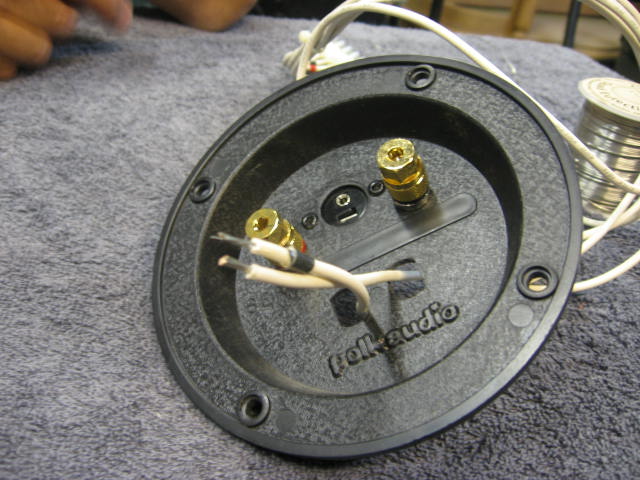

    Those look just like the 3.1's post setup. I see you just cut the lugs off the wires and soldered them on. Which set of post is better? ie Vampire, Cardas, etc...

    No, believe it or not the internal wire is a very heavy guage and held up pretty well over the years.

    Those look just like the 3.1's post setup. I see you just cut the lugs off and soldered them on. Is on set of post better then the next? ie Vampire, Cardas, etc...
    Yes we cut the lugs off and soldered them. You have to be careful here because when you heat the posts, they get really hot and because of the mass, stay very hot and can melt the backplate therefore, when doing the soldering to the posts, it needs to be done rather quickly.
    As far as one manufacturer's post being better than another, it is a preference; there are some here that love Vampire. I use vampire for bananas and spades but I prefer the Cardas posts. However the Cardas are expensive. I got a discount on the 10 Cardas posts & 10 delrin seats. I believe it was $160.

    Anyway, adding to Joe's excellent posts and nice pics. When soldering the wires to the posts, run the wire thru the hole and solder it to the post without the post mounted in the hole. This will prevent the HOT post from melting the plastic binding post plate. Also, make sure you have the washer and nut on wire before soldering the wire to the post or you'll have to do it all over.
