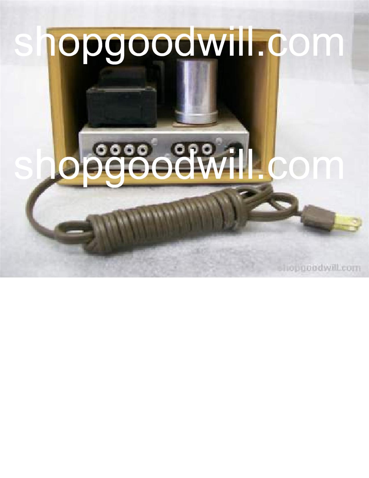

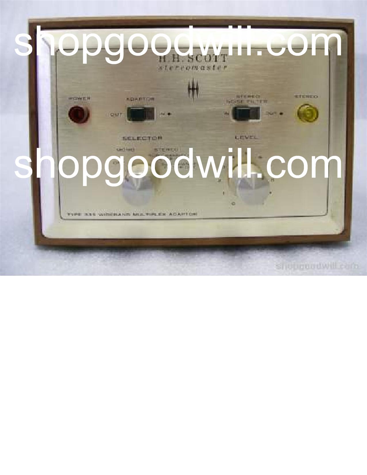

Just happened to stumble across one of these and have no Idea if it is an amp or what. Was wondering if anyone knew anything about it and if iT would be worth picking up? I googled it and found no information. The unit features five tubes. The two of thetubes are marked "ECF80" and "ECC82/12AU7".

    Here ya go, http://hhscott.com/300-rf.htm and http://hhscott.com/cc/fm_multiplex_stereo_decoders.htm
    Certainly something for a collector, but not much use for it today.

    Thanks F1 your the man. Good will also has a stereo tube tuner on their auction site from Scott. if any one is interested.
    It's very much still useful today, as it will allow one to use virtually any of the many excellent mono tube FM tuners (many still fairly inexpensive and wonderful sounding) to listen to MPX stereo broadcasts. As long as the tuner has a detector output, the decoder should work with it. Scott should be a good one.
    Besides the Scotts and the McIntoshes (the Marantz 10B was already MPX stereo), a personal favorite line of FM tube tuners includes the Sherwoods, which have decent sensitivity and selectivity, and sound really wonderful. I use an S-2000 AM/FM (mono) in my living room hi-fi.
