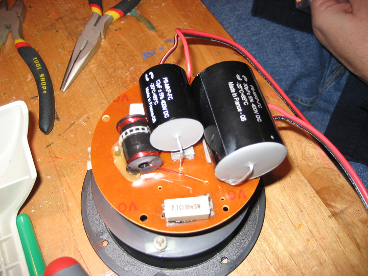

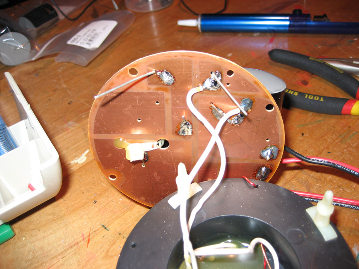

    I should be getting my new tweeters for my 5B's and was wondering if I should replace the wire inside the cabinets, looks like the original is about 20 gauge, would 16 gauge be better? Also does a person have to upgrade the X over. I will be sealing the speakers to the cabinet, right now I have the tweeters (peerless) out of my Advance Speaker Korp. A+, which I want to return to working order again. With my M500t Carver thet are one sweet sounding speaker.
    heiney9 Posts: 25,592
    edited August 2009

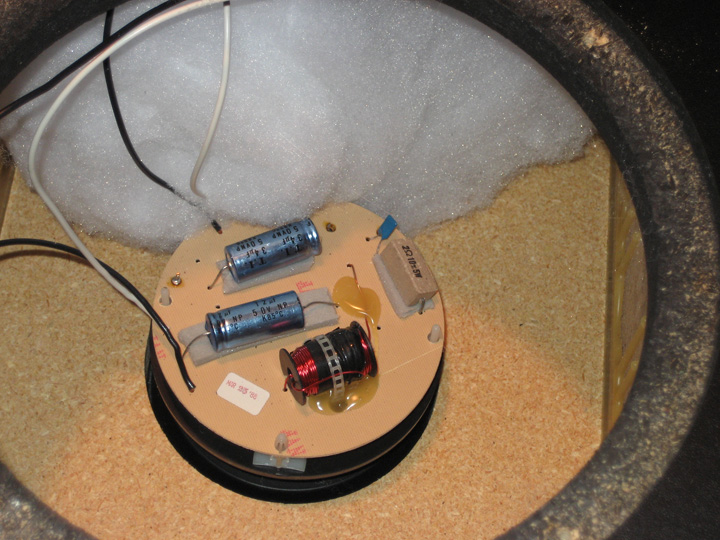

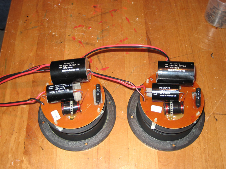

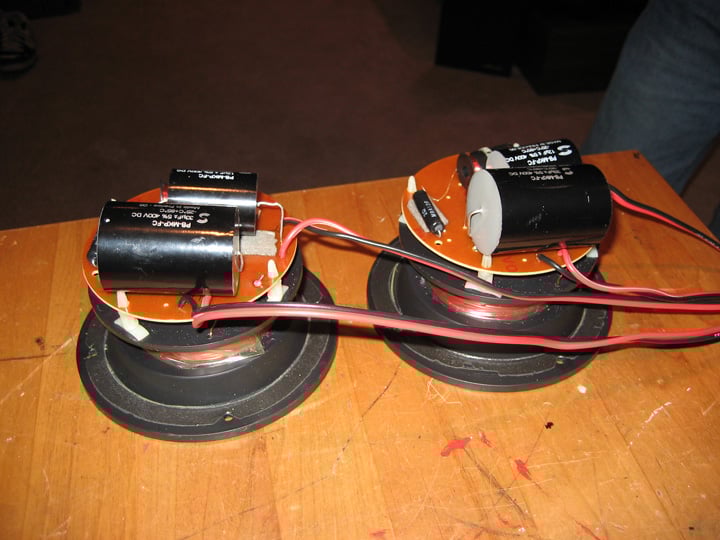

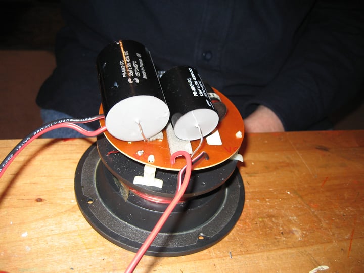

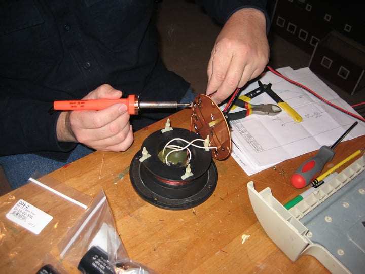

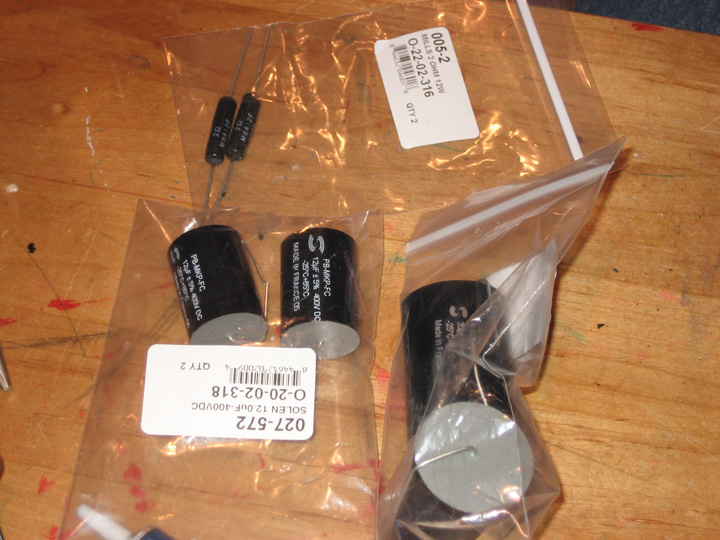

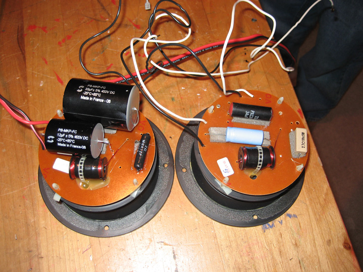

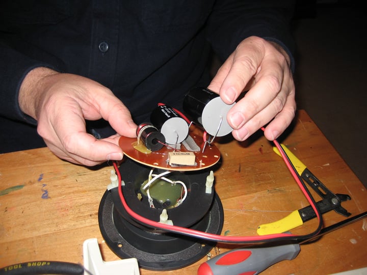

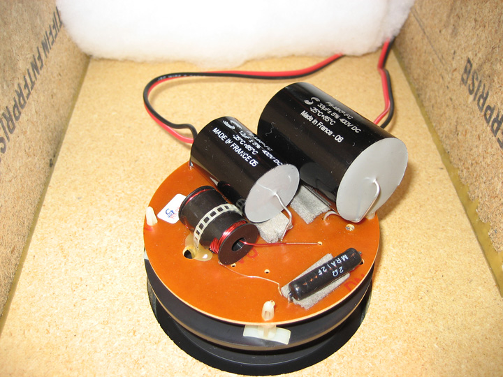

    Tonight a friend helped me swap out the Solen Fast Caps in the high pass part of my 5B x-overs. I put in Clarity Cap PX series caps as well as bypassing the fuse which protects the tweeter.
    I obviously only have a few hours on them, but I notice two things
    1) much smoother highs although right now they are a bit blurred (should clear up after break in) less "shouty" in the midrange.
    2) much less soundstage height and width, which I'm sure will improve with break in. The depth seems to be there on the same familiar recordings, although it could and should improve.
    I'll update in a week or so.

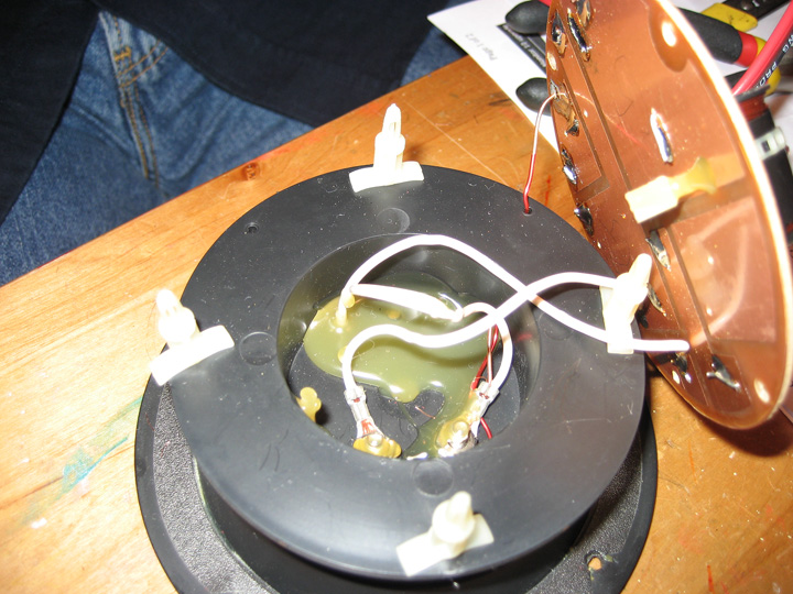

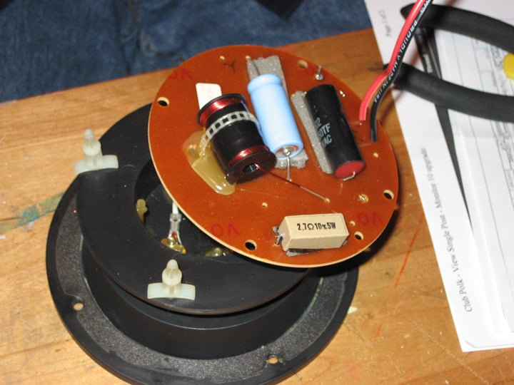

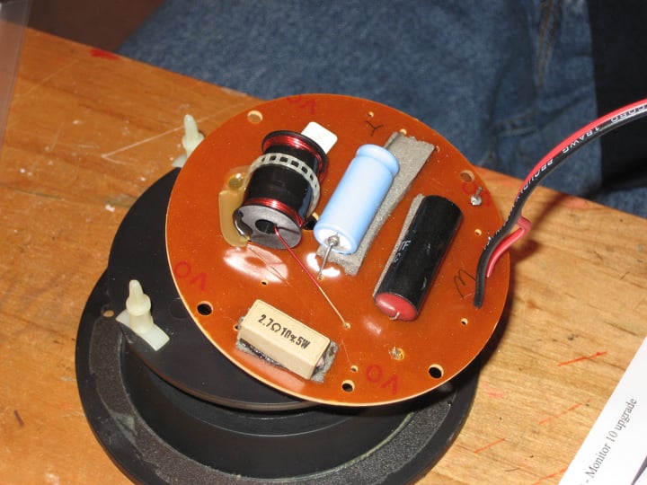

    In August I replaced the Solen Fast Cap in the high pass with a Clarity PX (blue) and I have to say after break in it is much smoother, more open and detailed than the Solen. Here's a pic
    Tonight I decided to use rope caulk (Mortite) in place of the foam/paper gaskets to get a better seal between the baffle and the drivers. I did the RD0194-1 tweeters; MW 6502 midwoofers and the 8" passive radiators. This was a practice run as soon I will be doing my 1C's.
    I went to Home Depot in search of the Mortite brand, this was all they carried in the store here in IL. It's the same as Mortite.
    All 3 drivers with Mortite (rope caulk). Don't forget to remove the old gaskets first
    Pretty easy to do. Before I tightened the screws I applied even pressure on the outer edges of the drivers to "seat" the caulk then I carefully tightened the screws diagonally.
    I'm listening to the 5B's as I type, I'll follow up as far as improvements in sound I notice.
