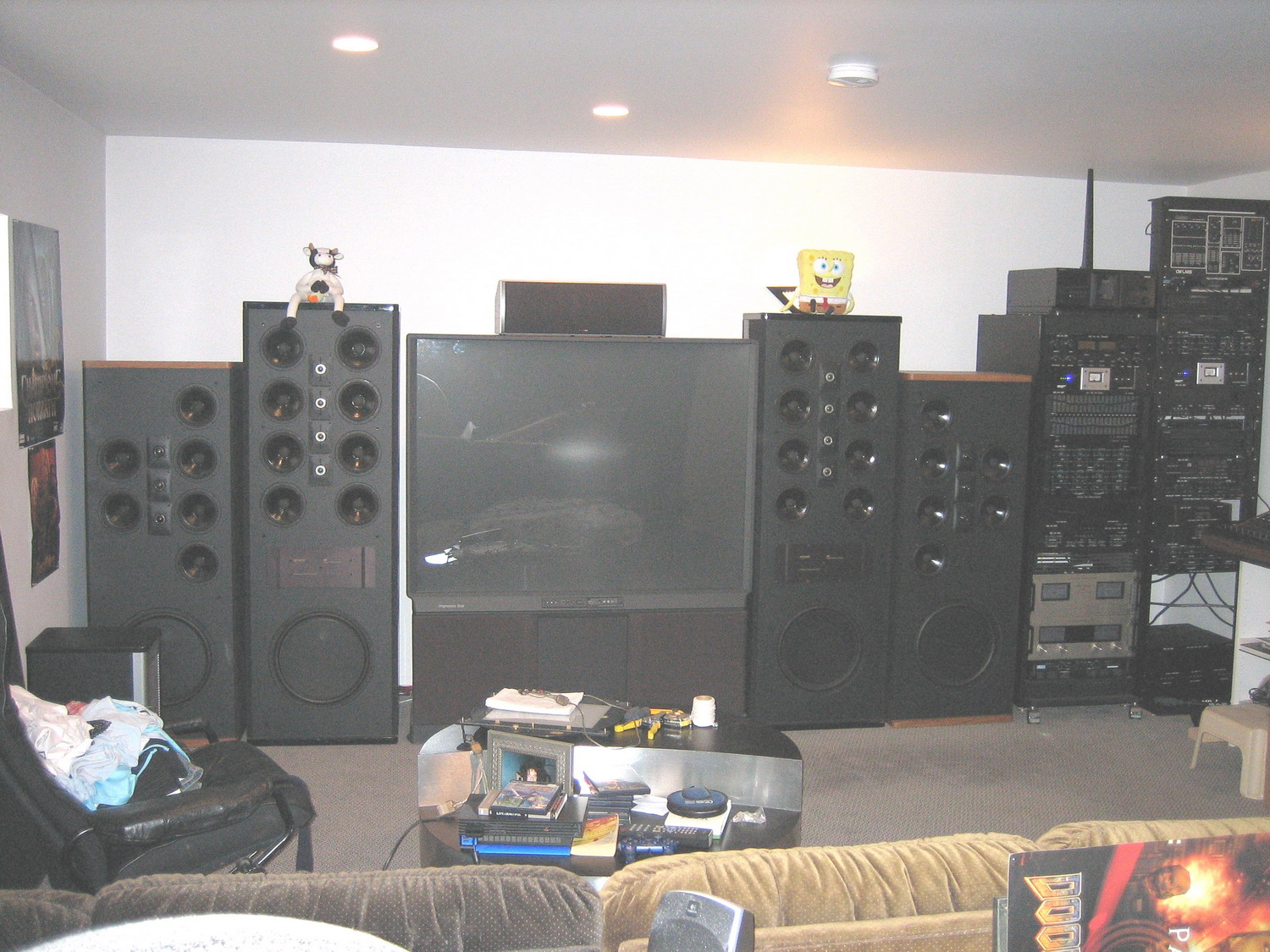

    Ok, here is a pic of my setup (assuming it worked).

    Ah cool, it worked. The audio rack on the right has a large opening because it's still missing 2 amplifiers...one to bi-amp the 2.3's and one for the rear speakers.
    1st rack from the bottom.....Samson s-1000 amp, Phase 700B, Phase 400, SAE electronic crossover, SAE 100 wpc, SAE parametric eq, SAE graphic eq, Monster 3500, SAE pre-amp, Sony cdp.
    2nd rack from the bottom.....SAE 300 wpc (2 open spaces) SAE parametric eq, ....and a bunch of other stuff, some of which is not used and will be removed once I finalize everything.
    Amplifiers: 1-SAE Mark IV, 4-SAE 2400, 1-SAE 2500, 2-SAE 2600, 1-Buttkicker BKA 1000N w/2-tactile transducers. Sources: Sony BDP CX7000es, Sony CX300/CX400/CX450/CX455, SAE 8000 tuner, Akai 4000D R2R, Technics 1100A TT, Epson 8500UB with Carada 100". Speakers:Polk SDA SRS, 3.1TL, FXi5, FXi3, 2-SVS 20-29, Yamaha, SVS center sub. Power:2-Monster HTS3500, Furman M-8D & RR16 Plus. 2-SAE 4000 X-overs, SAE 5000a noise reduction, MSB Link DAC III, MSB Powerbase, Behringer 2496, Monarchy DIP 24/96.

    Now we know your issue, you're sucking up all the stray EMF from the universe with all that gear.:(

    You know, I always envisioned heaven looked something like that......
    Only with lots of micro-brewed beer and sexually adventurous women as well. :D

    Where's the dance floor??? Just kidding :D:) . Nice, very nice.

    Spongebob is the man:eek:

    Joe, what the hell happened to that TV in your picture????
