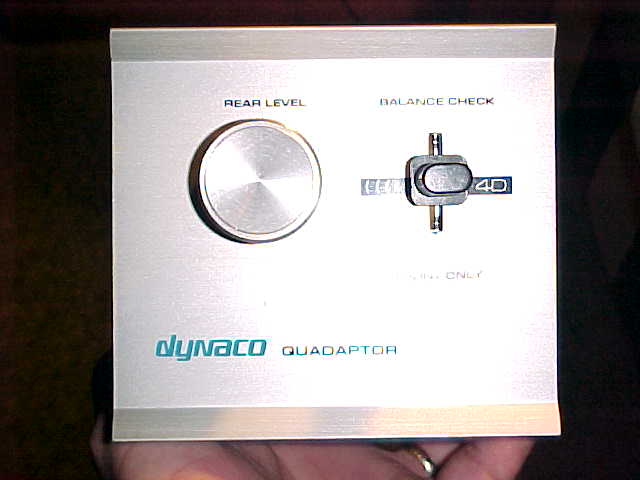

    Freakin' kids. A 4 channel receiver is indicating to me that it is in fact an old surround sound receiver. You think surround sound happened with Dolby Surround? Some of the earliest surround receivers go back to the late 60's.
    Quadrophonic - Kind of a catch-all name started way back to indicate a system that was more than just two channel. The 4 channel systems could be comprised of Discrete 4 channel sound. Yes girls, 4 DISTINCTLY different channels of sound. It required a 4 channel receiver with discrete capability, a turntable with special cartridge, or a reel to reel machine with 4 discrete channels. There were pre-recorded discrete 4 channel tapes, and the turntables required specially pressed discrete 4 channel vinyl.
    Some different systems were called SQ, QS, Matrix, and then my all time favorite, Hafler DynaQuad. 73-75 is too early for Dolby Surround.
    More later, I'm at work. By now they don't actually expect me to work if I'm not flying, but I try not to rub it in their faces.
    If that is an old KLH 4 channel receiver, and it is affordable, buy it. Those mid-powered KLH's have some of the SWEETEST 2 channel sound you're likely to come across in a receiver. The most powerful KLH was about 30wpc if I remember correctly.
    George Grand (of the Jersey Grands)

    In my opinion, Hafler DynaQuad was the only halfway realistic surround sound from that era.

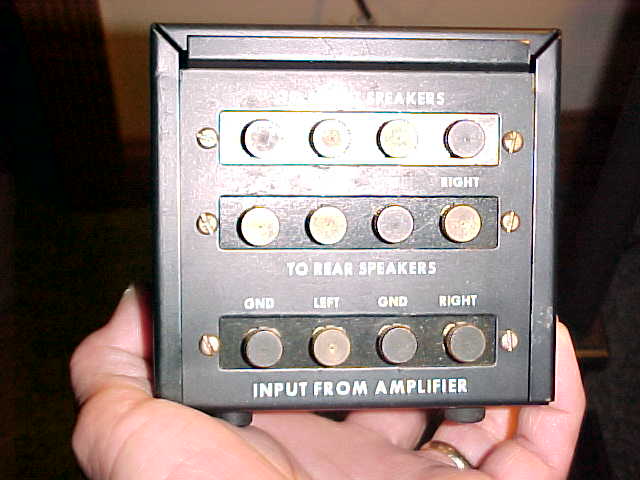

    DynaQuad did not use the rear channels as discrete, separate channels. They were used as ambience channels, and could really come very close to imitating the original recording venue. The back channels were also dissimilar, and therefore, STEREO. Even Dolby Surround was mono to the back channels, using amplitude and phasing to try and move sounds from side to side in the rear.
    Hafler DynaQuad was built into quite a few receivers. KLH and Sherwood immediately come to mind. There was also a stand alone outboard DynaQuad decoder available from Hafler (Dynaco), called The Dynaco Quadaptor. I still have one. It could be added to ANY stereo receiver, or power amp. I think it was recommended for only up to 100 watts, but that didn't stop me from using one with my Carver "150" Receiver (157wpc) to drive 4 Polk RTA 11T's from around 1989-1990. Sounded GREAT! Here's a picture.
  • George Grand
    George Grand Posts: 12,256
    edited February 2005
    A technical error has occured. That is my "Gorilla Playing a Set of Drums" alarm clock. Here's the Quadaptor.........
  • George Grand
    ****-end......
  • George Grand
    It was a passive device, detracting NOTHING from the front channels. Cool man item if there ever was one.
