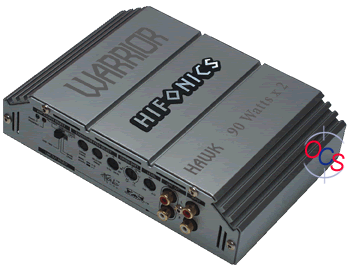

    For an amplifier, I'd get this 2 channel instead of the other 4 channel.
    http://www.onlinecarstereo.com/CarAudio/ProductDetail.aspx?ProductID=13985
    That is another Hifonics amp from thier Warrior series and it's quite small but big in power. These amps are re-releases from when Hifonics really started getting big in the early 90's. These amps are what Hifonics built thier name on. I had this Hifonics Warrior Hawk and I loved it! If a 'friend' hadn't stolen it from me, I'd still be using it.
    So far, amp and speakers are at $180.
