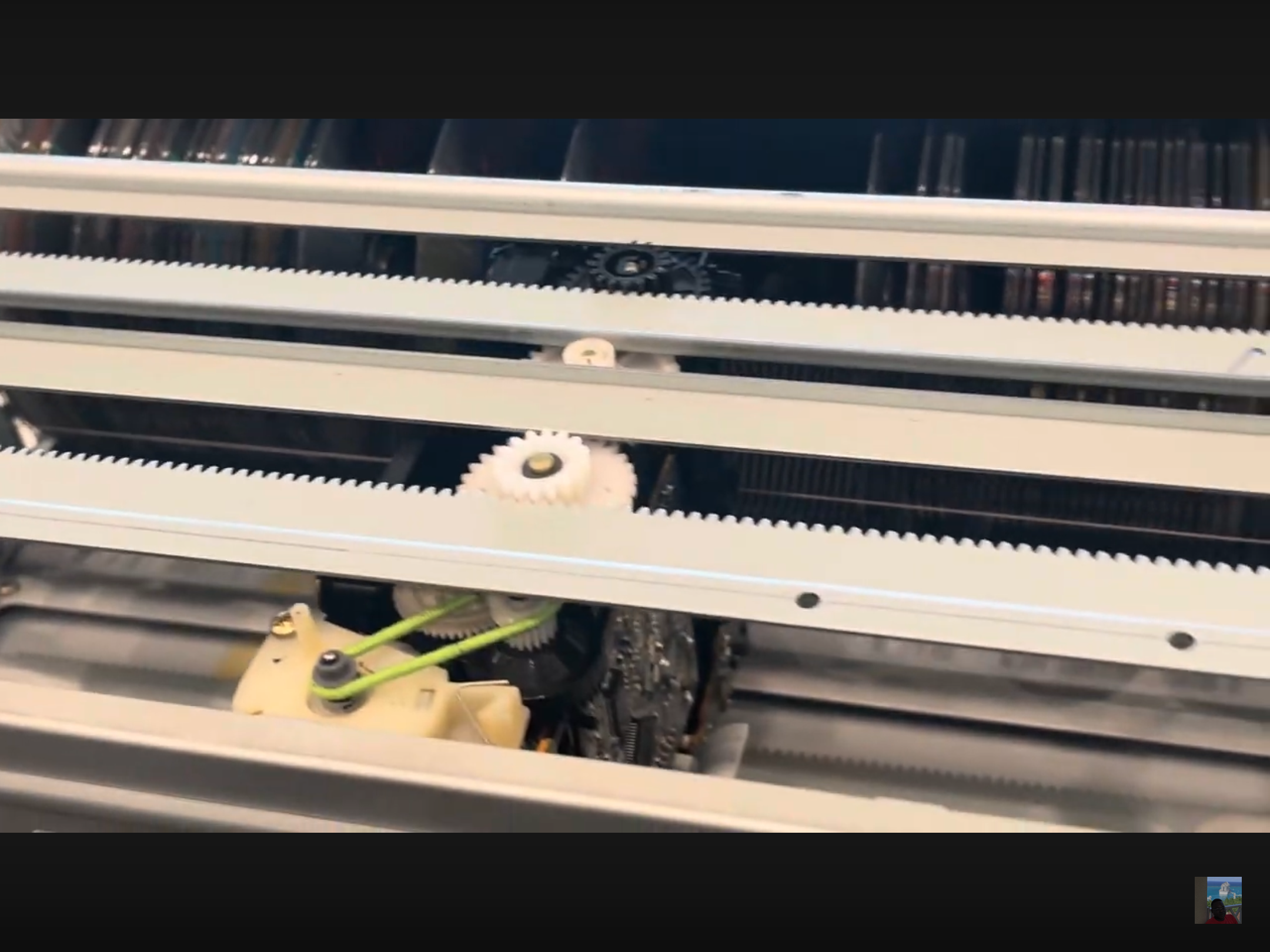

    Easy fix. Undo the screws. 5 on back, 2 each side. Take off cover. Note at back of player the cd carriage. Will slide sideways. Clean old rubber left behind from the drive belt over the small motor. (Use alcohol wipes) Replace with 23mm O Ring. Stretch between motor and capstan. Replace cover. Plug back in and reload all your 110 cds! Unless there is a major malfunction your machine will be fine.
  • Mephisto
    Mephisto Posts: 2
    The one I found on YouTube was green, I used a black rubber O Ring. About 3 cents worth. 7dr6ueq189fo.png
