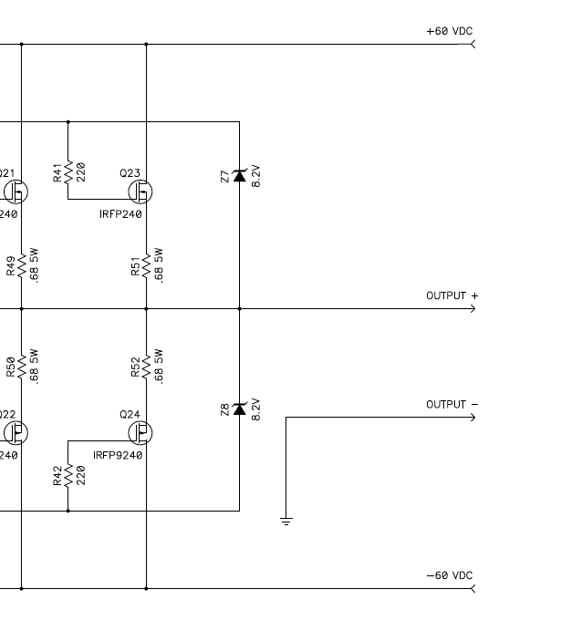

    Would a 5500 or 5800 or 585 work or would it not matter that much vs 555ll
  • SeleniumFalcon
    SeleniumFalcon Posts: 4,402
    In looking at the GFA5500 the schematic shows the negative speaker terminal connected to ground, so it would work. Here is the schematic:

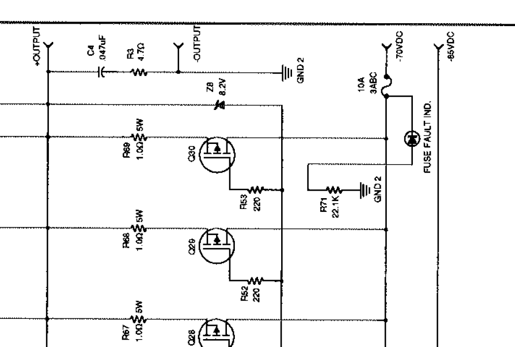

  • SeleniumFalcon
    The GFA5800 looks good also, here is the schematic:
    It's upside down, but you can see the negative speaker output is connected to ground.
