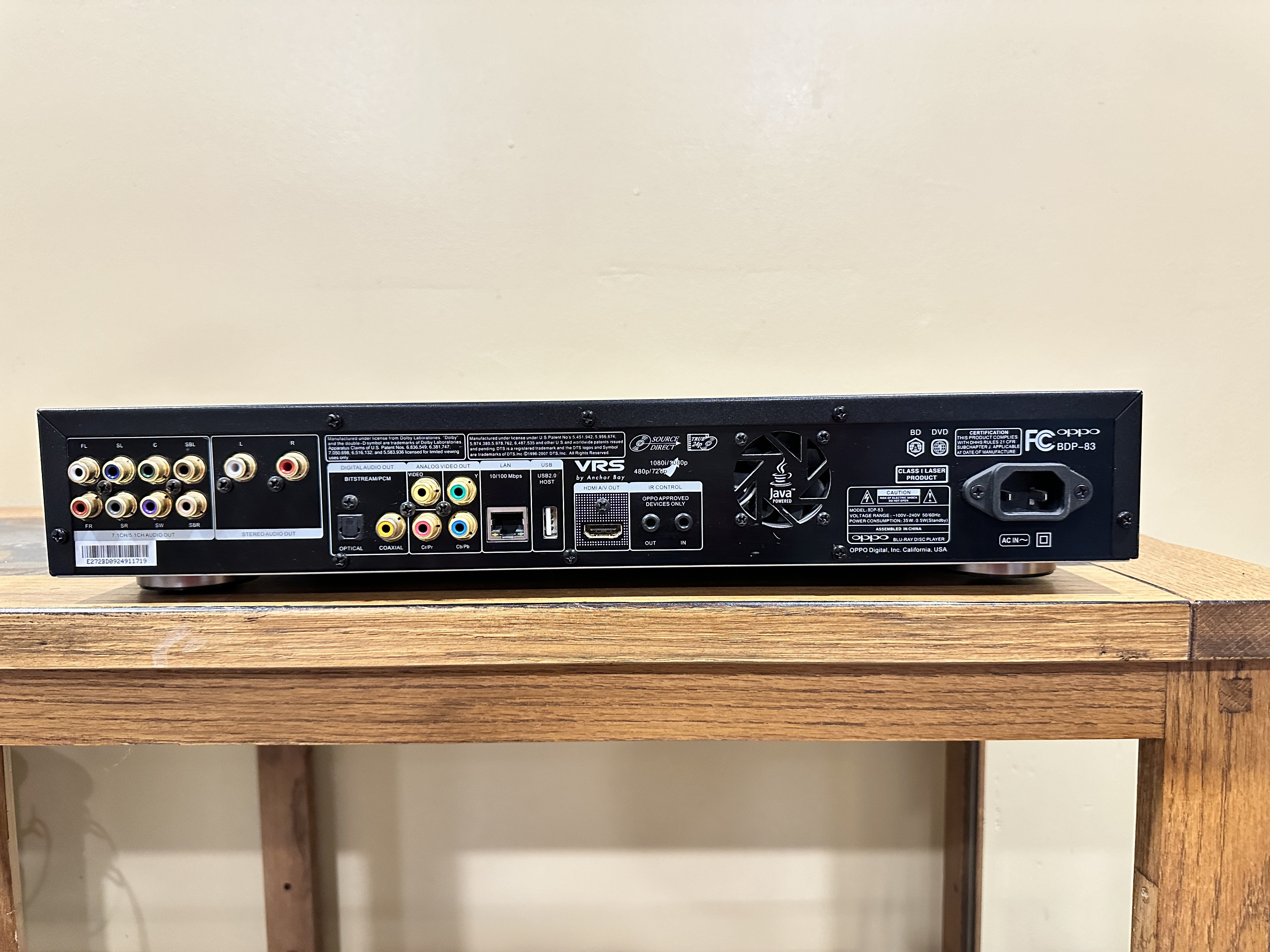

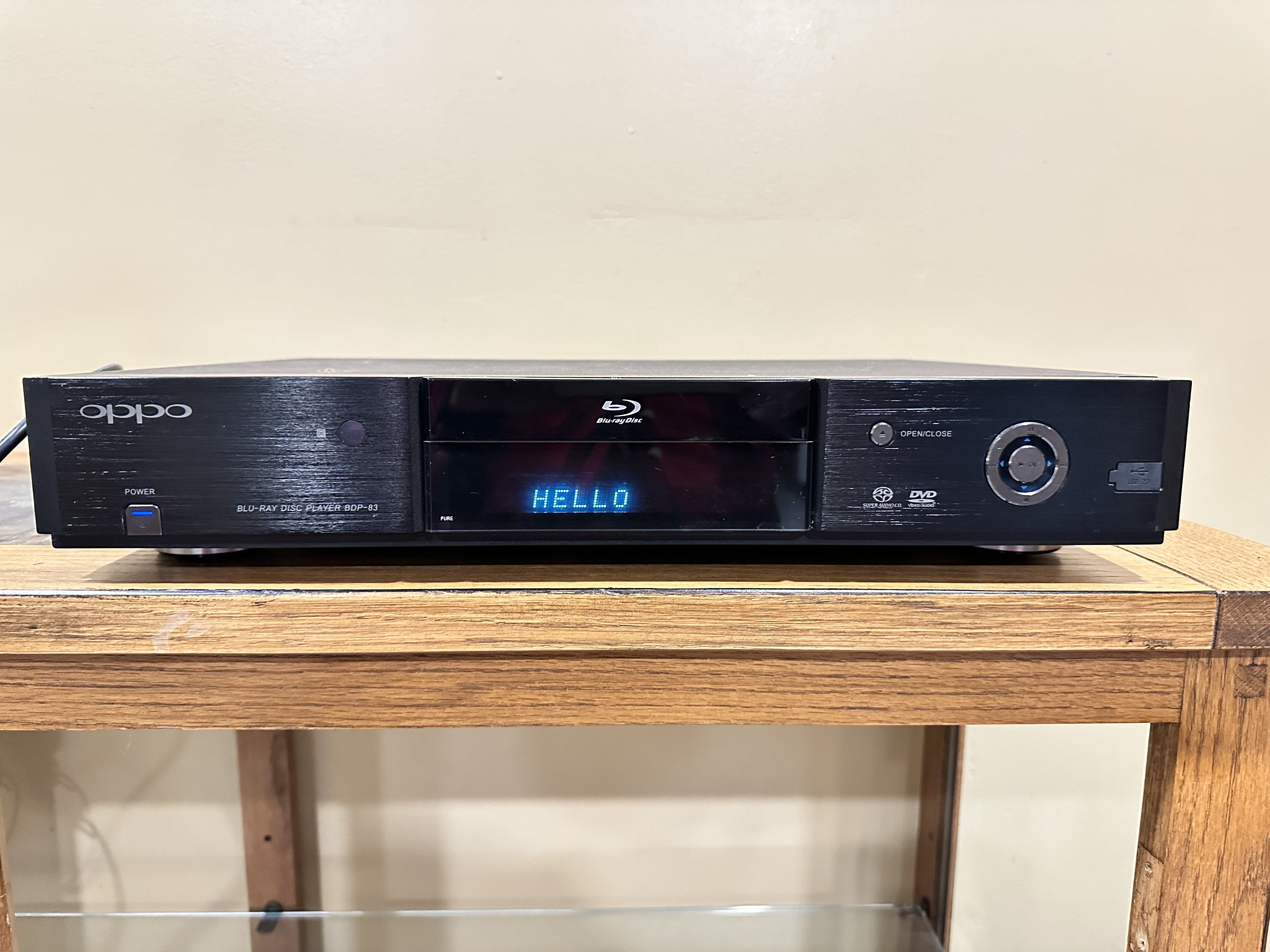

Oppo BDP-83 with All Region Card
Selling my Oppo BDP-83 with all region card and remote.
Asking $200
