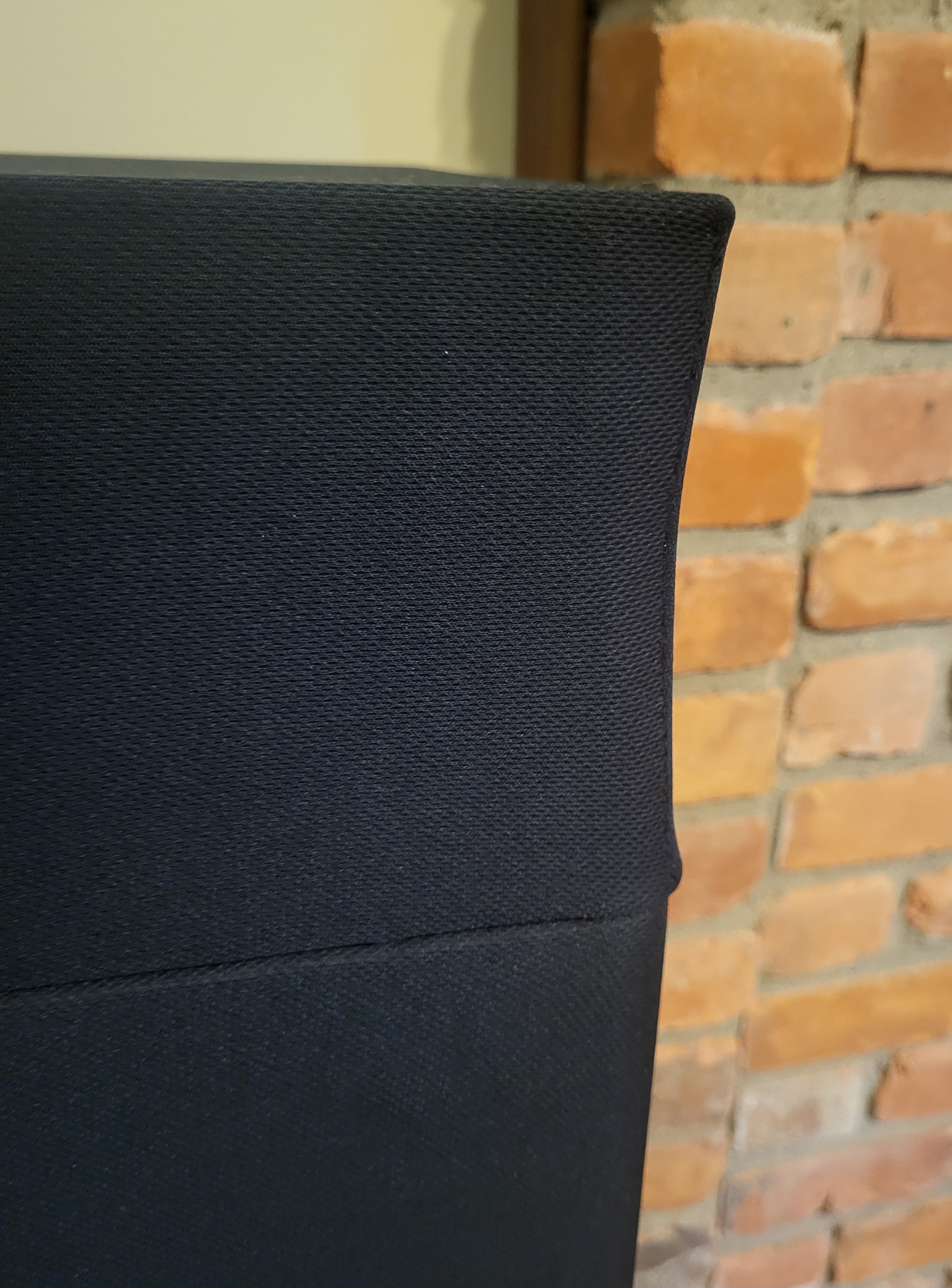

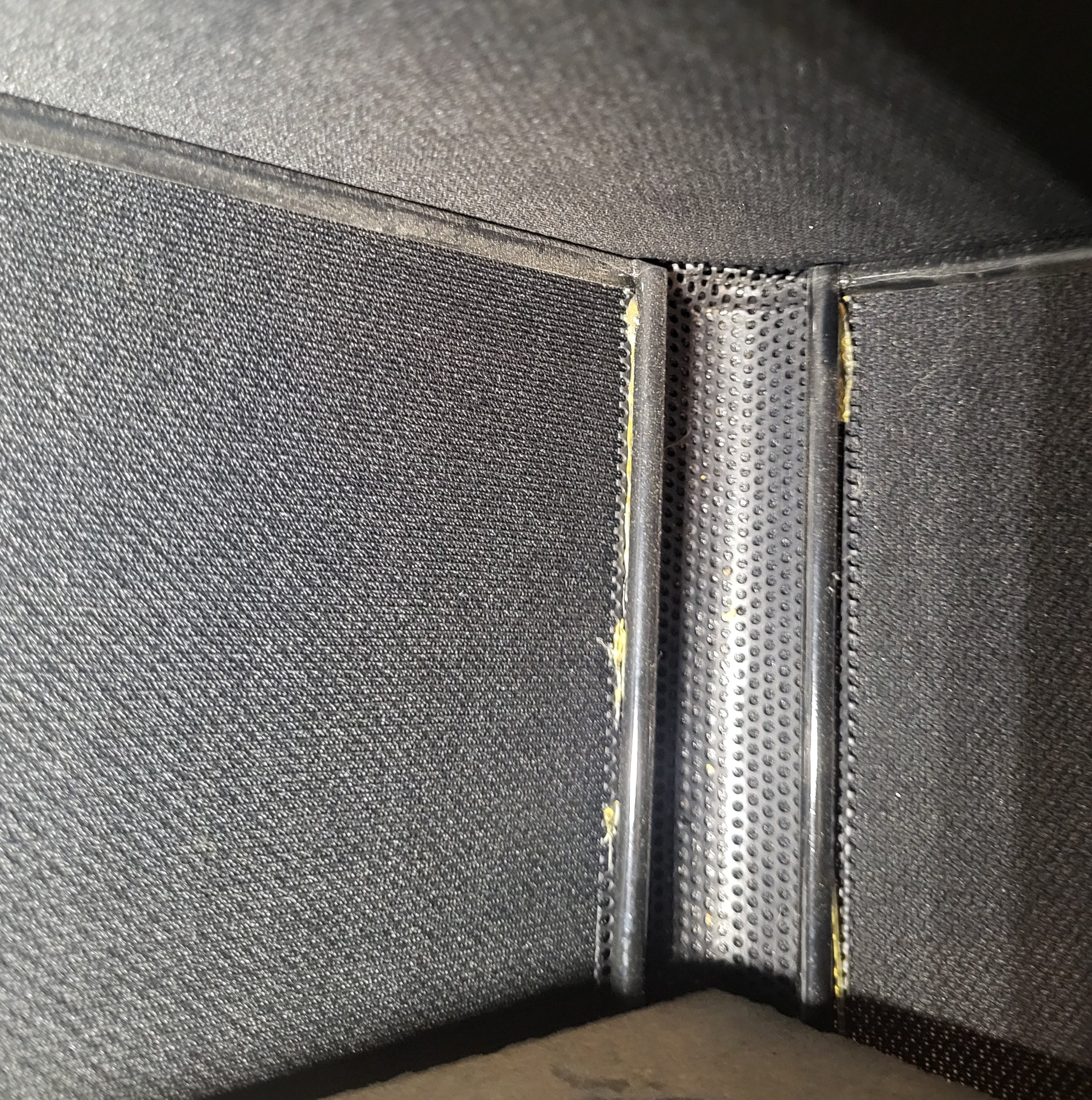

Hi folks. I have a really nice pair of Polk RTA 12's (first version) complete with the "top hats" (tweeter covers). Although the hats are in very good shape, the corners of them are "curving" because the original fabric is pulling tightly on the thin plastic corner pieces. The pictures will probably explain it better. First one shows the curved side of the outside of the hat. Second photo is a view INSIDE the hat showing the plastic corner pieces that are supposed to control the shape of the fabric.
The sides of the hat should be straight and vertical, not shaped like an arc. In my case, the plastic corner pieces have relaxed (flexed) with time. Unfortunately the plastic is also very brittle from age and in some places is starting to crumble/crack. So flexing the plastic back into the correct geometry is not an option. I'm thinking the corner pieces need to be replaced, but with what?
What I'm wondering is how others have addressed this. Is there a hack to re-create the corner reinforcements? Has anyone 3D printed them?

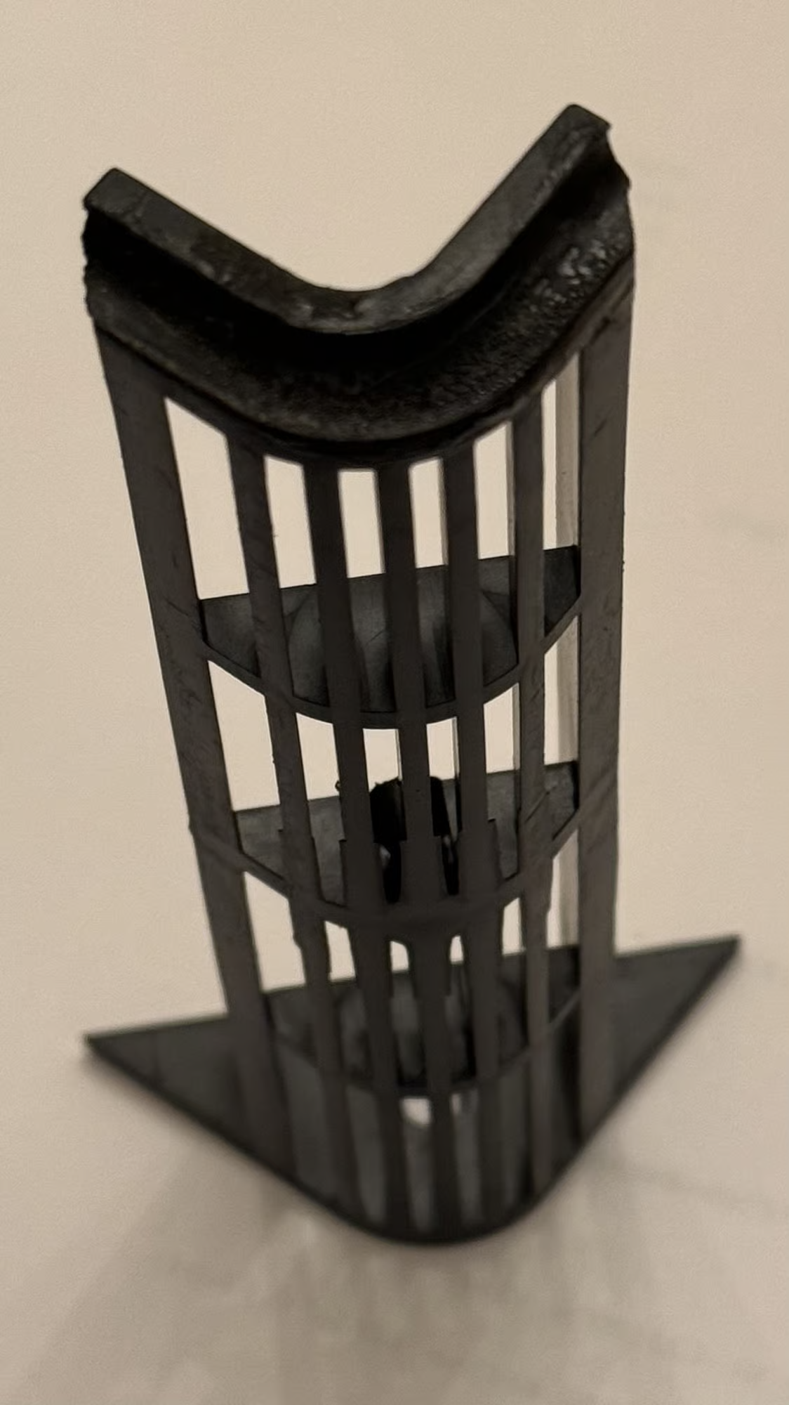

    My top hats have very thick,truss-like supports. They do not flex at all. I believe yours are homemade.
    I'll try to get a picture or 3 for you soon of these original ones. I thought of making some out of wood but have yet to do it.
    I guess mine are like yours...but mine seem sturdy as heck. I'll still go pull one out and look again tomorrow.

    Tony M Posts: 11,924
    I just checked again.
    Yes, mine are just like these;
    https://forum.polkaudio.com/discussion/200401/rta-12-12a-first-version-top-hat-cover-support
    This is very interesting and helpful! Thanks for posting the picture. This is indeed very different from mine. However, I am confident mine are "original" corner pieces (not replacements), as the speakers were purchased from first owner and are extremely minty. Perhaps they are earlier (or later) manufacture than yours? My hat fabric still has original staples holding it to the hat base, so it's clear they have never been disassembled. (And I can't see how the corner pieces could get inserted and glued without disassembly of the hat.) My serial numbers are 12-05490 & 12-05487, and all four MW6500's are dated 3-80. How does this compare to yours? Your version of the corner pieces looks more complex, but sturdier, so I'm guessing it is a later version.

    Part of the problem is the brittleness of the corner pieces. They apparently took a "set" over the years, and if I try to straighten them up, in order to reinforce them from behind, I'm certain they will crack and break.
    Another thing is that my original corners have holes in them, and the other version (as shown by TonyM) has slots. I'm assuming the perforations are to minimize block of the tweeter dispersion. So I've been thinking any fix or replacement would also need to be perforated or slotted.
