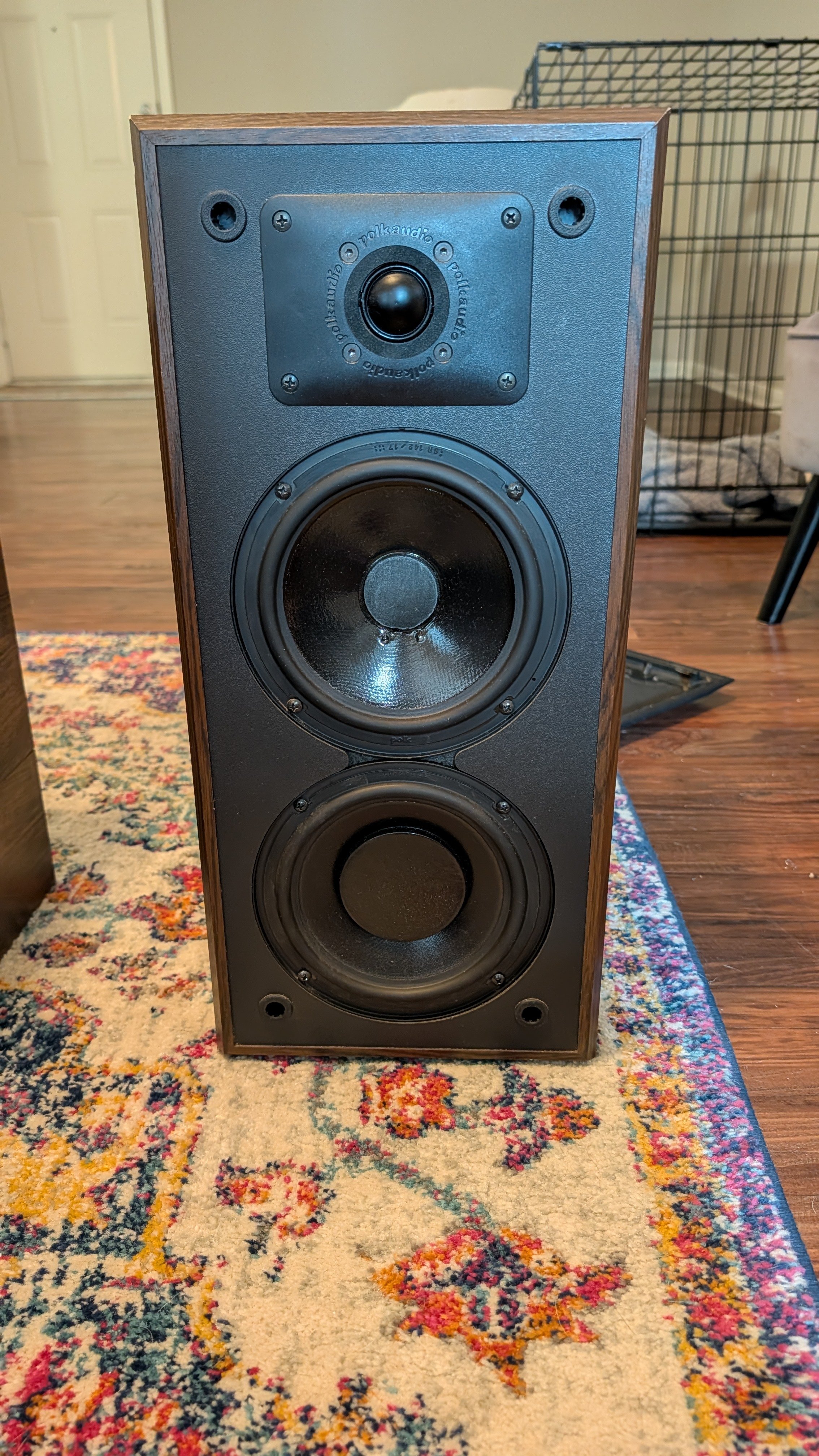

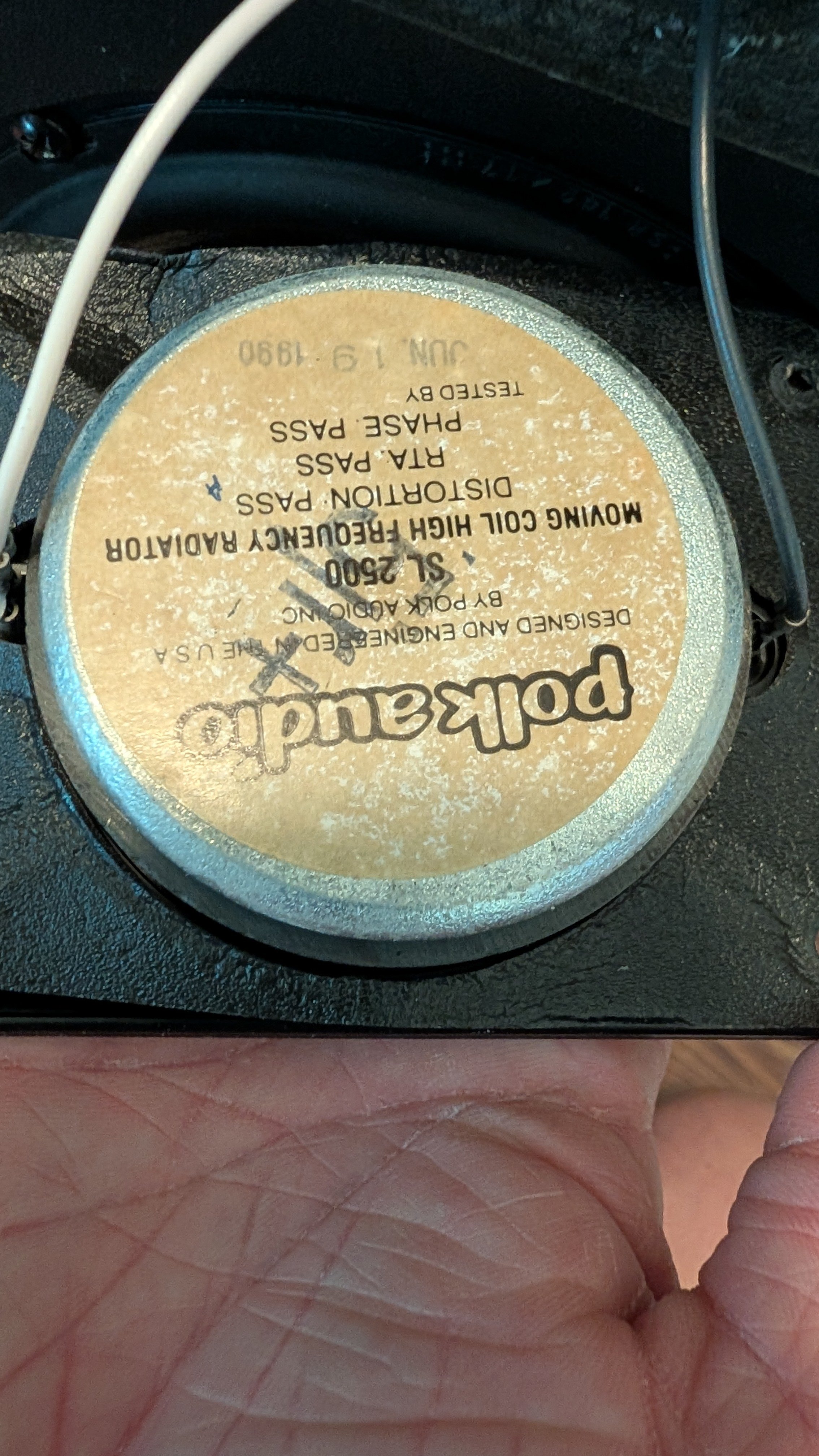

I wanted to build her a nice little system now that she has space and something that would fit with style she loves. Found a set of Polk 5jr+ on Marketplace for $80 and snatched them up. Cosmetically they aren't perfect but my daughter likes that. They have the SL2500 and one of them isn't working (hence the cheaper price).
After using the search feature (so F1Nut doesn't yell at me) I think I have a good game plan to getting these things sounding amazing again but want to make sure that what I'm thinking is correct.

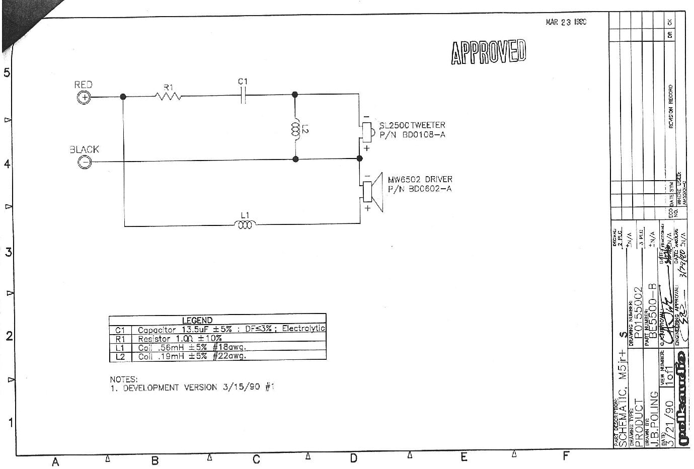

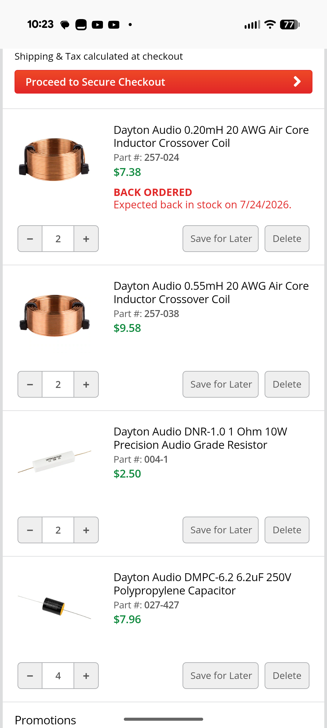

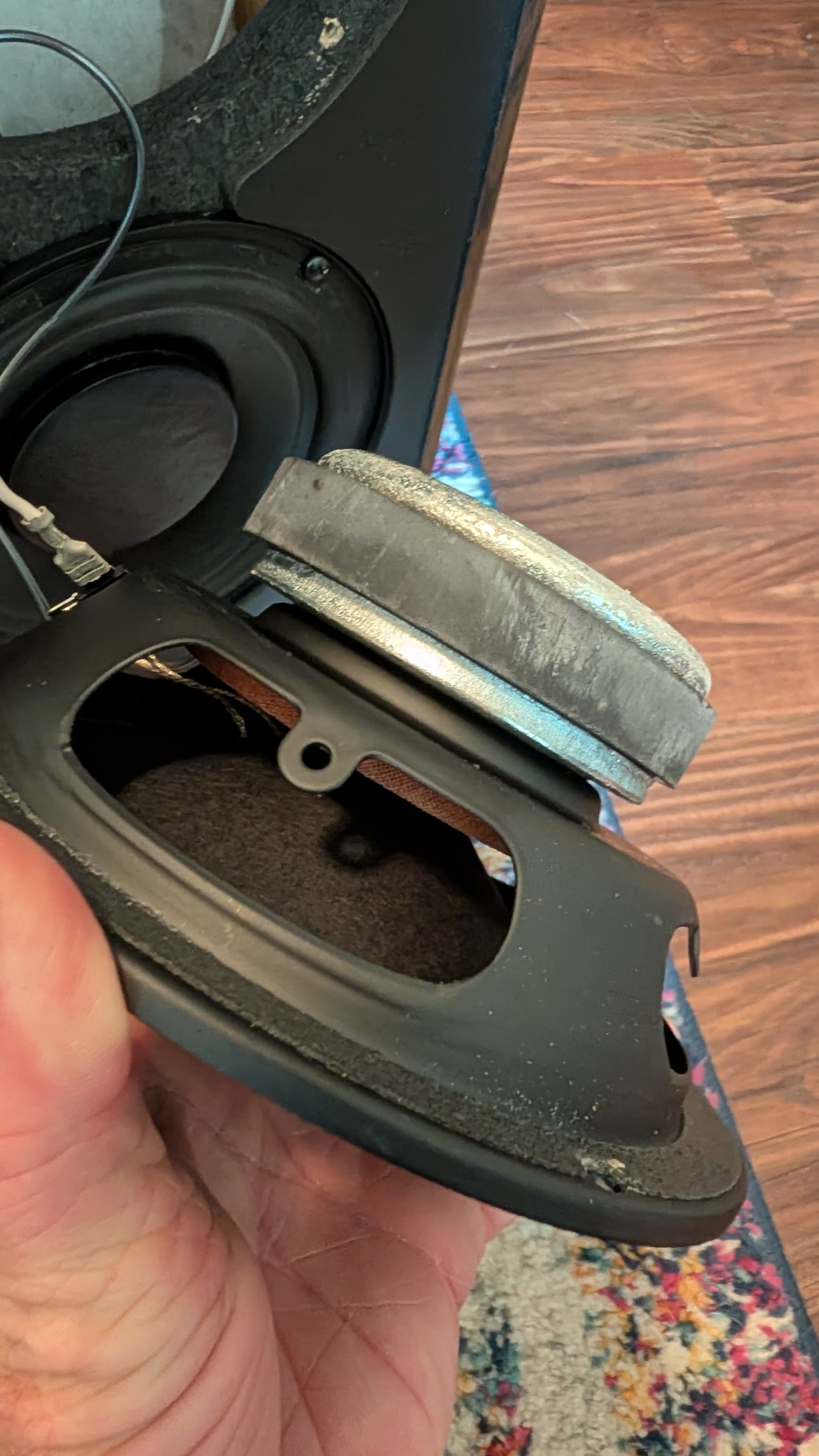

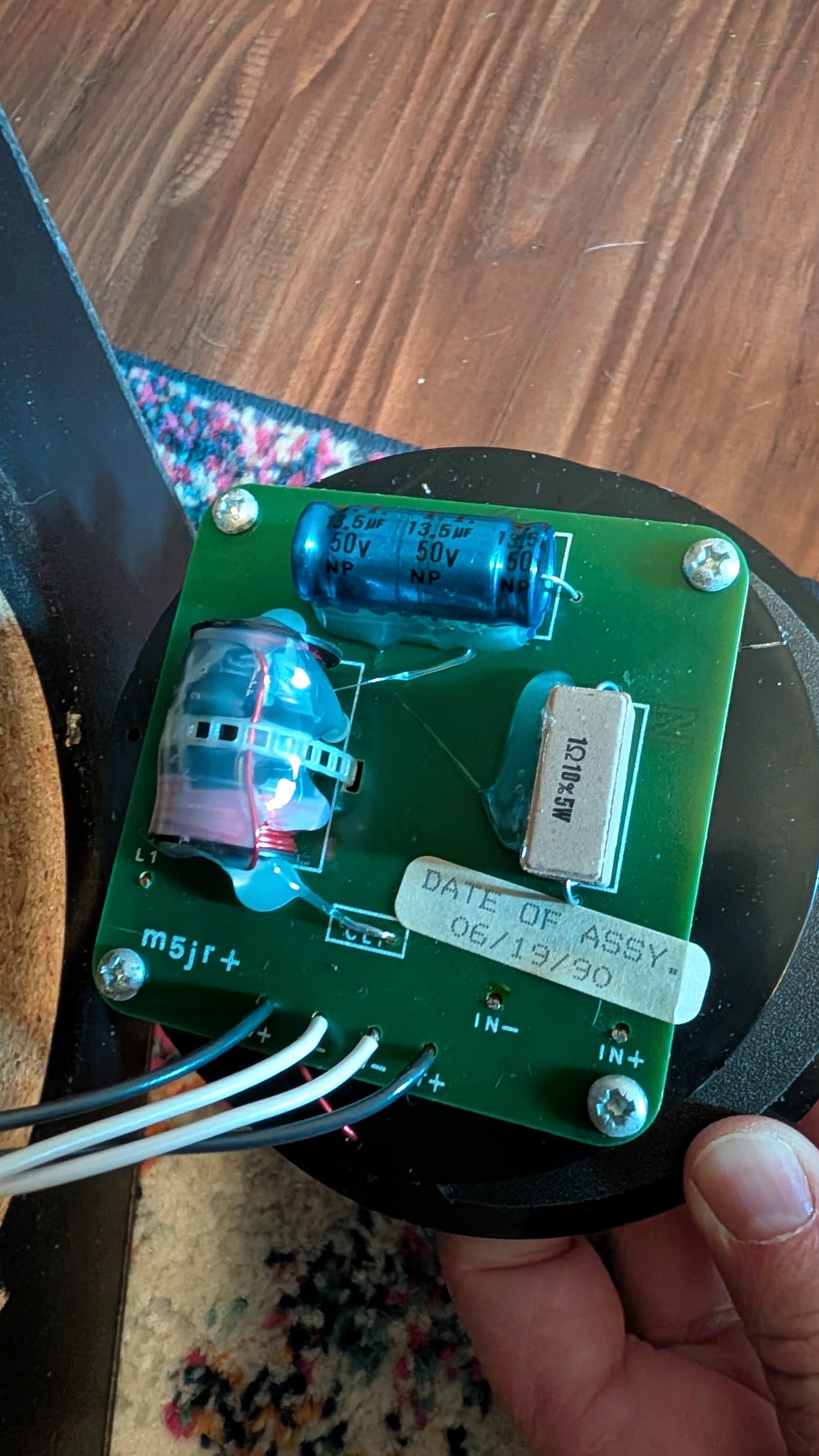

With one tweeter bad, I was going to replace both SL2500's with RD0-198's from The Speaker Exchange. I will be getting JB Weld to ensure neither magnet shifts. I will also be dynamatting both the woofer and radiator on both speakers. Finally I am going to completely rebuild the crossovers with new inductors, resistors and caps. I have attached pictures of one of the speakers and all the components inside. I also have a screenshot of my cart from Part's Express after looking at the schematics posted on here and trying to find comparable components.

Dayton caps are the same as Bennic and should be avoided, period. Better choices would be Clarity CSA or Sonicap.

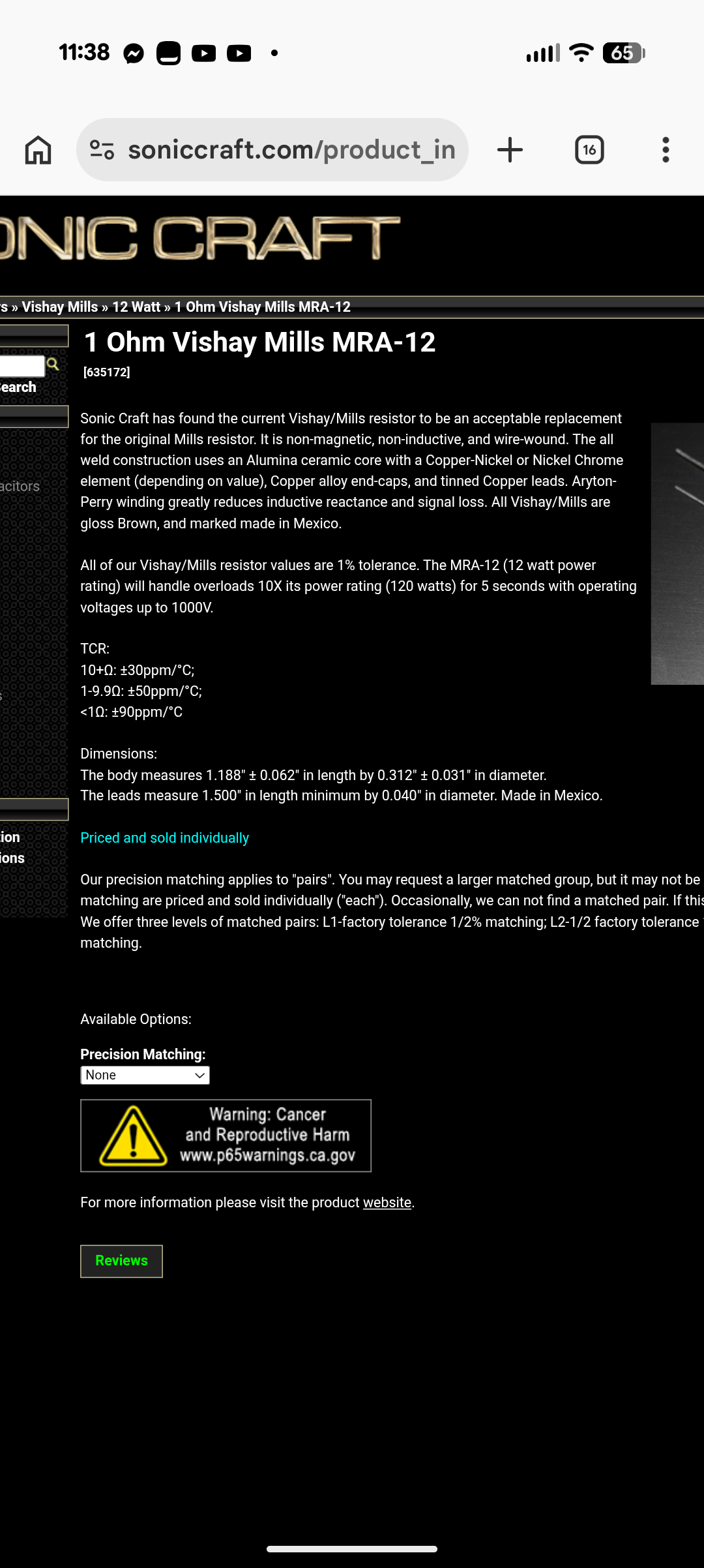

The Dayton resistor is no better than what you have already. Use Vishay-Mills instead. -

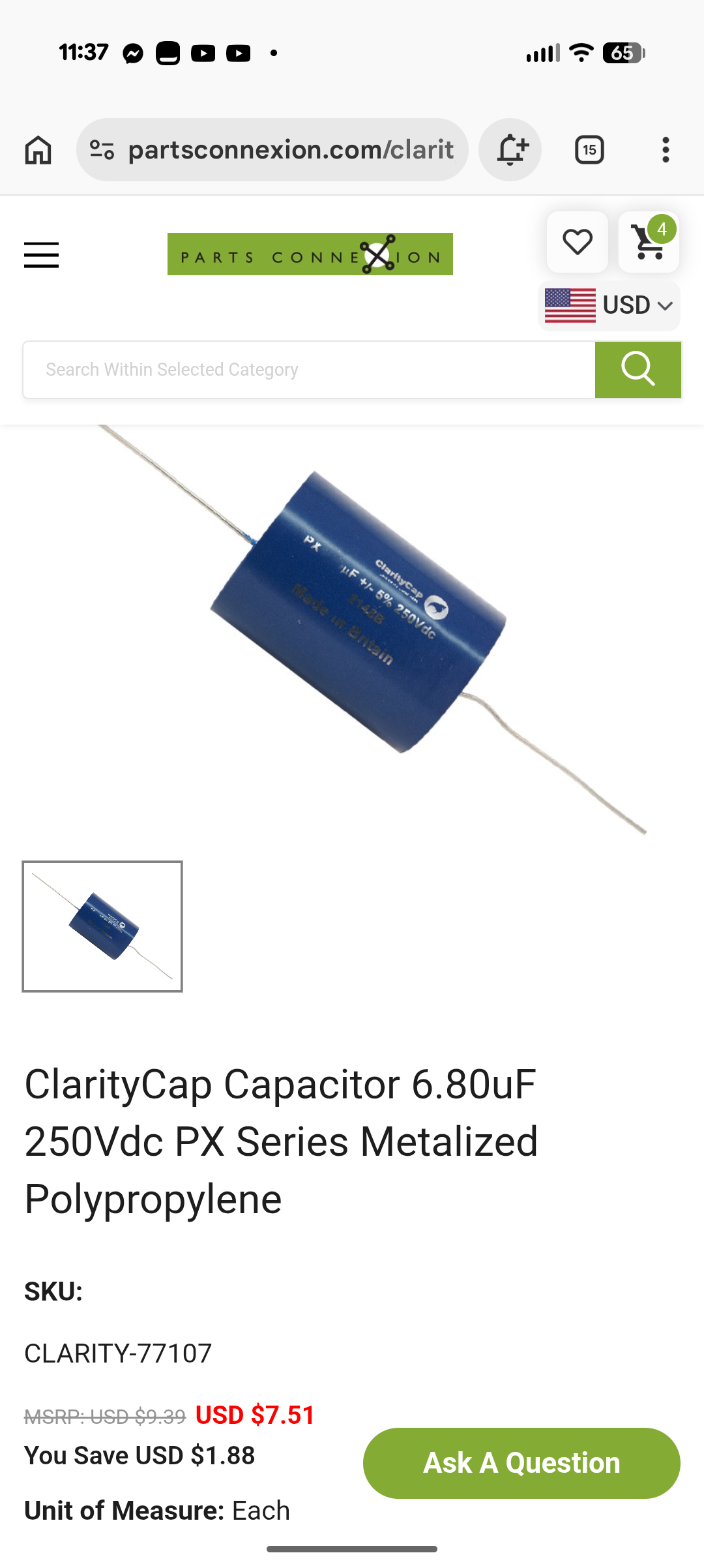

Gotcha. So better bet will be to run these.
Are the inductors fine? Or is there any reason I can't just de-solder them from the original boards and reuse them? -
Not sure I'd go with those inductors, since the AWG's are off, which could throw off the DCR. Unless you can measure the DCR of what you have really accurately of course and those match.

not2ndstorer wrote: »Gotcha. So better bet will be to run these.
The CSA is a better choice, but the PX is way better than the Dayton. Resistor choice is good.
No reason you cannot reuse the original inductors and as stated, the ones you picked are not an exact match.
BTW, you can buy the tweeters directly from Polk. -

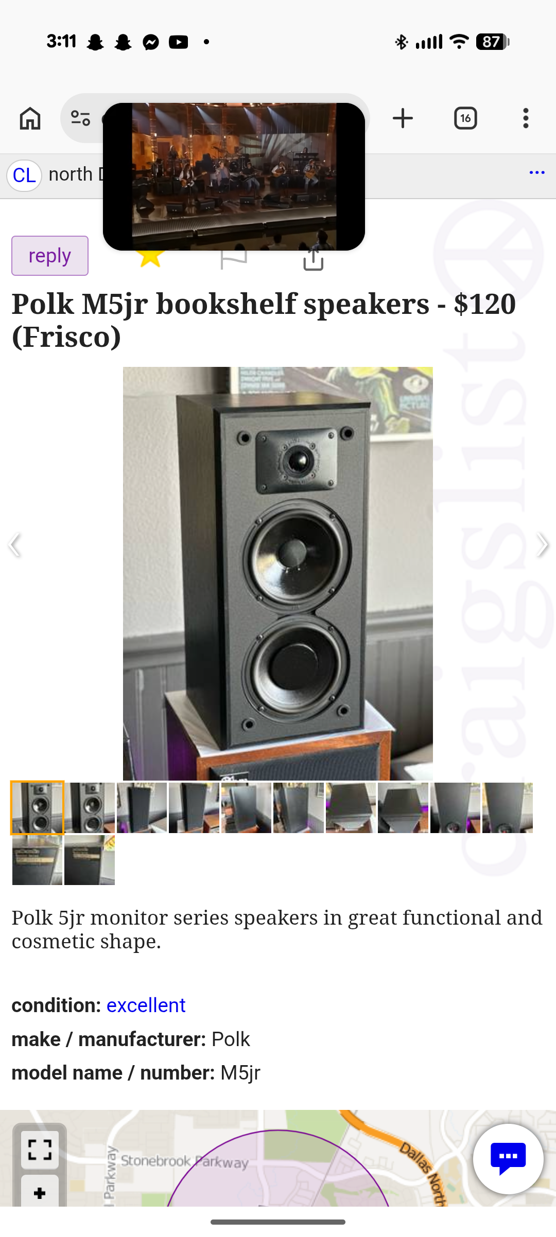

While going down the rabbit hole of wanting all the vintage Polk speakers, I decided to look through Craigslist on a whim. Well, saw this ad..
Messaged the guy and offered him $80 cash. And now I have a beautiful set of black Polk 5jr+ speakers that sound amazing. I'll end up doing the full upgrade on these and will get my daughter's just fully working. And start buying parts here and there to make improvements.
@F1nut Thanks for the heads up on being able to just order a replacement SL2500 through Polk! Talked to a very nice dude that verified they had the part and even got me a discount because I'm on the Polk Forums.
