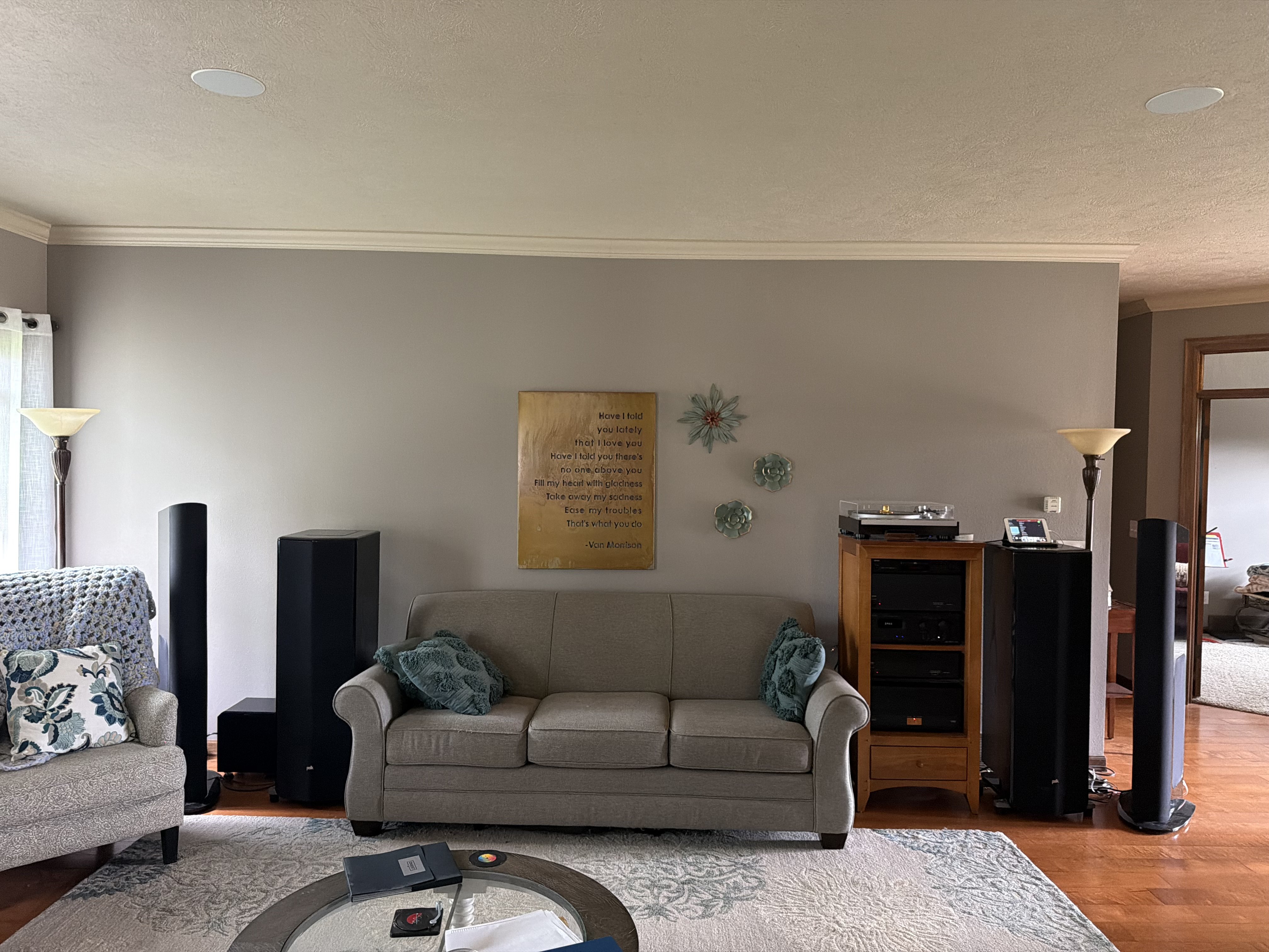

    As difficult as those L800s can be to place for optimum sound quality, that couch and that chair have the potential to wreak havoc. Is this how you plan to have them set up permanently?

    Not necessarily the permanent setup, but not a lot of options

    I could move one speaker to the other side of the stereo rack but not a lot of options
