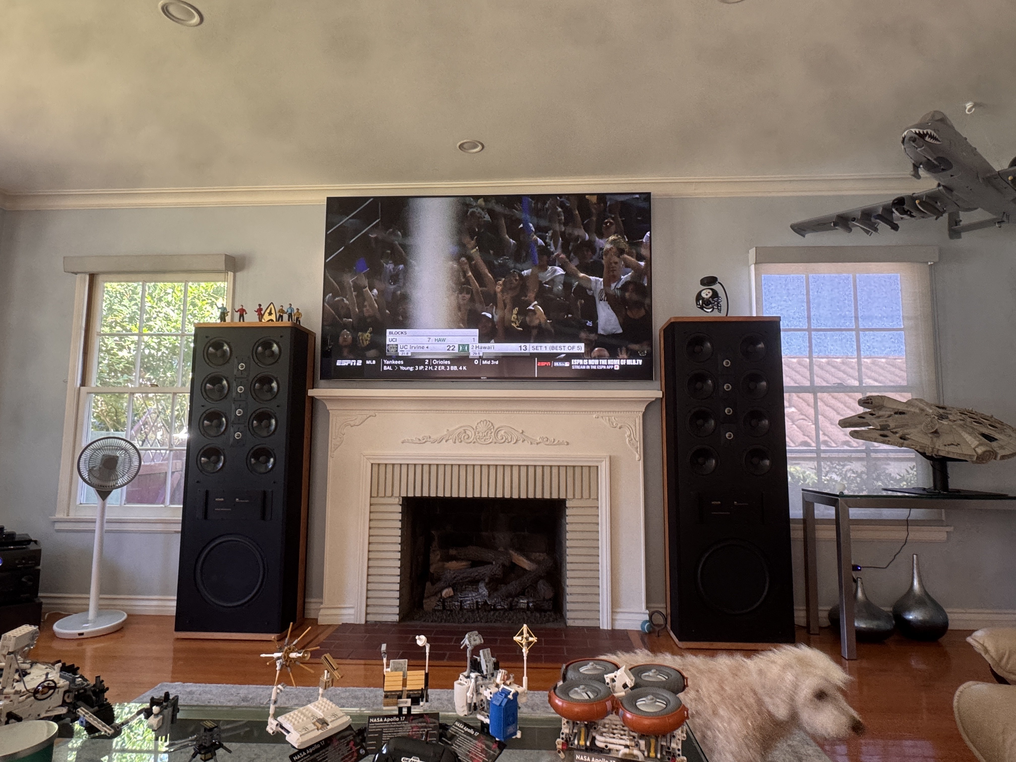

Perfect mechanical condition. They are used daily in home theater, music, etc. There are three choice from Crossover Chef in eBay:
Option 1 $500
Option 2: $710
Option 3: $550
My speakers are in perfect mechanical condition but all original components on the crossovers. Powered by a sufficient amp. LOL.
Thanks.

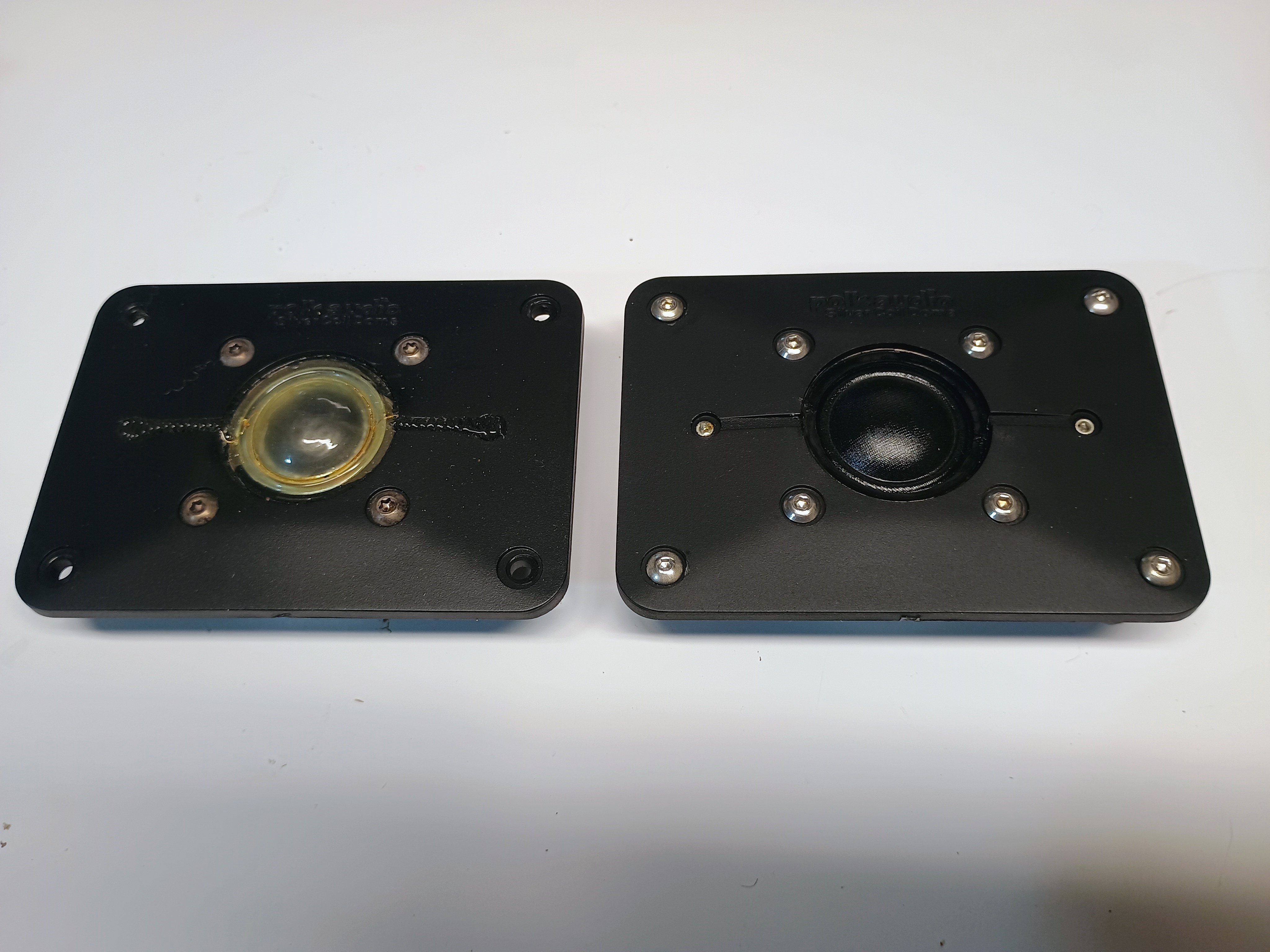

    Any crossover upgrades you do will be wasted unless you get rid of those nasty SL2000 tweeters. Call Polk and order eight RD0194-1. That's a zero not an O.

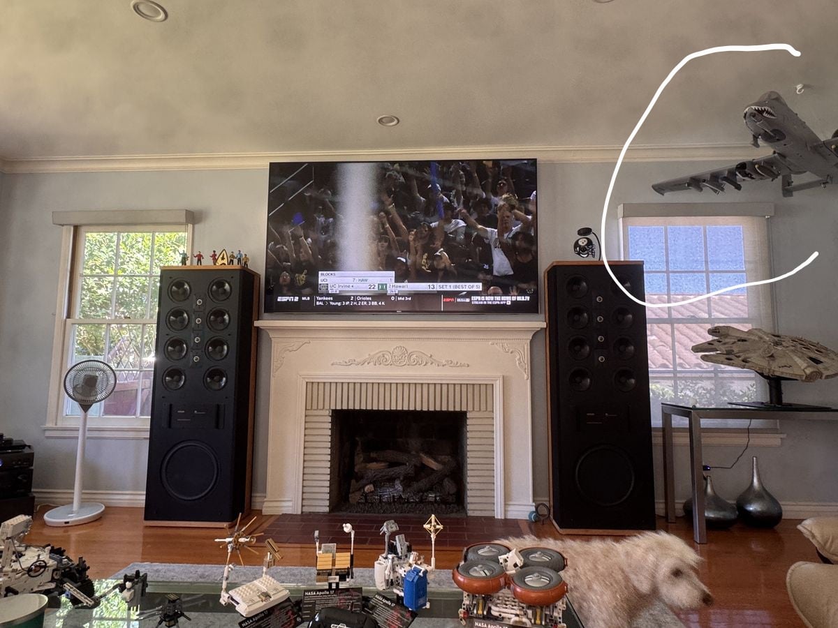

    Didn't notice at first, nice Warthog.
    Viking64 Posts: 7,771
    Jesse, I believe that's a dog. B)

    Warthog
    Please tell me you didn't think I was serious. :p
  • AllOuttaBubbleGum
    Thanks all. Been away from the interweb for several days. Thanks, one of my boys flys hobby aircraft and he talked me into learning to fly. I saw the Warthog at a garage sale, ready to fly and couldn’t pass it up. But until I get a lot better it’s gonna stay hanging there, lol. I have already crashed more than a few foam Alaskan bush planes. I found it’s a lot harder learning new things when you are older lol.

    I would love to upgrade the tweeters but will it really make a huge difference? I’m ok with how they sound now. That $3k is more than I paid for the speakers! I am hoping fresh caps and doing other crossover mods as mentioned in these forums will really clean these up and bring out the potential.
    Is there a more cost effective alternative to the RD tweeters? Maybe sourcing them used?

    Seems to be some confusion. The RD0194-1 tweeters are $60.00 each, so $480.00 for a complete set.
    Are they a huge upgrade? YES!!!

    I was okay with how my SL3000 tweeters sounded in my SDA-SRS 2.3tl's as well. The RD-0198-1 after about 70hrs of run in time they definitely opened my eyes to how much better it could get. I know that the RD-0194-1 replacement for the SL2000 should be a large improvement. The dome material didn't age well and the frequency bump itself was fatiguing to most.

    Thanks all. Yes, my math was a bit off. $480 is much more palatable. I don’t know where I got that number. I think I will do it along with the crossover refreshes and report back!
