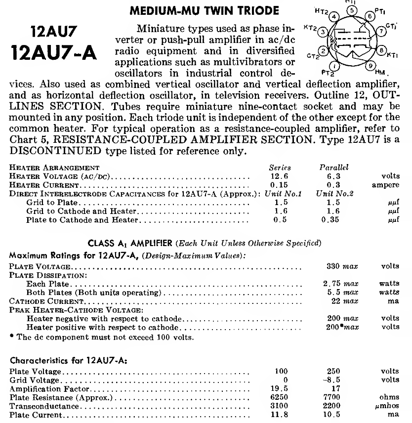

    6SL7 tubes are the octal version of the 12AU7 electrically. They are a bit less pricey than their cousin the 6SN7. I have an amp that runs 6SL7's and 6V6 power tubes. The best ones are still pricey if you're looking to go old stock, which you should.

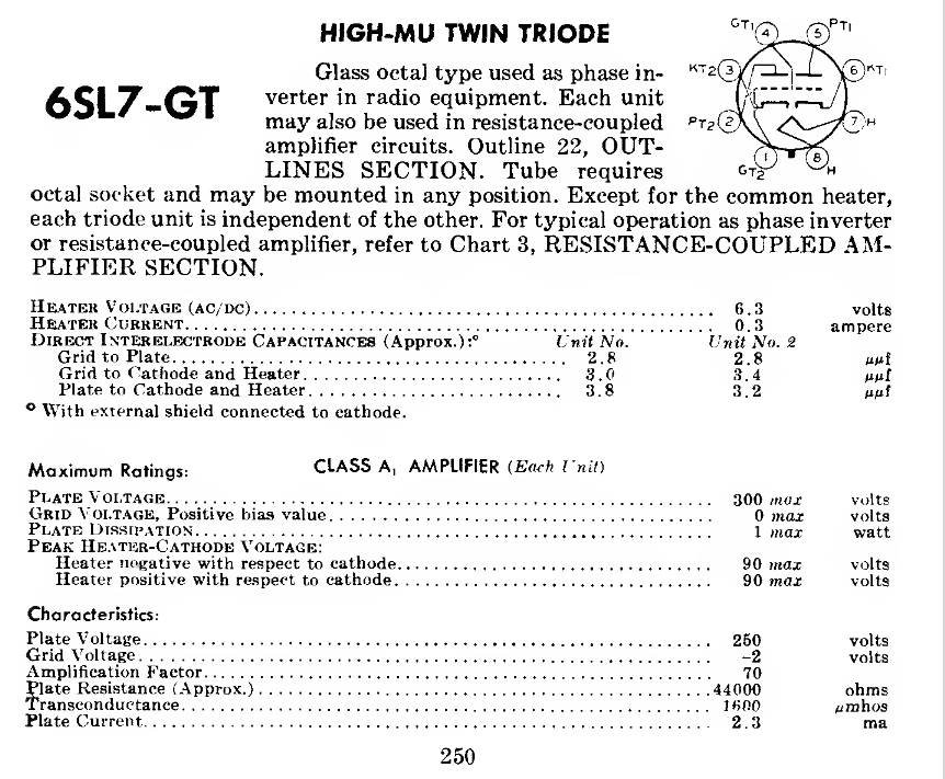

    mu of a 6SL7 is quite a bit higher than the 12AU7.
    both screenshots from RCA RC-20:
    https://www.worldradiohistory.com/BOOKSHELF-ARH/Technology/RCA-Books/RCA-Receiving-Tube-Manual-1960-RC-20.pdf
    The 6SL7's also not a 12AX7 in an octal package, but it's close(r) and can be used for high gain requirements (e.g., a phono preamp or tape head amp).
    https://vinylsavor.blogspot.com/2016/05/tube-of-month-6sl7.html
    My Joseph Esmilla-designed "Simple 2A3" amp was designed to use the 6SL7 in the voltage amplifier section (which, admittedly, is neither here nor there). The 6SL7 is a fine dual triode and doesn't have quite the cachet of the (lower-mu) 6SN7, which has helped to keep the prices of the former down. :)

    The 12au7 is closer to the 6sn7. Some differences sure, mu is closer though.

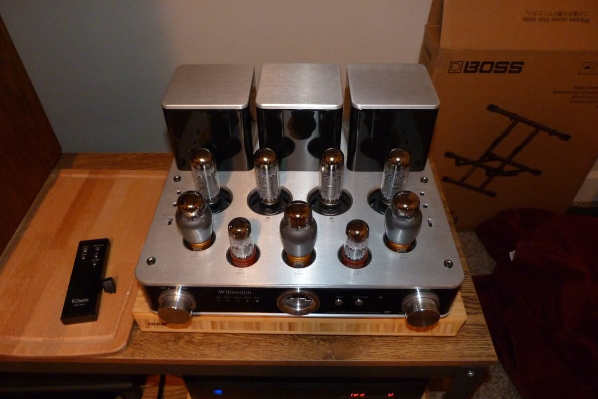

    By popular request, some actual pics in my rig.
