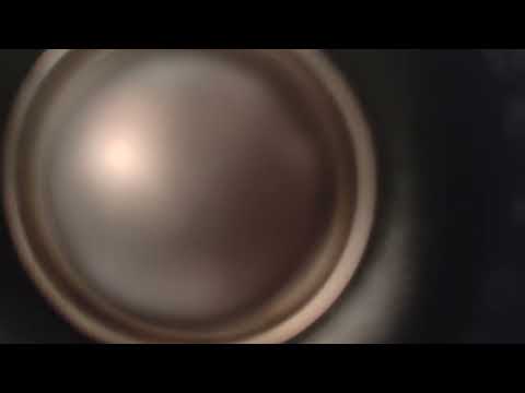

Hey Guys,
Just grabbed a pair of polk rt800s for a good price as a gift for my dad but when I got home and played a bass rich song I noticed a sort of resonant or vibrational sound from the tweeter. I have a video https://youtu.be/edGANbRhuiM
I'm a novice in the world of speakers but I'm happy to tinker with this.
My first question is whether this is pointing towards a broken tweeter or is there any hope of another situation i.e. loose connection?
Secondly, if tweeter replacement is the best recourse does anyone have advice for a budget replacement? This was part of an overall hifi system so budget is somewhat paramount. As I understand sl6502 is what I should be looking for and those are going for the price of the speaker haha.

    Bass frequencies cannot be produced by a tweeter due to the crossover design blocking those frequencies.
  • mrandall504
    That I understand, so if this "rattle" is present near the tweeter would it suggest an internal component has failed?
    xschop Posts: 5,747
    Those tweeter top plates are prone to breaking off at the plastic faceplates. You may be able to remove and glue back together.
    F1nut Posts: 52,305
    Hard to say. Honestly, I can't see or hear an issue in your video.
    Xschop's suggestion is worth pursuing.
