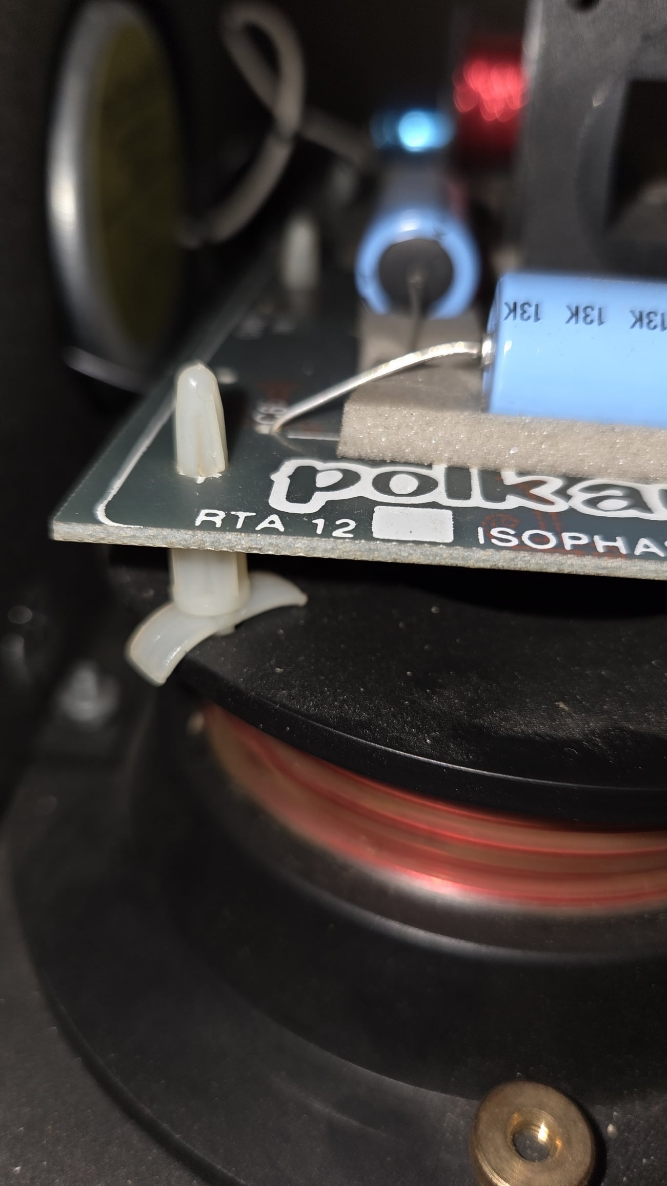

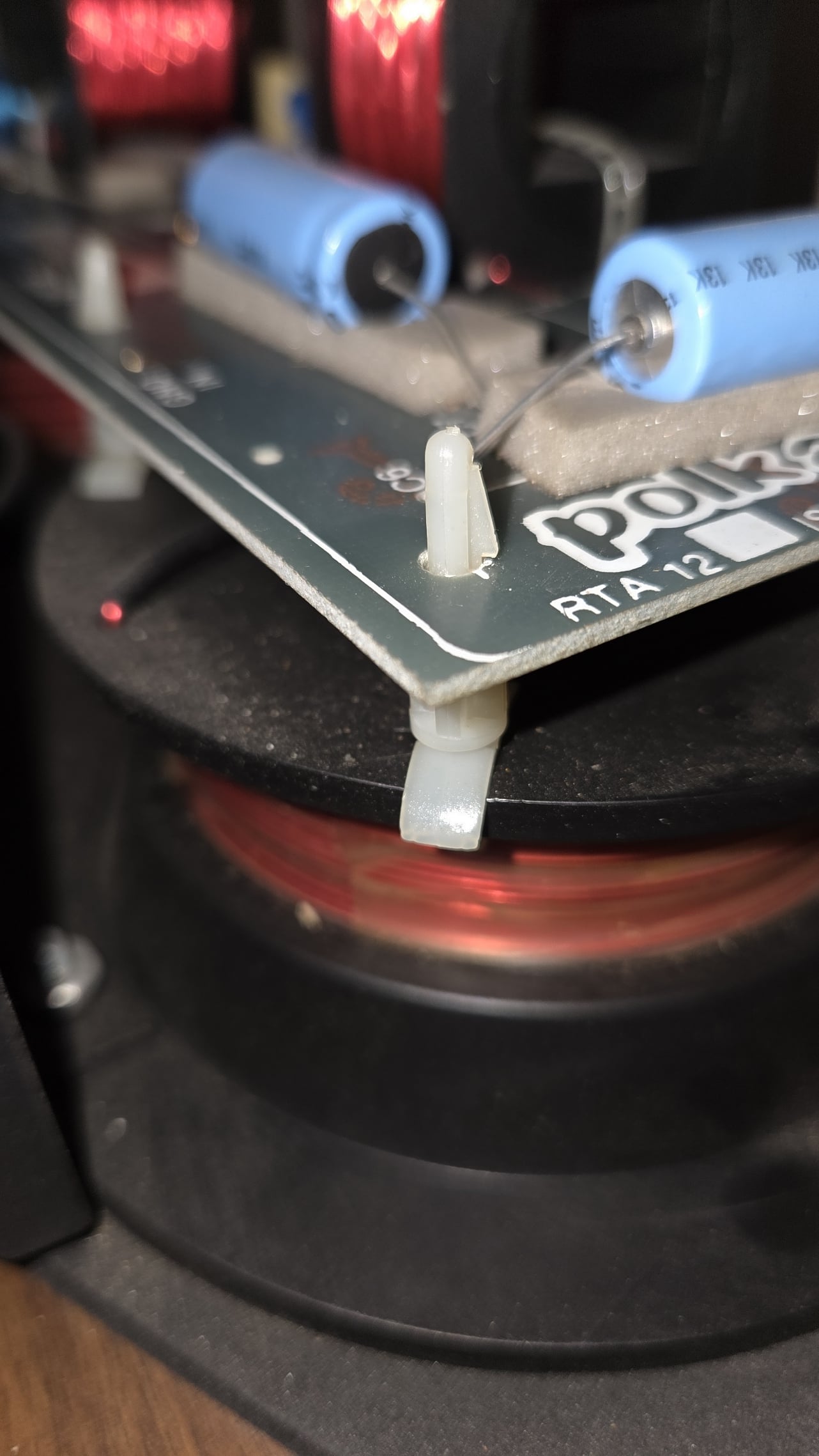

how does one release this? am i missing something? when i press the little wedge inwards and lift up on the crossover board , it wont budge. is there a certain side i start on or something maybe?

    Nope, squeeze that little tab inwards and they come off. You may need to use some little needle nosed pliers and wiggle a bit but you are on the right track.
